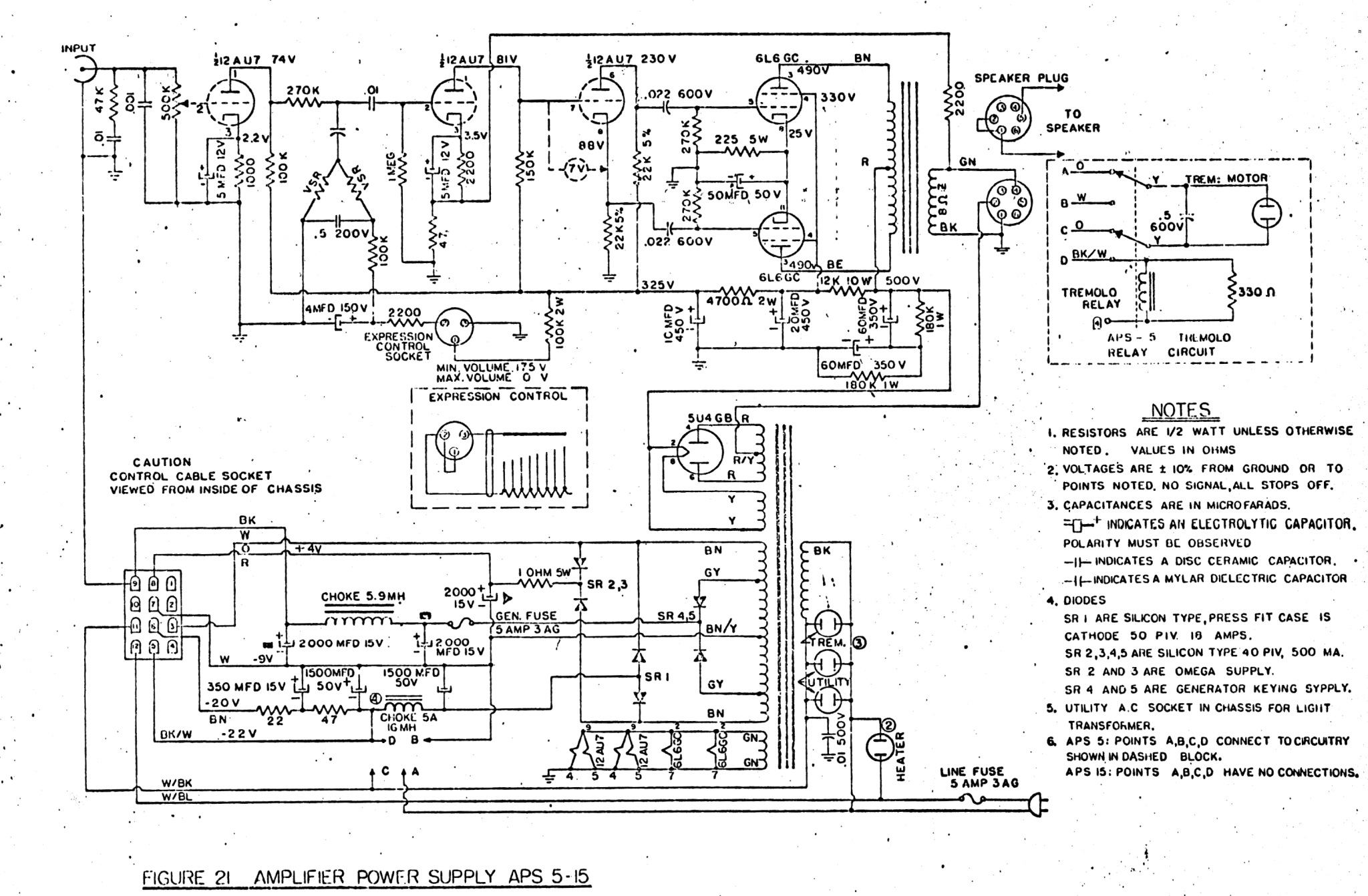

Gulbransen APS-5 power amp - ground-up rebuild
Subject amp was brought for next to nothing and it was gutted. All that was left was the chassis, the transformers, the tube sockets, and the heater wiring. I replaced the sockets and the heater wiring and I tried not-so-successfully to nickel-plate the bell ends of the transformers. From what I've been able to tell the amp was made circa 1960 and was part of a transistor-based organ (part of what was in this chassis was the power supply for the organ electronics; all of that's gone and the associated PT secondaries are blocked off and wrapped up).
Obligatory gut shot:
The schematic shows one component change (unobtainum; substituted 250 ohm 5W for 225 5W) and I've crossed off sections that were omitted. I crossed off the input/V1 stage because I changed enough to just redraw it; both are below:
I simplified how that first segment of coax is drawn; the actual layout doesn't look like that. Rather, ground "emanates" (if you will) from the end of the preamp-side ground busbar to the low leg of the volume pot and is carried via coax shields from there towards both the input jack shield contact and toward the V1 grid(s) but note that the segment of coax from the volume pot to V1 is grounded only at the pot end - this was a late addition to address some audio-range feedback that was creeping in. Both input and speaker jacks are isolated from the chassis. The big changes in the front end are the paralleling of the two V1 triodes instead of leaving one unused, the values of V1's cathode resistor and bypass cap (I had intended to use a 10uF but didn't have one on hand), and the value of the V1 plate resistor (started with 56K; wound up with 47K). I tested putting a 4.7K resistor in front of the V1 grid(s) to reduce how much the function generator input signal was getting dragged down when the volume pot was turned up but it didn't seem to help much at all so I removed it.

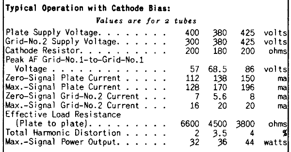

A 6L6GC push pull pair: Class A output much much less than 50 Watts
A 6L6GC push pull pair, Class AB output might have 50 Watts, but it might be a struggle, or have low tube life (keep a small fire extinguisher near).
The 6L6GC is the most power capable of all the 6L6 tubes.
Start with 50 Watts Class AB, from a push pull pair of tubes going to the output transformer primary.
Use a less expensive output transformer that has primary DCR and secondary DCR, each causing 0.5dB loss, that totals 1 dB loss.
50 Watts - 1dB = 50 x 0.79 = 39.7 watts.

The 270k between the first and second stages might cut highs and serves no useful purpose (probably there as part of the expression circuit which you've removed). The coupling capacitors (0.01uF and 0.022 uF) and the cathode bypass capacitors are small and will cut bass when you add up the combined effect.
For power output, is the B+ sagging at high output? Datasheet for 55W class AB1 PP (less losses as mentioned by 6A3sUMMER) is 450 plate and 400V screen into a 5.6k transformer. You have 465V plate and 330V screen into an unknown load, and those voltages may be dropping a lot under load.

Here's the original schematic just to save folks from scrolling around:

  • I've unwired the second triode in V1 and reverted the entire preamp to stock except I've removed the 270K resistor between V1 and V2A.

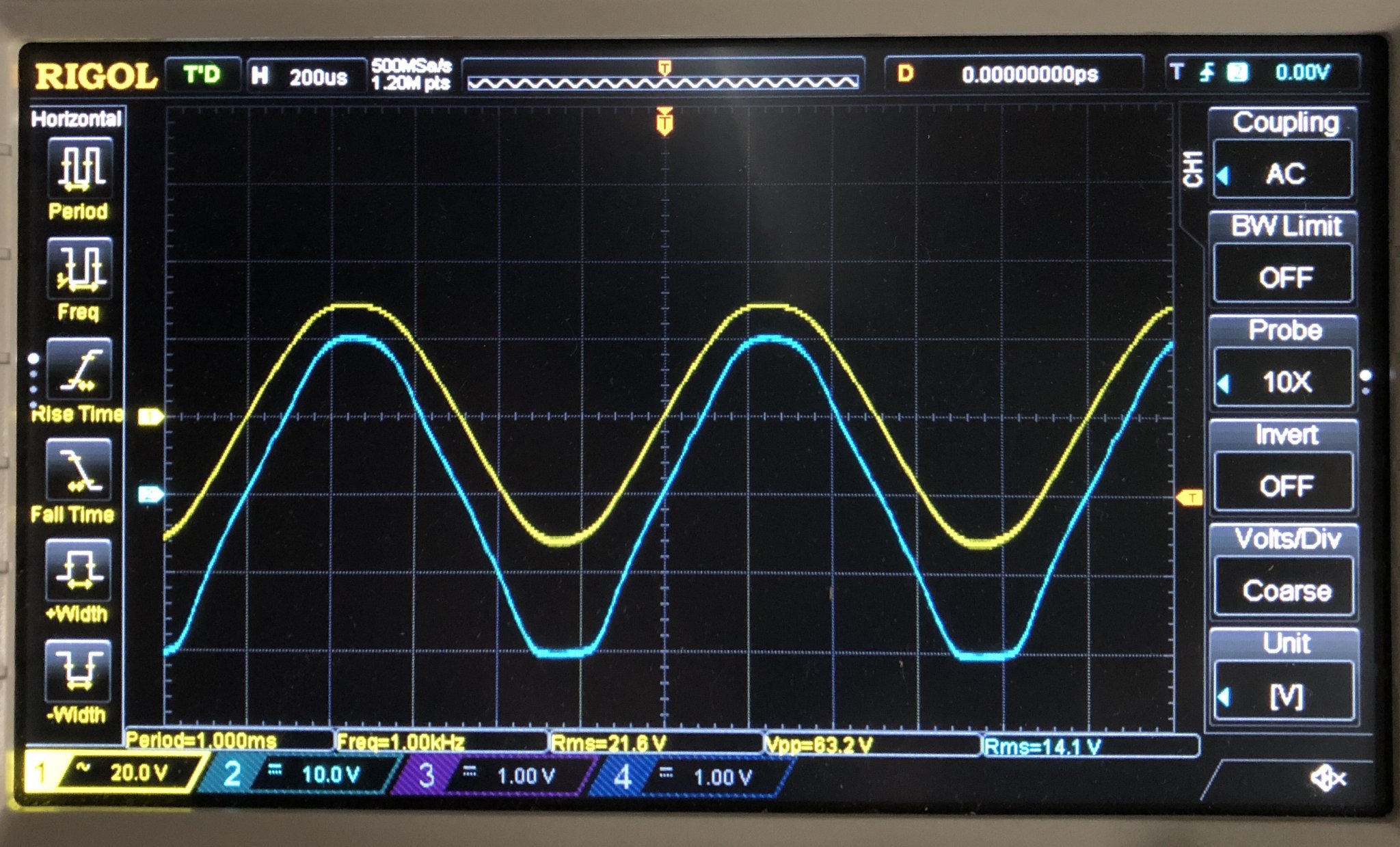

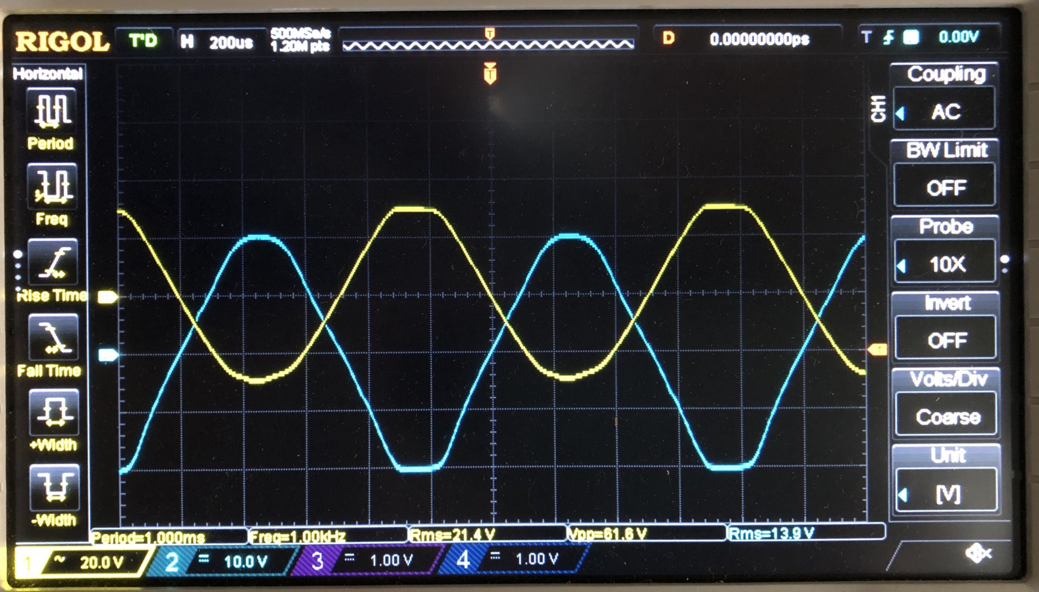

Here are some scope shots with the amp pushed into mild distortion: Teal is across the dummy load; yellow is ground to 6L6 grid (AC coupled; probe switch set to 10X with 10X set at the scope so the measurements are actual). First, the upper 6L6:
And now the lower 6V6:
I'm given to understand this is the normal way a cathodyne bias arrangement should act.
I'm getting to be at my wits' end as to why 18.9W is the best this amp can do. What's left other than to suspect the output transformer - as in, either it's defective or it's actually wound to give this result? My understanding is that this amp came from an organ with a single speaker of perhaps 12" mounted face-down above a Leslie-like rotating baffle. 19 watts full-tilt would have been pretty damn loud; 40+ would have been nuts city especially when considering the idea of jamming that much power into a single circa-1960 speaker.
