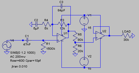

And for the guitar preamp, i had to design a little myself (see attachment).
Now, CRITICS and SUGGESTIONS are greatly APPRECIATED, since i used textbook approach for guitar preamp without audio experience.

I have used that Mic preamp design before and it sounds pretty good but I think you can do better and with less Parts, I would suggest looking at the INA217/THAT1510 Mic preamp IC"s...they are very low noise and can be implemented in a simular way to a regular opamp and the data sheets have curcuit examples Pluss designing a PCB for the mic preamp would be a lot easier than the one you are looking at....
As for the Guitar preamp curcuit I can see a few potential problems....
First you should have the input impedance set to about 1m ohm not 1k5, Guitar pickups are high impedance, so I would switch the 1k5 resistor for a 1m resistor this will also set the frequency of the input filter to somewere arround 20hz...
Also you only have the Gain at about 2x ,You might want more especially for guitar pluss you have no tone controlls or overdrive which are pretty much needed in a Guitar preamp.....
I would maybe suggest increaseing the Gain to at least 10x and to enable a switchable overdrive you can simply add a couple Opposite Faceing Diodes from the output to ground....
You can also use the Second opamp as your tone controll curcuit by adding a couple filters to the feedback loop in an Inverting config.....
Good luck

Now, for guitar preamp there is a 1500k resistor there. Which makes 1.5M, should be good enough. It's just a weird notation that i used (1500k).
I am not sure about distortion, i have recently built a tube amplifier with nice tone, so for recording it will be micked (here comes in that microphone preamp). Guitar preamp is only for clean, no overdrive.
Tone stack is a good idea, probably will be implemented.
Also, how much gain should i have, i dont want to overdrive the input of PCM2900. Some pickups are quite hot, circa 1.2Vpp and consumer line level is about ~0.3Vrms, if i'm not mistaken.

The SSM2019 is a Good Chip for a Mic preamp ,They are drop in Replacements for the THAT 1510 and the INA217 preamp chips and have simular noise specs.......
I guess if you are going into a ADC you don"t want the levels very hot so a Lower gain is probably a better idea but you will only get a very clean sound which I guess is ok for acoustic type stuff.....

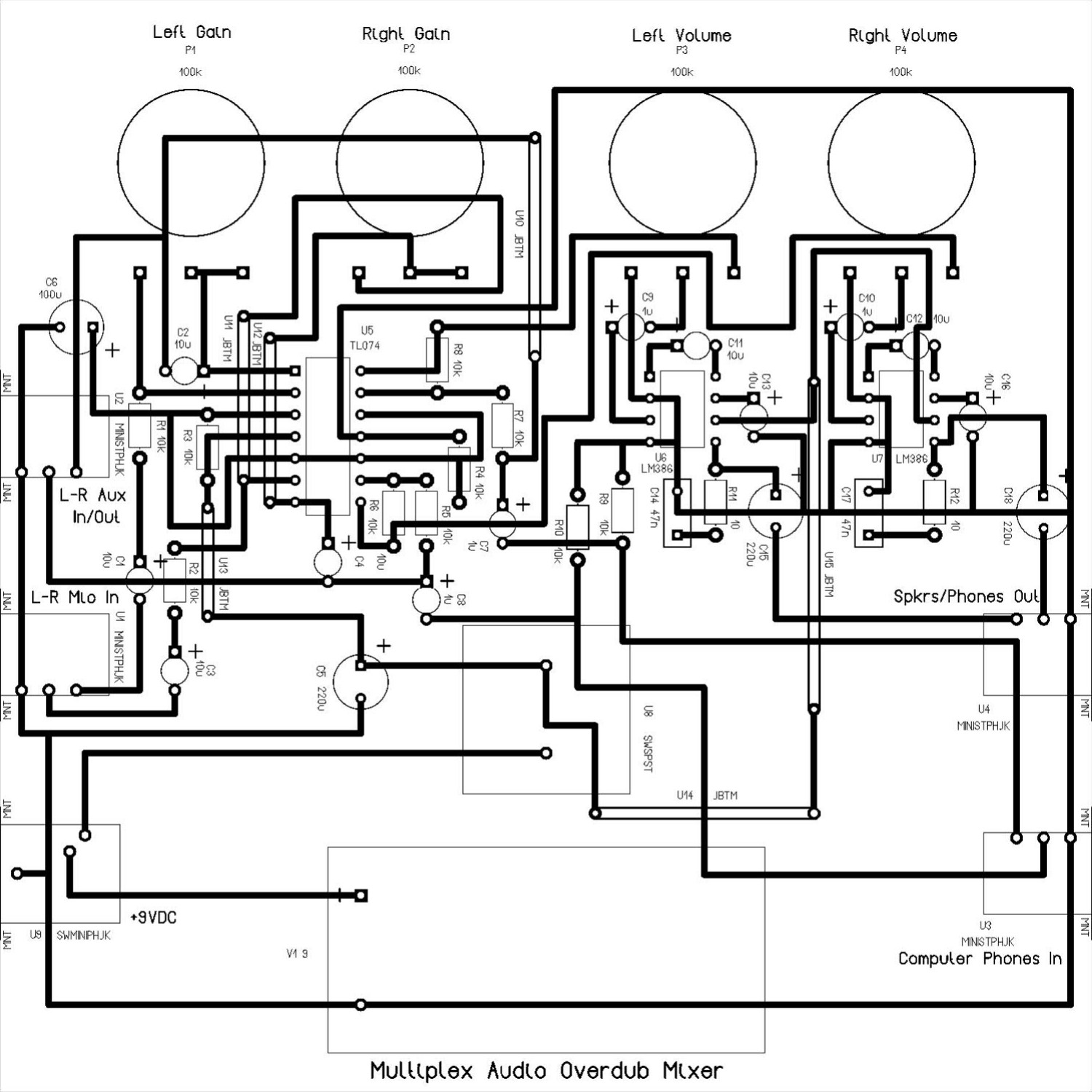

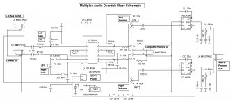

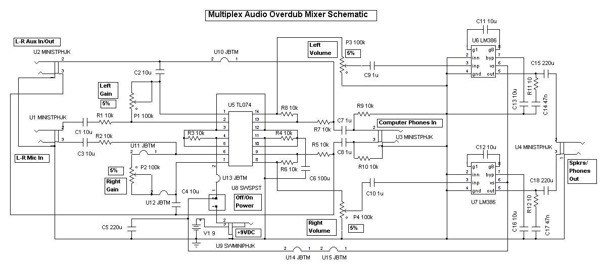

Multiplex Audio Overdub Schematic

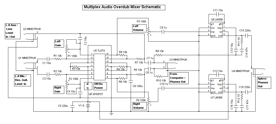

I spent the day designing this Multiplex Audio Overdub Schematic ... It's based upon a Quad TL072 Op Amp and 2 LM386 Low Power Audio Amp Integrated Circuits ... It has Mic/Elec. Guitar Hi-Impedance Inputs (L-R) with adjustable gain up to 10X ... Tandem Universal Aux/Line Inputs/Outputs after the gain stage ... It then feeds into a 'buffer' stage that allows Computer headphone output mix to the final LM386 Amps for Stereo Output ... I had planned on this for quite some time and finally got around to it !!!
This is the updated version with a printed circuit board layout ... this is the reason for the additional jumpers on the schematic ... to maintain a single layer bottom trace on the pc board. Board dimensions are 5" x 5" ... etching would require a mirror image of the board ...

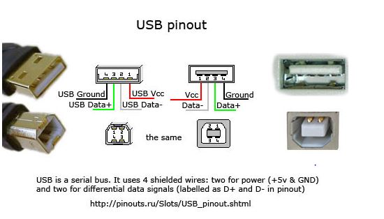

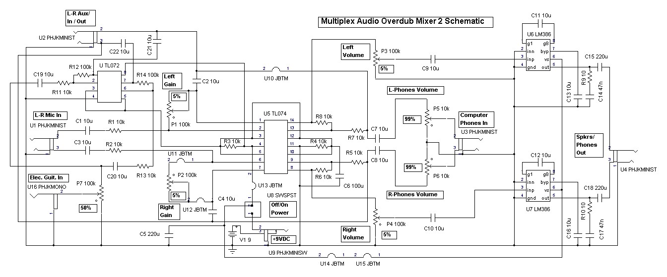

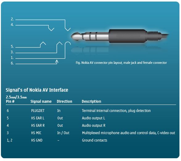

Here is an updated version with better buffer isolation by adding a dual op amp for guitar imput ... notice that the input is monaural (one channel) yet the output is stereo (2 channels) to alleviate the guitar plug/jack cancel of one channel ... the printed circuit board layout in previous thread is top side to scale ... not mirror image for etching ... will design a pc of this version A.S.A.P. ... Also, these (as many of my musical/audio do-it-yourself projects) are experimental SPICE designs and have not been physically built and tested. Although, I have been active in Audio Electronics for nearly fifty years and design with SPICE based primarily on hands-on experience of many previous constructed stomp boxes and etcetera. Additionally, I reduced the voltage to +5VDC and it worked in a simulation run just fine ... This is typical USB (Universal Serial Bus) Voltage ... A standard USB has four connectors ... The outside connectors are +5VDC and Ground, respectively and the two inner connectors are for data processing! SEE IMAGE ... also included is an image of a standard phone plug pin out ... This applies generally to both 1/8" and 1/4" versions of plugs and jacks.
