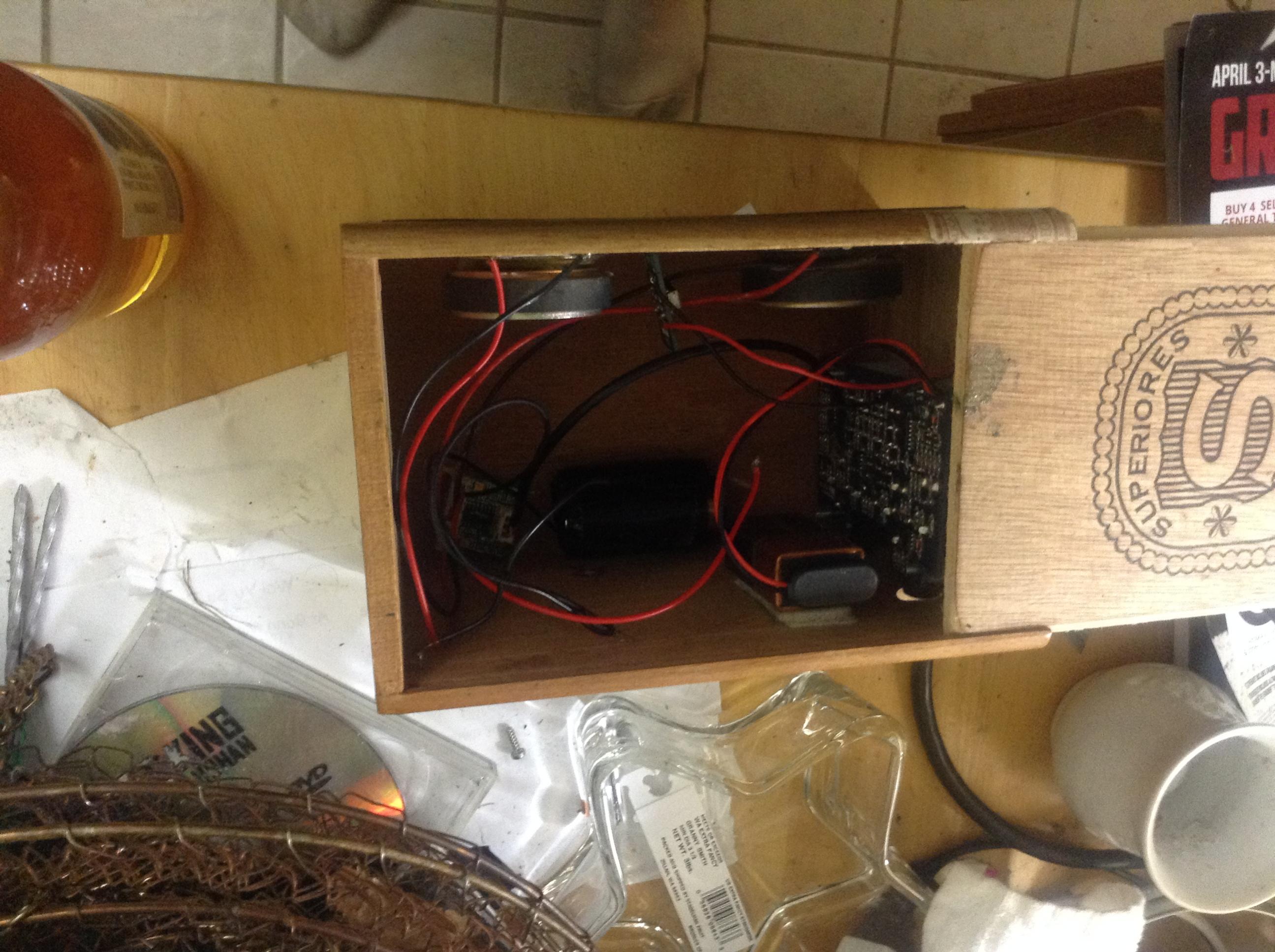

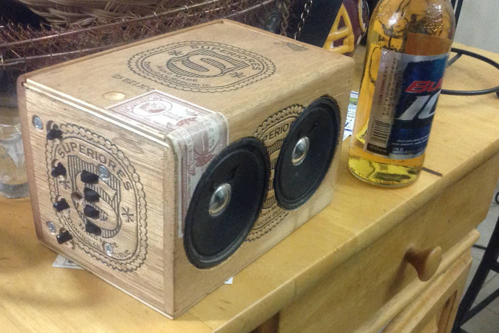

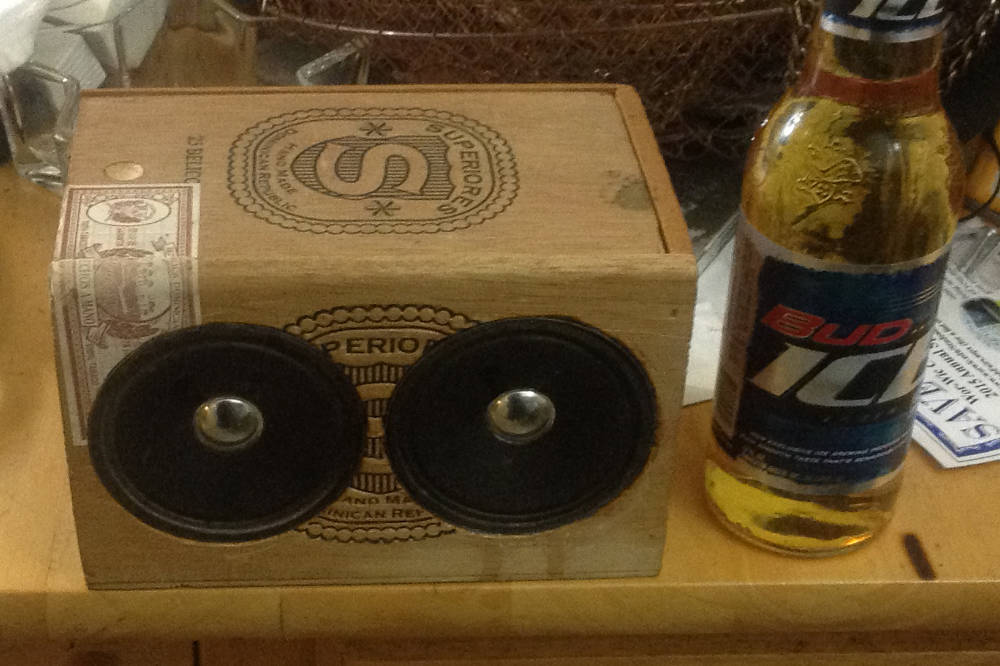

Interesting topic! I'm working on the same type of project. I had the same issue with driving the 2x3W cheap amp I bought(I mean CHEAP lol $3).
I had a behrenger amp modeler stomp box laying around and it made the little amp scream. I ended up gutting it and installed it in the amp(cigar box). pretty sweet but I already want to build new one :)
I don't see any reason why you can't use the first stage of the Ruby as your pre.
There are some links here as well: preamp for guitar
Here's the amp board I used: Mini Digital 3W+3W Amplifier Module Board - Green
Surprisingly loud with the stomp box in the loop! And $3.09 a pop lmao!! Pics attaached.
My next amp will be a custom board using a TI TPA3112. I may try the FET preamp with that one.

Your Amp looks very nice :)
