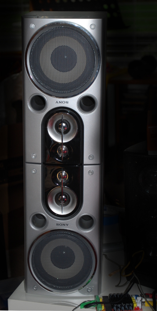

I took my project from the "Portable Princeton" thread to my weekly jam last night, to test it at higher volume levels than I can use in my apartment.
It's a pair of thrift-store Sony speakers glued together, a Yeeco class-D board ( Yeeco 2X100W Dual Channel Digital Stereo Power Amp Module DC 24V Class D Audio Amplifier Board for 4Ω 6Ω 8Ω Subwoofer Sound System Speaker Car Vehicle Home Theater: Amazon.ca: Tools & Home Improvement ), a nominally 20 volt cordless tool battery pack, and a Joyo American Sound pedal for somewhat Fendery sounds. Last night I also used a Mooer delay pedal and a Biyang reverb pedal to take the edge off the Joyo's overdrive (and compensate a little for the lack of tubes in the clean rhythm tone). First in the chain was a Danelectro Fish-n-Chips 7-band graphic EQ to dial in a good clean tone.
All things considered, my kludged-together little battery-powered amp gave a pretty good account of itself - it was more than loud enough (and I don't think I got anywhere near clipping it.) Somewhat to my surprise, the pair of little 4.5" woofers coped just fine with my guitar signal, both clean for rhythm, and slightly overdriven through the Joyo for solos. Also somewhat to my surprise, the little speakers actually sound bass-heavy for guitar, though the Fish-n-Chips EQ pedal soon fixed that.
For reference, one of the other guitarists was using a Fender Acoustasonic 90, which she also uses professionally on stage with her country-music band. She plays rhythm guitar, at reasonable volume - not ear-blasting, but not whisper-quiet, either. My thrift-store-special amp let me play guitar solos at a volume comfortably balanced with the rhythm guitar from the Acoustasonic.
With the battery pack at 19 volts, I estimated a maximum output of 25 watts RMS per channel into each of the two 6 ohm speakers, assuming 2 volts lost to output device saturation and battery voltage droop. So, if those two weeny little woofers don't fry first, 50 watts total combined power from both speakers should be possible.
I also experimented with using my Digitech Trio+ pedal with the battery-powered amp last night. This pedal auto-generates drum rhythms and a bass line to go with your chord progression, and you can also loop a recording of your guitar with that. Everything worked, and the Trio's bass line was clearly audible, but the drums sounded boomy and lacklustre, because of the limitations of the little Sony speakers. (The drums sound much better through my usual P.A. system.)
I still want to design and build one or two microphone preamps and a simple mixer before the actual outdoor jam happens. But the basic guitar amp half of this thing already works.
So far, so good. I'm quite pleased with the way this has turned out so far. :)
