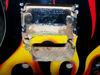

Hello, I recently picked up a guitar that originally had a les paul style tunomatic bridge, but the owner wanted a floyd rose so he went bonkers with a plunge-router and left it with a gaping hole instead. I would like to put the old bridge back, so here is the plan...The back area for the springs is done well, so i wanted to glue a tightly fitting piece of matching maple there. The top is the hard part, what I want to do is clean the hole up with a router and either i) do the same as the back ang glue a tight fitting pieace of maple in there to fill the hole, or ii) pour in some fiberglass resin to fill the gap. I understand that I will likely have crappy sustain and overall tone compared to the original, but what would be my best bet,I thought of the resin becasue it gets really hard, and it would bond to the wood everywhere becasue I would pour it in... what do you think?
I think it would be best to clean the hole with a router and install a tight fitting piece of wood. If you do that well, it may sound as good as it ever did.
If you absolutely have to use the fiberglass resin, mix in some kind of filler to avoid coldcreep and shrinking.

Hi, thank you very much for your help! I am glad you think that the sound wont be too badly affected by the repair! I am fussy to a degree, so a bad job that sounded like a bad job would very much bother me. I thought that just using the hard fiberglass would be ok, I didnt realize that just being hard wasnt enough. I have attatched some picks of the holes...one is of the back of the guitar, one is of the front (note the bridge pickup cavity and the holes for the stop piece) the guitar is a Hamer explorer. since the foreign fiberglass would not sound good, would other woods that are foreign sound bad too? I have a church pew-load of teak here that I use on my boat, or would there be a tonal advantage to using a better (ie korina) wood?

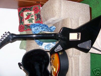

ps: I found out that the guitar in fact has a 1 piece alder body with curly maple top,
pps: I have a friend that does airbrushing so I will get him to re-paint on those hella-cool hot rod flames

WoW! What a butcher!
Hi, well this is not so bad as I might have expected, and to me would not present any problem.
That is a good start, and it helps tremendously if you don't need to try and match up the wood grain etc., as you obviously don't need to here.

Regrettably, all of the damage to the front is not as clear as I would like, so is there any chance of another shot, perhaps at an angle, rather than straight-on at the front? This would help me assess how deep the damage is etc. which will have some bearing on the suggestions.

WOW, I have never found anyone so helpful! well, I wasnt expecting the attention, so I wasnt completely honest, I dont actually have the guitar yet, so unfortunately I dont have anymore pics. Its from ebay, and those pictures were from the item description. I was asking these questions to guage how much I should spend on the guitar... I am happy to say I will buy it now! anyways, back to the problema t hand...I have access to many power tools, most of which are my neighbors, and I would say I am intermediate with woodworking. I can do a good job if I take my time. Advice should be given like I'm someone who can work well, but may not completely know the jargon...I will take your advice on testing out the hardness of the wood, someone else posted that teak doesnt glue well, I beleive that, it is very oily as it resists water on my boat very well. I have a basswood strat body that I tried to laquer unsuccessfully that I can use for the plug, would that be ok, or is that too soft? as you said I can look online for alder...or I can see if there are any places in town that sell "exotic" woods. I will sned you more pics when I can get them...but heres what I initially think I should do: My boat fxing experience tells me to get rid of any holes or gouges and a bit around them...so I was thinking of routering a big square or rectangle around the problem area on the top, and making the corners nice and sharp with a table mounted jigsaw, that way I could have an easy shape to mate with the plug. As you said I would make the plug bigger, and belt sand the edges till they fit as snuggly as possible, and belt/finish sand the top till its flush, then call the painter man...does this sound ok? and would I glue it, or shouldl I try to get it to fit tight with no glue...?
Excellent start!
This is extremely encouraging to me, and hopefully very good news from your viewpoint.
When I said that this repair would be easy for me, this was not out of arrogance, but merely to indicate that I was now sure it was possible. If I didn't feel confident, myself, it would be wrong for me to flippantly encourage you to get yourself into a hole, especially now you say that you are not yet even committed to buying the guitar.
If you can get it at the right price, I wouldn't hesitate, and in view of the tools you have at your disposal, it should be a very good result given a little time and patience.
It is much, much easier to rout out a clean, straight-sided aperture like this with machine tools, than ever it is to do it by hand. I know, as I have done it both ways!
The ideal here is to end up with a close-fitting plug, and keep trimming it until near perfect while it is 'dry'. (i.e. before any gluing).
To do this (exactly as you suggest) it would be best to mark out a new aperture as rectangular as possible, and with absolutely parallel sides looking from the front face working inwards towards the bottom of the cut-out, so you can then simply make a parallel sided plug which will fit snugly all around, to the full depth of the plug.
If you use a quite small dia. router, it would not then need to be 'jig-sawn' to obtain any sharp corners necessarily, and this may help if the cutout at the front does not go fully through the body, which would probably otherwise be necessary (or at least much easier) if you need to use a jig-saw, or whatever.
Looking at the pics (so far) I think this would be the case here, and when routing out, you should be able to end up with a clean and flat-bottomed hole, which by hand would be a pig to do. The advantage of this is that you will end up with a much greater area of contact overall for the adhesive, and some of the mating surfaces will be in different planes too, which is a great advantage structurally, and I guess tonally.
You may find this is better done with some routing from the front, with a suitable plug for this, and then 'attacking' the back similarly, and it will not matter if the two routs are not fully aligned in such a case, in fact it would be preferable, if anything.
If you end up without square corners in the rout(s), merely round off the corners of the plug at the last minute, to suit the router's dia., which shouldn't be too hard for someone with your experience, especially with a belt sander being available.
Here, by angling the plug so that you can push one end into the aperture (but not fully in at the other end because of the excess wood which will foul the rounded corner routs at that stage) you can still 'gauge' the fit between the two parts. Then do the same with the opposite end, and then similarly with each side. This is all made very much easier if all of the routing is done 'in plan view' with parallel sides too, so you can slide the plug up and down (vertically, and horizontally) within the aperture.
If you cannot get at the backside of the rout, make certain you insert a shallow woodscrew (or maybe glue something onto the face of the plug which can be removed later) without damaging any part of the wood which will ultimately be left in the finished repair (a good reason to start out with a much thicker piece of wood here, if you do use a screw), or you may not be able to get the plug out again to apply the glue subsequently!
If the fit at the rounded corners is ultimately not quite perfect, it would not have much adverse affect, as there will still be four quite long 'bearing sides' for gluing, anyway, and hopefully at least some part of the bottom of the plug will be stuck against the flat bottom of the routed hole as well.
Another 'trick' when making the plug and finally trimming it, is to make it say 1/2" or more too deep initially (partly to allow for any later trimming in situ.) but then you can chamfer the bottom leading-edge gradually at a very fine angle, until the plug will just fit all around. Then all you need to do, is to copy this 'outline' all up the sides of the plug and you are there!
If you chamfer a bit too much off anywhere while doing this chamfer trimming, it would then be possible to take a suitable slice off the bottom of the plug (out of this spare 1/2" or so) to restore the full size 'footprint' to fill the aperture properly, and less needs then to be taken off the front face when finally finishing.
Try to match the guitar grain's direction for the plug, and only consider any gluing when you are absolutely happy with the dry fit. If necessary (for the front, at least) make another plug if the first try is not perfect, as you will be more experienced at the second attempt, and you will already have a more accurate 'template' to work from.
For the front, it is important for the overall integrity of the sound to get a really good dry fit here, and when planning the size of rout for this, watch out for any load-bearing screws/fixings for the bridge etc. You may need to cut the rout slightly larger here, if any fixing screws will end up near to the join, as these will later tend to 'spring' the join and look bad, but more importantly need to go into 'sound' wood (no pun intended) for the best tonal results.
When finally gluing, use a good PVA type of adhesive (Weldbond, which comes from your area, is excellent here), as this soaks well into the wood and expands it a bit as it sets. Epoxy types of adhesives tend to leave a thin film of a plastic nature between the surfaces all around as they don't dry out partly by evaporation like water-based glues, they don't soak as well into the grain of the wood, and they only set by a chemical reaction.
Any such 'plastic film' interposed between the wood parts will ultimately tend to have a slight isolating and damping affect on the sound, I reckon.
After the PVA has *fully* cured, if there are any cracks or small gaps etc. still apparent, use some cyano-acrylate (Super-Glue, but not the viscous gel-type though) as if this applied generously to the joints it will 'wick' into them deep into the wood join by capillary action and also soak into wood just like water-based glues. Unlike Epoxies, it does set quite hard and would be OK for the entire gluing process here as far as strength is concerned, but it would doubtless 'go off' part-way through the assembly, and you will need more time for this than cyano would allow!
The thinner viscosity cyano is very good here, and will fill any hairline cracks (maybe around the rounded corners, if the fit is not too good) and the final result will be stronger than the original wood. You can also set it off with a spray of special setting agent if needs be in larger gaps, or you can mix it into a putty with some wood-flour (made from the later sanding exercise) if you are fairly quick, and use this for any small surface holes etc.

haha, thanks Bobken...I went for a coffee break during reading that! I think I had the rudimentary idea right, but you "filled in the cracks" (sorry, I had to get you back!) fro me. From what I can see the hole for the bridge goes all the way through, so should I make a nice rectangular route on the top that goes around the "hole" but doesnt go all the way through? and then fill the back in after? that way I get maximum adhesion and contact? is this correct?
You will really need to get the guitar in your hands before making any final decisions over the best method of routing here.
This is why I earlier asked for some more pics, as it looks to me as though the big rout in the front does not go through for the entire 'footprint' of this rout. It looks as if only the upper part goes right thro' and there is a part-way down shelf at the bottom of this front routing showing on the pic of the front.
If this is so, it will be better to do things the way I just suggested, and finish off the back as a secondary job, exactly as you say now.
I think it will appear much more obvious to you when (if?) you have the damaged unit in front of you.
You certainly did have "the idea right", but having done this kind of thing myself many times before, I hoped these specific suggestions will save you some time in experimentation, and avoid any wrong routes being taken.
I am sure you will succeed if you end up purchasing the guitar, and if as I said before (and as Al has just reiterated) you get it at the right price.
thanks a lot gentlemen, I will hopefully get the unit...after emailing with the owner several times the guitar seems to be perfect for what I want it for...barely used, with the only blemish being the one I need to repair which wil be both fun and educational-ultimately yielding a nice sorta almost new guitar that I couldnt afford otherwise...when/if I do get it I will return to this thread and add more pictures...thanks
