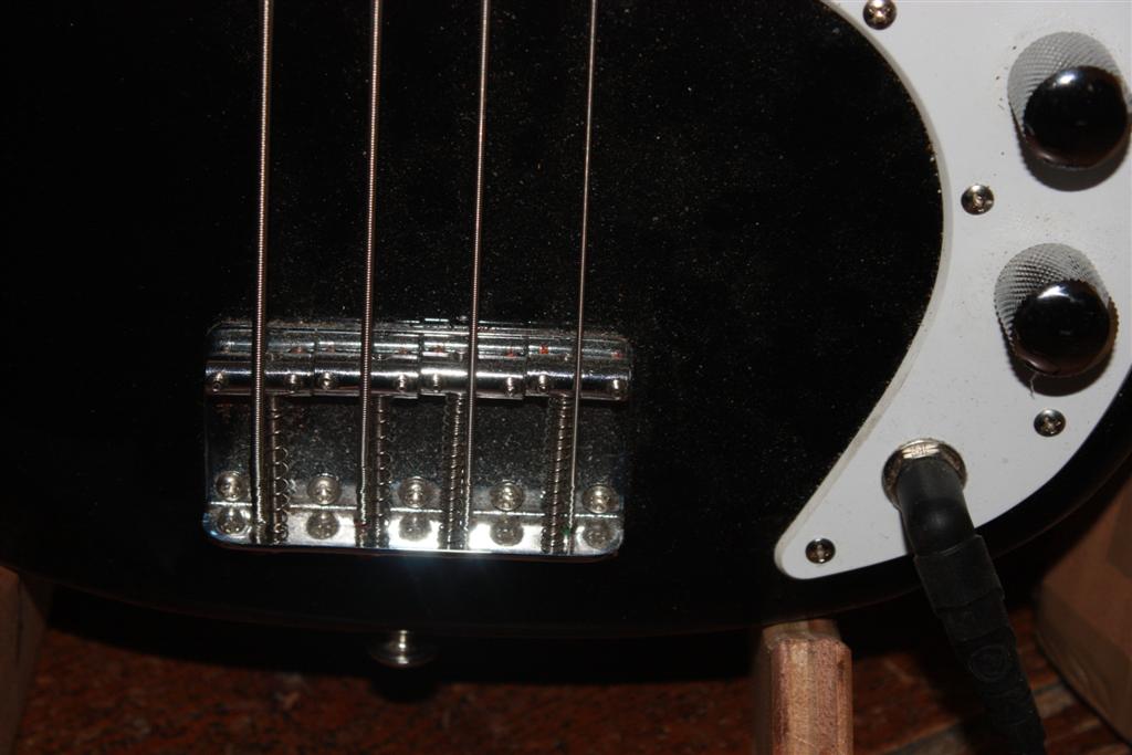

good news, the heavier string (15 up from .13) seems to have improved intonation, not 100%, but it seems to be more in tune overall...might go one gauge heavier (.16) next time I change strings ( a rare event) - hope the small neck can handle it...
I have read about using thicker strings, due to the lower string tension of short scale basses, in general

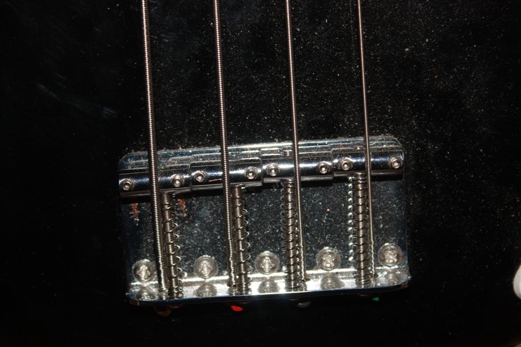

if of any use, my bridge tuning looks like this

If it is right can only be said after checking. But the thicker stings must usually be longer for proper intonation. This is because they are a little further apart from the theoretical string model (and its behaviour) and closer to a metal rod (with its respective behaviour) due to their lenght/thickness ratio.
Intonation is the last thing that you fine tune when setting up because it has the least influence on the other parameters like relief and action.
The setting of the relief (via truss.rod) and action (via the bridge saddles) have a mutual influence. Therefore they have to be adjusted alternatively. I.e. the whole thing is an iterative task.
There is a fine ducument on how to do it on Jerzy Drozd's homepage.

Having recently purchased a bass guitar, I'm reading what's been posted here with interest - the octaves (at 12th fret) aren't quite in tune with the open strings. They're close, but I've pretty much run out of adjustment at the bridge.
lets hear more
I guess 12th is higher than loose string
and if you tune 12th down, it gets low and muddy on loose string
which way is your bridge run out
what kind of bridge

I've been adjusting the bridge so the sliders move away from the neck. The octaves a nearly there, but they can't move much further. The bridge itself is the same design as posted at the top of the page.
