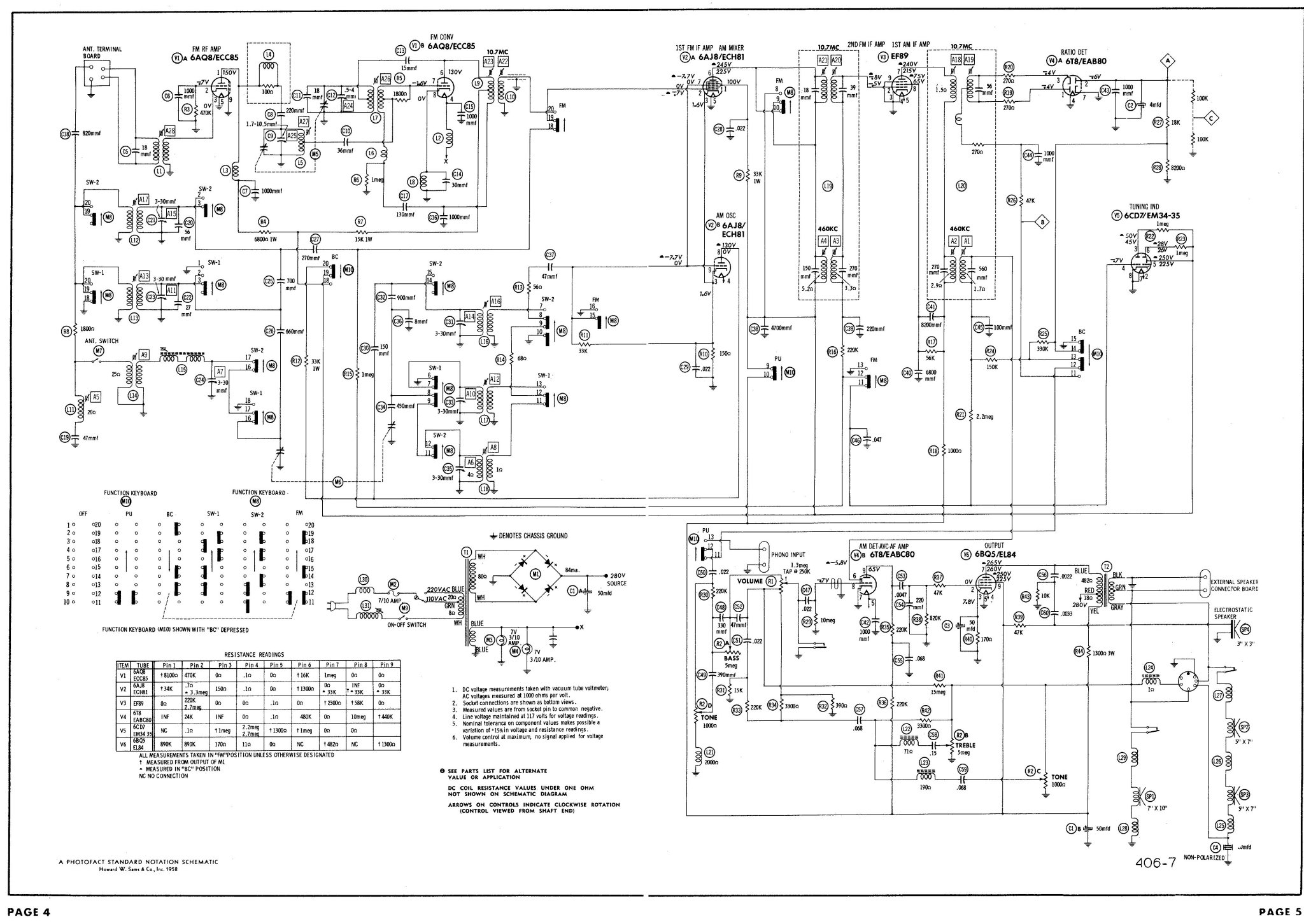

Grundig 3028 HELP
My second re-cap job
I just finshed re-capping my Grundig 3028 and now I have no volume control, just one steady volume, tone is flat also

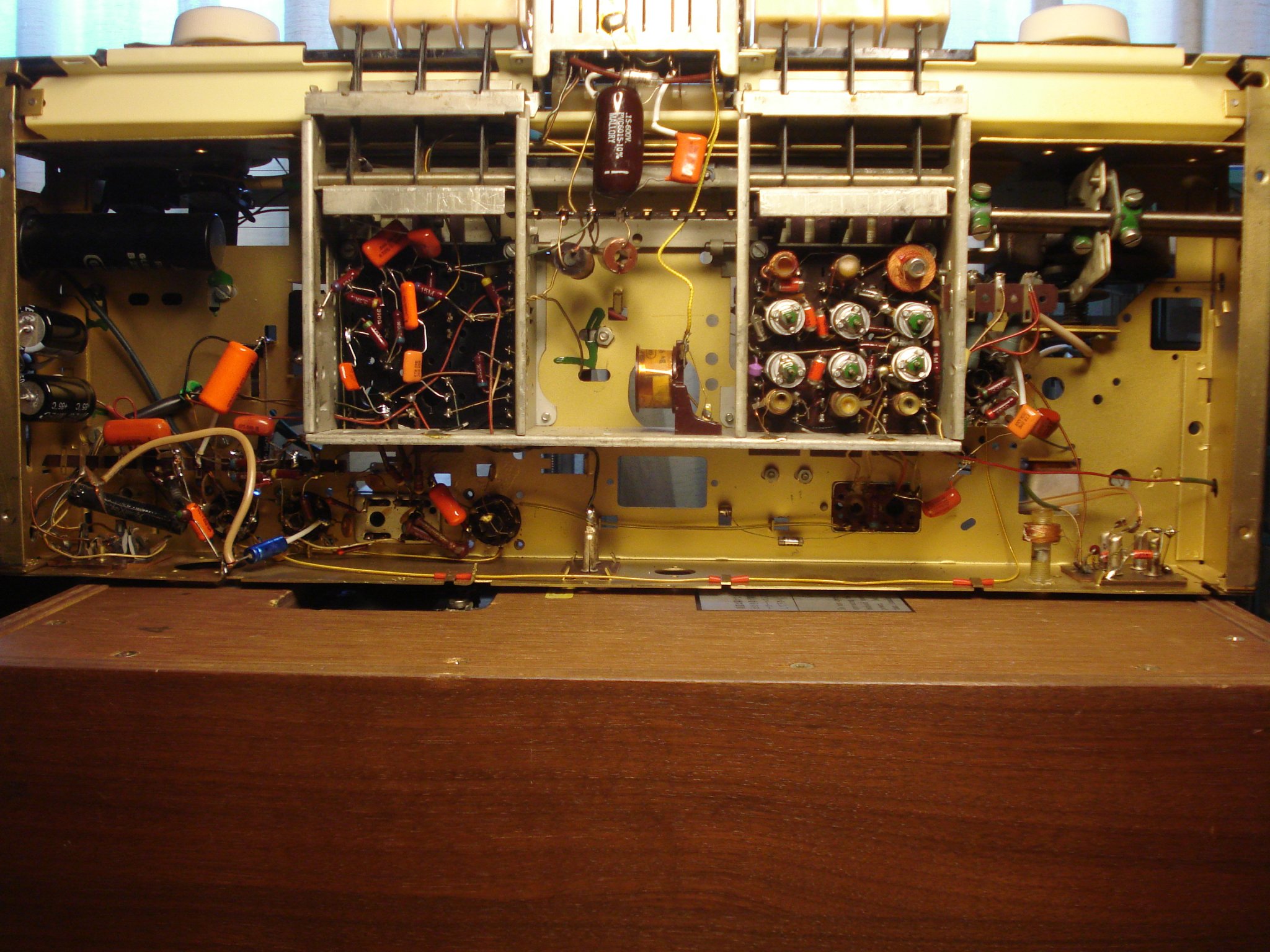

Does anyone have pictures of the under chassis with nice close ups of the capacitors so I could compare? That would help alot
I am a novice and not too good at using the schematic to trace the signal path
I did put an ohm meter on the volume pot and it does show change so I am pretty sure the pot is fine
This radio played ok except for a hum
I replaced 15+ capacitors, everything I could think of or was suspect
The pictures I took of the original caps were blurry and I have no nice reference (BIG MISTAKE)
Maybe some idea of where to start

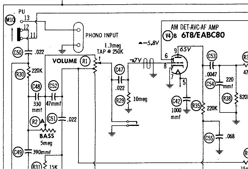

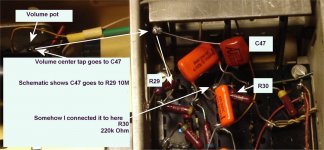

Steerpike, thank you for assisting me in this problem.
It turns out I had incorrectly connected C47. (see photos) Once I matched the schematic with "as built" then the volume was restored
This was a great lesson in tracing circuitry using the schematic.
LESSON: ALWAYS TAKE LOTS OF PICTURES AND CLOSE UPS

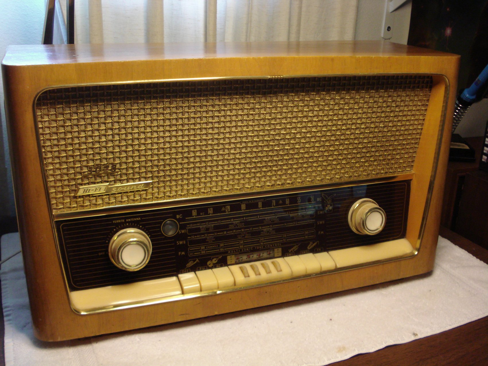

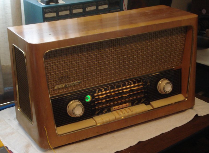

EM34 replaced by 6E5C magic eye
Since this Grundig 3028 restore is function first, I decided to forego the $50-$100 EM34 and instead go with an alternative solution
I got a 6E5C and did the simple wire mods to use the 6E5C instead of the expensive EM34.
The eye works great.
I placed a notice on the chassis indicating the 6E5C mods for the future generations a-coming
The NOS 6E5C cost $20 with instructions
