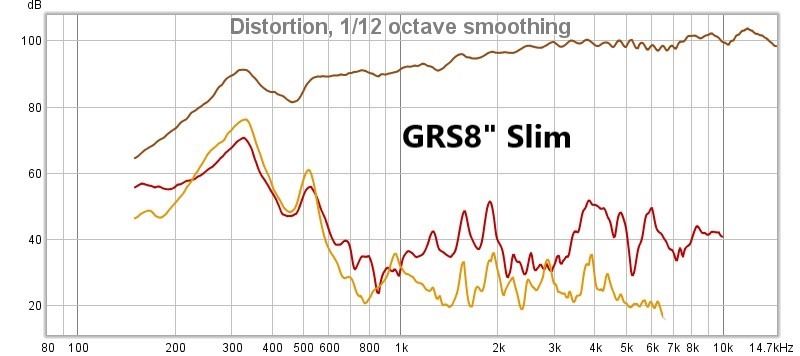

Also why you worried about slight distortion when you have HUGE distortion below 60 Hz at 90 Db?
Measurements are important, especially when it comes to health and safety but I'm trying not to make measurements my religion.

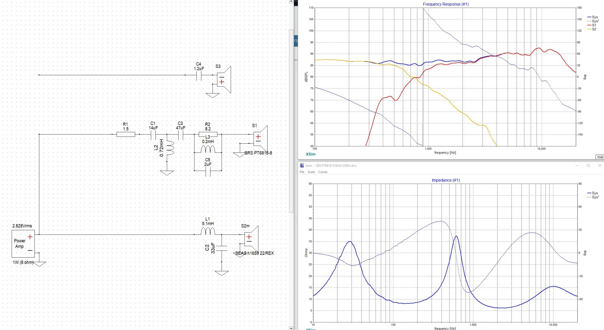

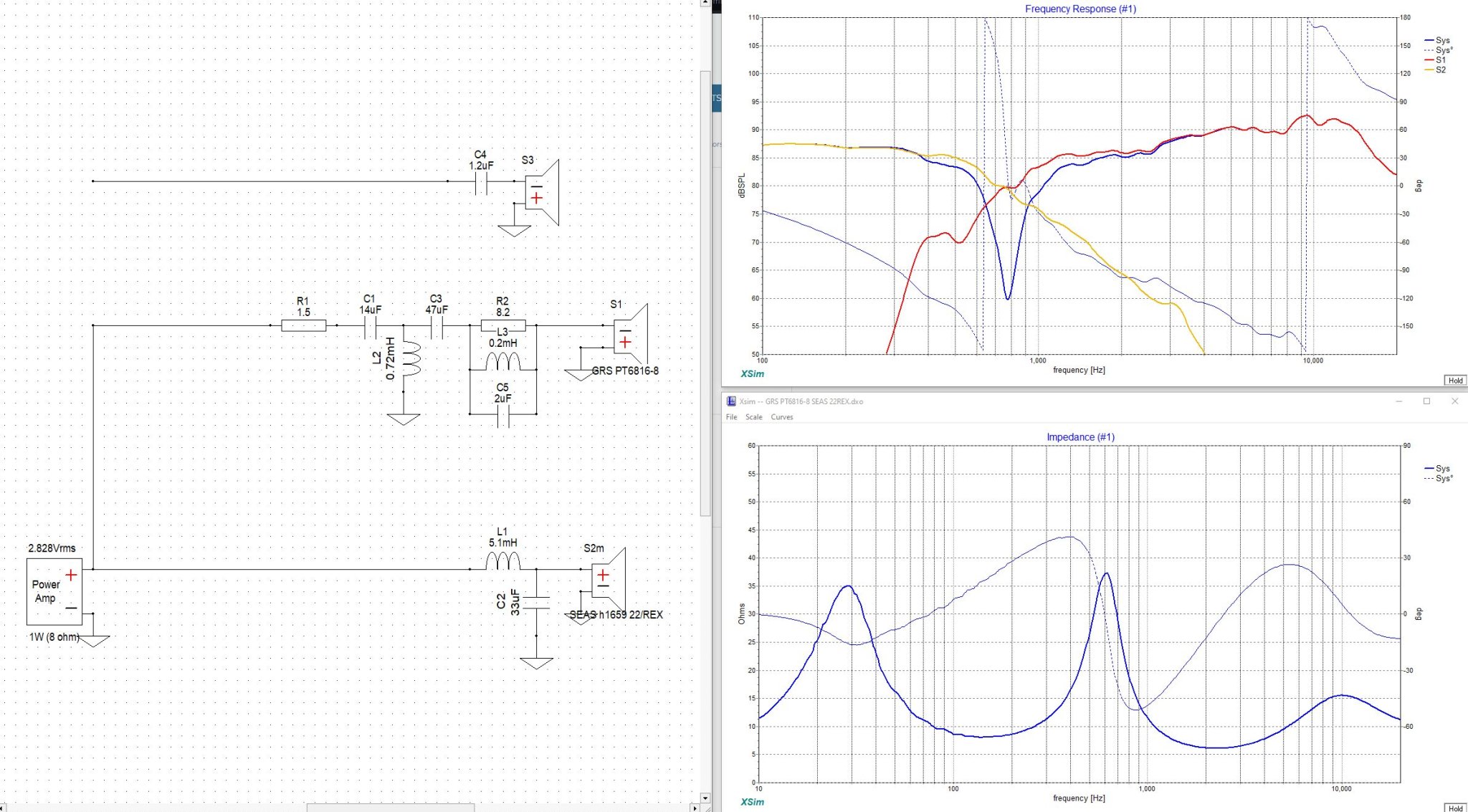

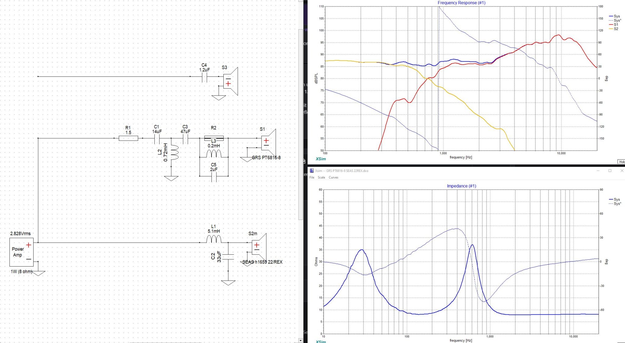

Not sure what you're goals are here but it would make sense to me to run the GRS open baffle to 1khz and cross to an 8" woofer there.......add a bit of horn loading to the GRS and match the directivity to the woofer.....would be a fantastic open baffle MT section over a boxed woofer at 100-120hz or so.
You should definately consider raising the crossover point btw the woofer and the Slim 8. It's distortion rises significantly below 800hz. And this is NOT just graph watching, it CAN be heard. You will experience a forward or shouting midrange presentation even if adjusted to measure flat. Regarding the 8Khz peaking, if that doesn't bother you, maybe this won't eiether, so to each his own. You may like the extra clarity or detail you hear from this top end boost, but for many listeners this becomes fatiguing over time.
Almost done hopefully.Not sure what you're goals are here but it would make sense to me to run the GRS open baffle to 1khz and cross to an 8" woofer there.......add a bit of horn loading to the GRS and match the directivity to the woofer.....would be a fantastic open baffle MT section over a boxed woofer at 100-120hz or so.
This guy -- https://www.rob-elder.com/LouC/speakers/Neo83/Neo8Neo3P3.html -- says it doesn't sound better open baffle.
I would have thought it sounded better open baffle, also, but I guess people have different opinions.
Also the aesthetics of open baffle suck *** according to most persons' humble opinions, including mine, but it's not too bad if it sounds (way) better.

Raise it to what frequency?
Where did you get that fantasstish graph?
I had it playing on my counter open baffle just tilled up about 60 degrees, next to a tilled DAYTON RS52AN-08 both high passed at 320 Hz 12/db octave.
The RS52 sounded like a small woofer playing in a small box at the low end and the GRS sounded fine I thought.
So I figure 800 Hz would be okay, guess I was wrong.

About the large peak at 8-12 KHz.
After listening to sound, not looking at graphs (insert mind blown emoji here) I have to agree with another person on DIYaudio, that the peak on a or this AMT driver is not irritating.
"Wouldn't worry too much about the 12khz hump as it's really not there with music"
I think the 300 Hz bump is supposed to be attenuated by the enclosure I built, according to the website I linked to:
Hopefully it is the right size, but I can make it smaller.
That's why i asked your goals.....open baffle is a different thing......and for the folks that can place their speakers out into the room 2 meters, it just doesn't get any better than a well executed mid-treble solution......i'll stand by that statement inside out.
Not sure about the driver sounding 'better' due to the loading......more likely the overall alignment didn't work for the fella.
The measurement is my own, performed at the same time I did a planar measurement series with all of the PE drivers when they were newly released and compred them to original BG models and the Radian drivers that were coming out at the time. My measurements begin on page 5, but there's good info all the way through the thread.
https://www.diyaudio.com/community/threads/new-planar-drivers-at-parts-express.360339/page-5
I think several of us thought that you were crossing at 300hz because that's what you mentioned in you initial post, but I see now from your graphs that it looks like you're closer to 800hz, which is good. As to the "detail" you like, I'll say again, elevated treble always gives the perception of detail. It's not accurate though. You may not care much for measurements, but there's a reason well designed speakers generally follow a similar freq response profile and that those same speakers are generally preferred in blind testing as performed by Harman. If you find that only certain styles of music suit your speakers, that's a sign that their freq response is not great.

There isn't much information in the 2-4 KHz plus range.
I do like blind A/B testing the best though.
I spend a lot of time looking at graphs.
It's kind of good and bad.
The B&G neo8-PDR and Neo8 and GRS 8 all look excellent.
Slim looks okay.
That's kind of the downside of being "smart" is over analyzing everything.
It's not really even smart it's just training your brain to be active in one sense and then passive in another.
I guess I'll look for a B&G and GRS 8 real quick.
If I can't find any I'll just move forward with the GRS8 slim.

In the spirit of audiophiledidness, I guess I should add this filter.
I think it's a series notch filter.
What do you humbly-opinionated veil-removing golden-eared graph-oglers think?
That's some nice looking graphs, right?
In the hopes of keeping things simpler, I'm temped to leave the notch out, but it does make the graph(s) nicer and in theory should sound better, no?
I just remembered with this tweeter there's a vertical and horizontal off-axis FR I should try to account for, hmm . . .
