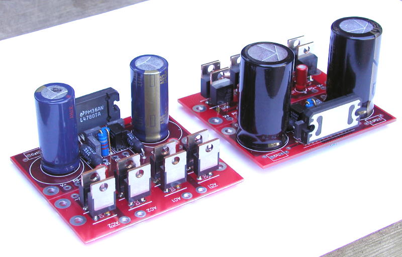

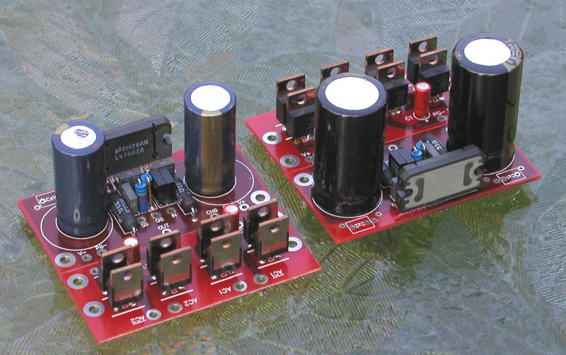

So here it is, first two boards assembled ( as I believe Brian assembled only one so far ).
I got a bit sidetracked with my recent experiments with TDA1541 DAC, but yesterday I finally managed to put together those boards and today I hope to put it into a chassis and compare with 3875 chip (that's why I used similar components). It seems like leaving rectifier board connected is a good idea and I will feed two double bridges from common secondaries.
I must say that this board came up pretty nice actually and there is not a single thing yet I would like to change here.
It seems like double aluminum oxide insulators might work here, as they provide more than enough spacing on mounting holes. In that case a push bar would have to be used.
I will be experimenting with bridged configuration soon.

From your pictures it appears that you've used larger capacitors (physically) on one of your LM4780 amps than the other. Are the larger capacitors (physically) black gate? Are they higher capacitance? Why did you choose to use different capacitors on each of the LM4780 amps?

Peter Daniel said:It seems like leaving rectifier board connected is a good idea and I will feed two double bridges from common secondaries.
I don't think it's a good idea at all, Peter...

If I didn't try it I wouldn't say so. I'm using this arrangement in my monoblocks and I don't see any problems whatsoever. I was kinda surprised myself, but I usually try things before making any comments
On one board are 1500u Panasonics. I tried them already in a protoype and they work fine. On the other board are 1000u BG STD, to show that they also fit the board.
I this case I'll agree with Peter I have also rectifier pretty close and have no problems with that. Picture here if you want to check.carlosfm said:I don't think it's a good idea at all, Peter...
