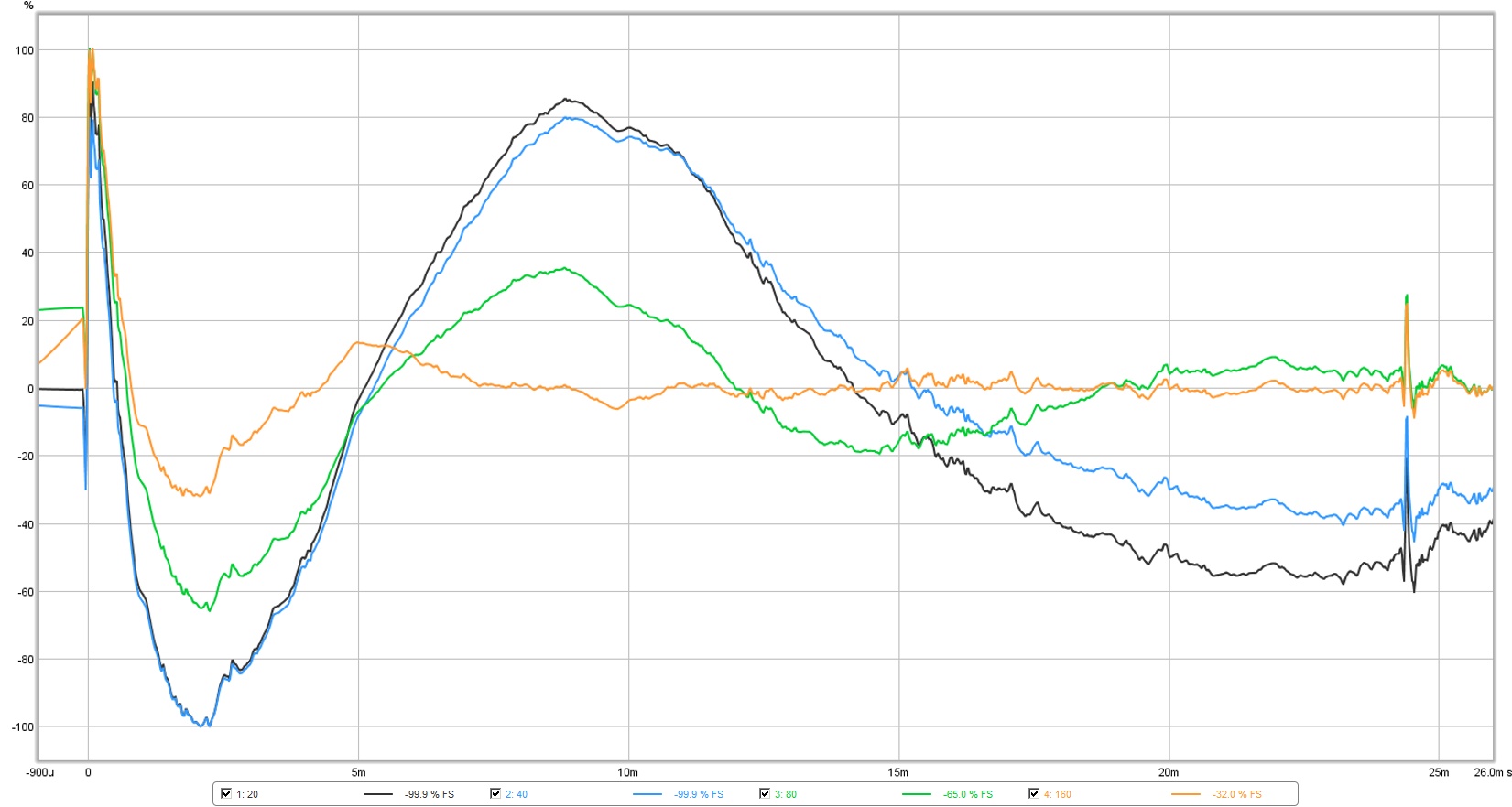

Well ok. I should remeasure, but here is from a file I found from when I was tuning (I'm using XSim to plot the files and calculate time domain shots, but the XSim model is just the EQ'd speaker). Looks like the highest octave phase was needing some more work at that stage. I didn't get too aggressive in the bass since that will get position dependent (you can see I have a floor bounce issue at 200Hz that it seemed best to not push too hard). The sub was a little hot in level then too, I have it lowered now. The thing at 500Hz seems position dependent, too, I think that's related to other nearby chairs.
Here's what a 1kHz square wave looks like
And the step response (this moves around with position, too, of course, since low frequencies dominate step response).
All that said, I didn't find that having the higher frequencies with 'waveform coherent phase' made a striking difference, plain response flatness was the most important there (and setting up room surfaces to control reflections). It probably depends on how well things were done in the recordings a lot. Synergy horns are already quite coherent, and minimize room reflections - in some recordings the applied reverb can be so obviously audible it can get distracting with Synergies. In the bass, linear phase made a big diff, though.

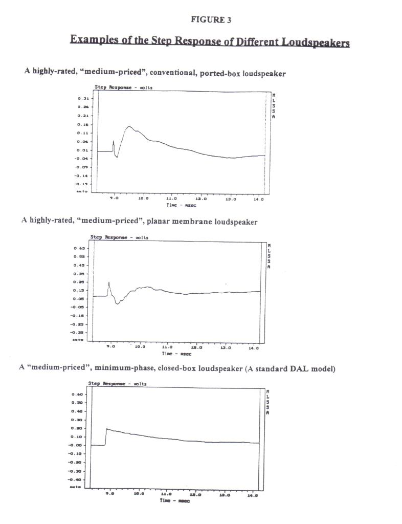

How do you get your SR to go flat to the right like its a DC servo? All SR's Inhave seen before start falling down in a triangular shape - even for reportedly excellent speakers.
It's supposed to look somewhat like that X, the more you are right in the time domain, the flatter it gets. The example you saw from Stereophile was a Quad if I remember it right. Look at this post from mitchba: http://www.diyaudio.com/forums/multi-way/259384-why-i-think-actives-better-10.html#post3999587
It can never be totally flat though, but it can be better than the examples in Stereophile.
So the more "horizontal" the STEP goes, the closer to actual timing you are. Not that easy to get, mine does not do it yet due to a time delay around box/speaker resonance.
And early reflections in the measurement mess it up too.

In the case of Dunlavy's plot the impulse is at 9 ms It crosses zero at what, 14 ms? 5 ms is one cycle of what frequency? The one Mr. Waslo shows is actually more impressive, but corrected with Rephase I believe?

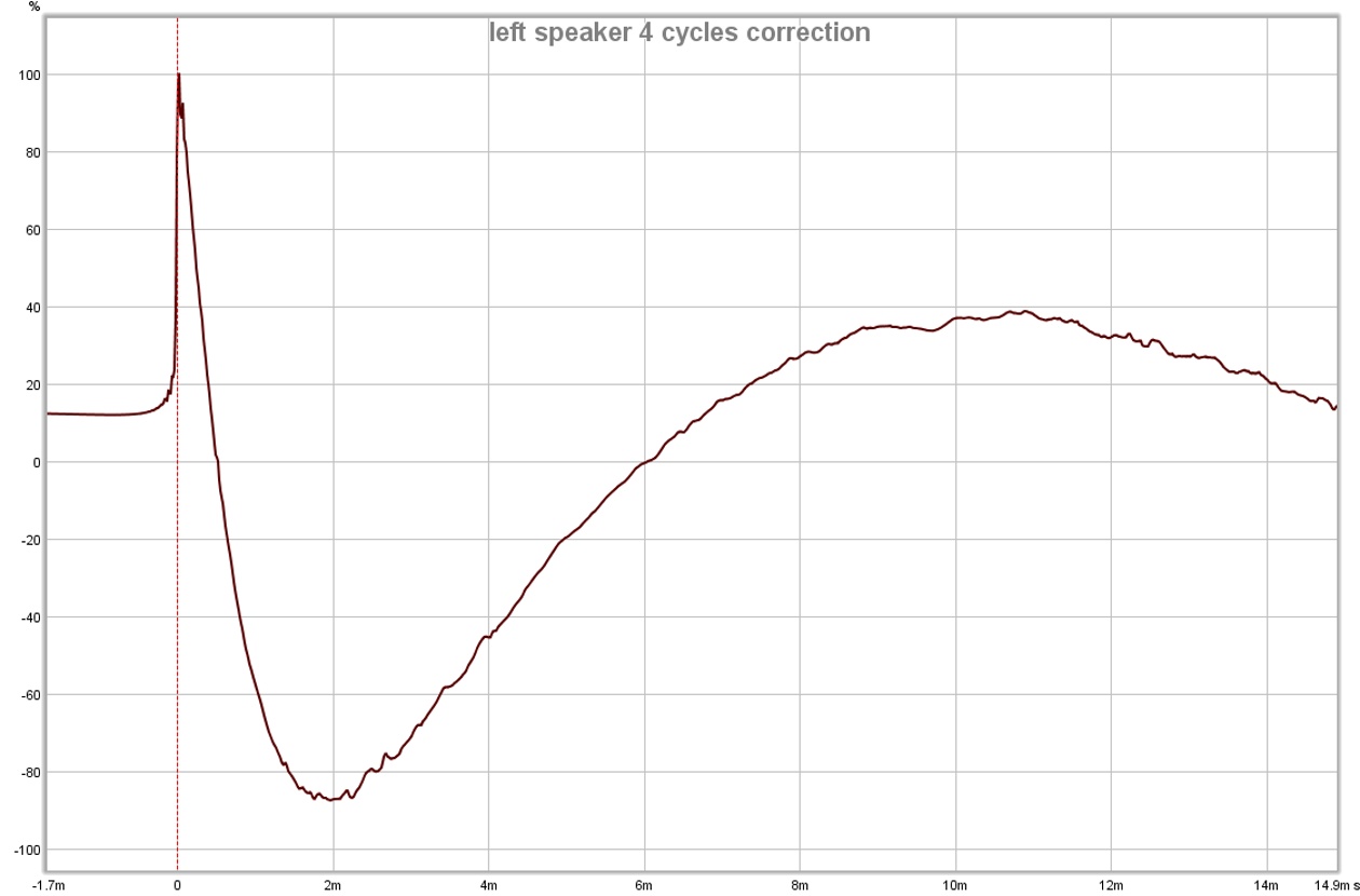

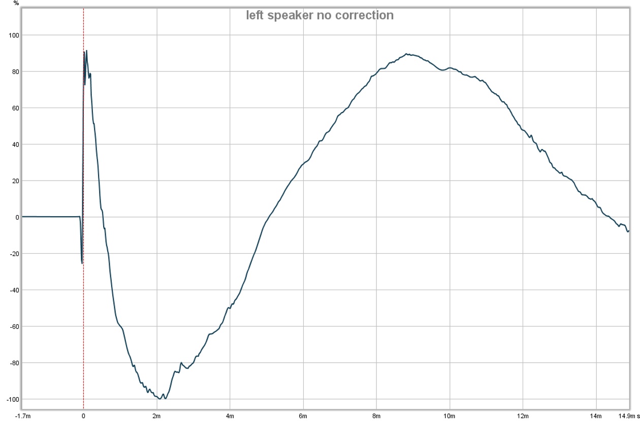

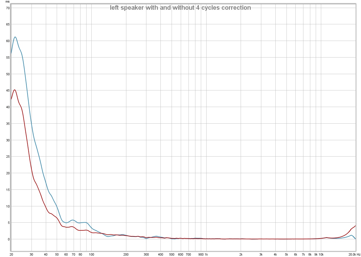

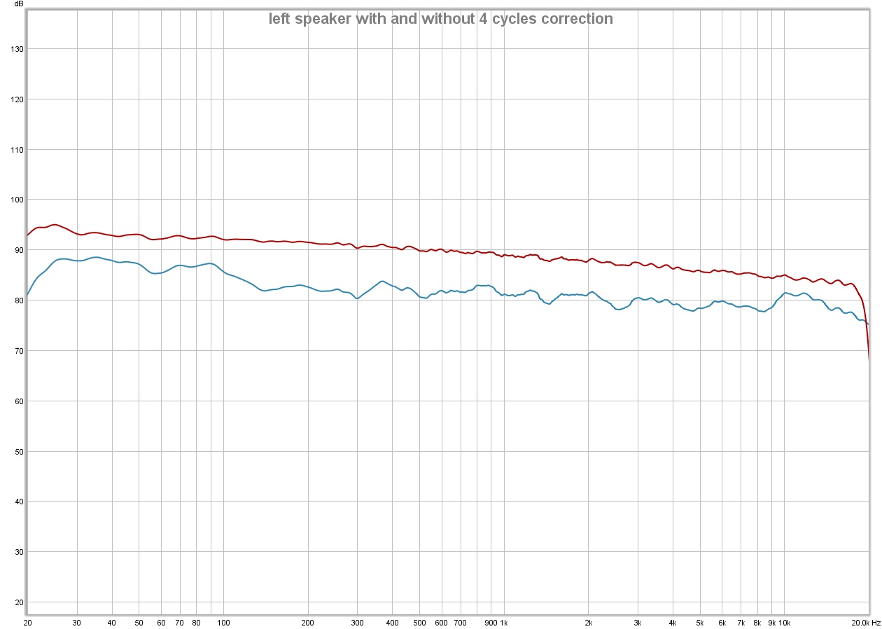

Predicted results of DRC correction over 4 cycles
Here is the improvement that can be expected with DRC correction with a 4 cycle window length. This is the window size that I use myself and it is considered to be a very small amount in the world of impulse response correction. I notice no ill effects outside of the sweetspot with this correction strength.
