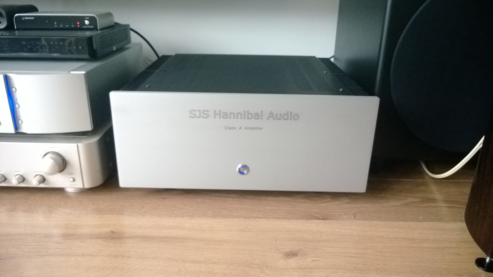

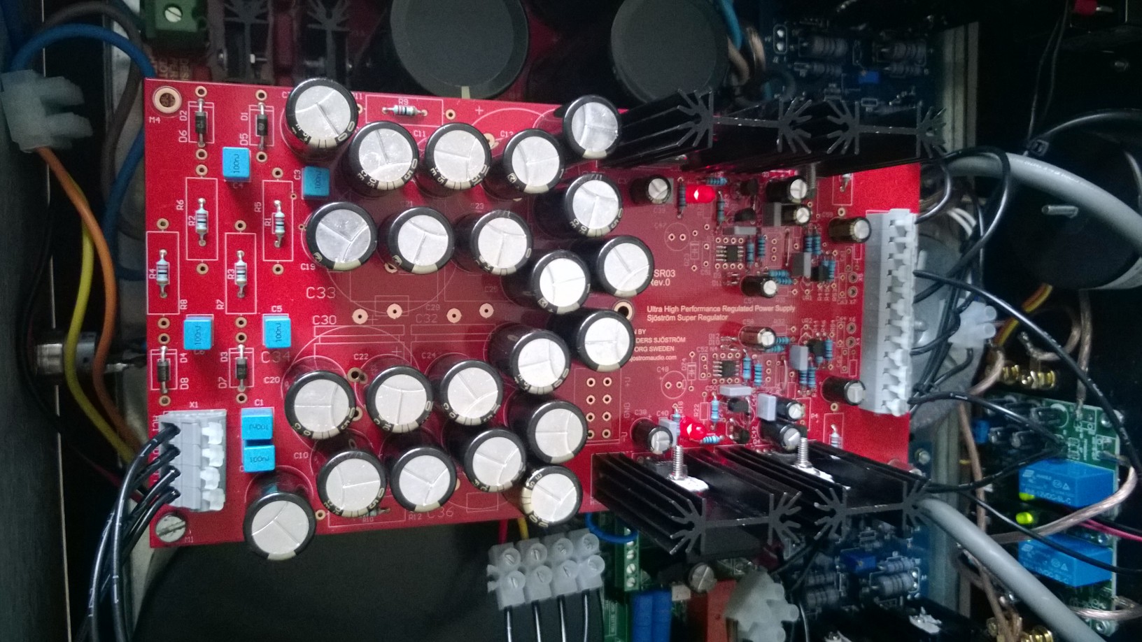

Built the supply and it sound great! I use it in my Hiraga 50Watt Class A amp instead of the 22V zeners. Perfect job! Thanks!

I don't need much amps. For me about 500mA is more than enough. And that's easy for the SSR03.

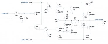

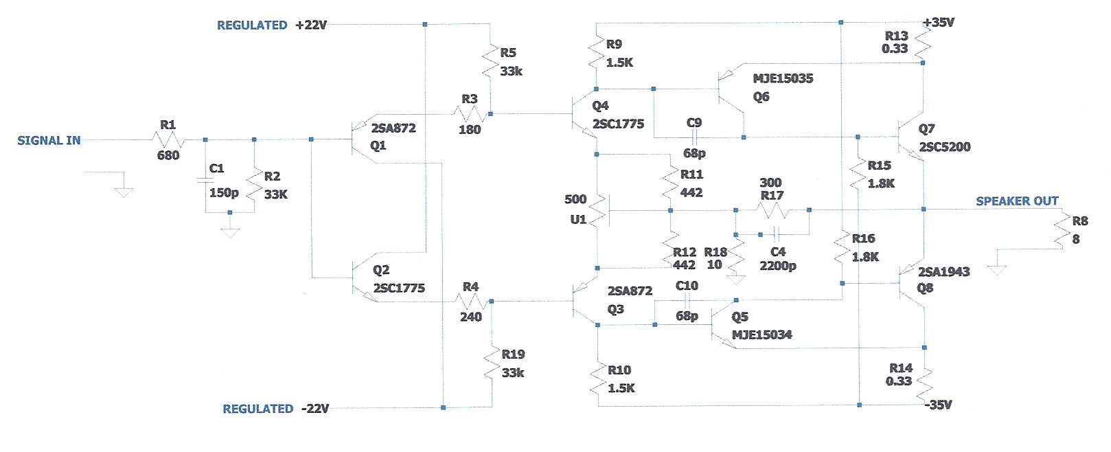

Posted the schematic. The -22 and +22V are from the SSR03. I need clean input stage voltage. This is much better than the original zener witch provided the 22V on the board.
