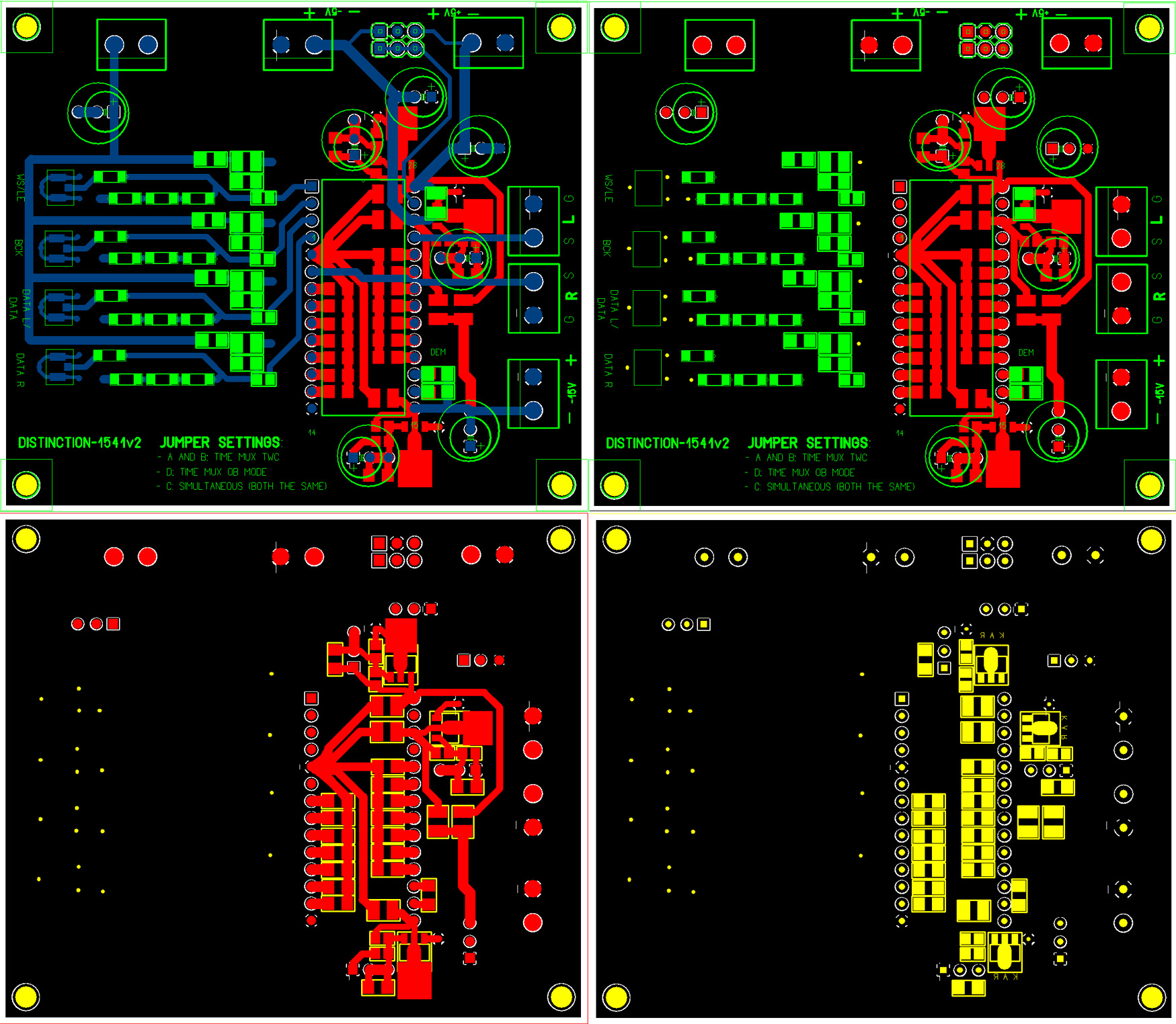

v2 progress update - draft
Thanks for everyones input.
Im trying to keep the design as simple as possible. The shunt circuit using the TL431 is great for this with its very low part count.
I've added space for bigger caps for the 3 power supplies - 5mm pitch; while keeping the 2.5mm pitch in place. The bypass cap in the resistive divider circuit gives you 3 options - 5mm pitch cap, 2.5mm pitch, and I also added a 1206 pad in parallel for the option of a low value film/ceramic for experimental purposes.
I've also added jumpers for mode selection between +5 and -5v inputs - not yet labeled.

Good to see most are happy/satisfied with the direction this project is going. Im happy to add a CCS using lm317/337 - which is what ill be testing and experimenting with anyway. So long as everyone is on the same page, if you wanted to try a different recipe it would be easy enough to bypass these circuits and use your own. Bypass cap for the resistive divider - This cap/caps are not essential for the operation if you choose not to populate, entirely up to you. The 1206 pad in parallel is optional, so feel free to do as you please to suit your tastes. I'll definitely test out various caps in these positions; as it seems to have a big impact on performance in the simulations.
@green77 - Both planes are directly connected at pin 14 (dgnd)

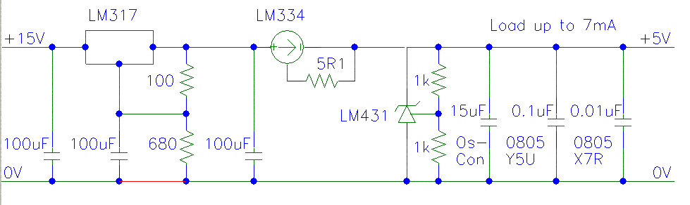

@Audiolapdance - I'm familiar with that circuit, although mine uses lm317/337 as CCS, the 334 is limited by the current it can supply, one advantage is these parts are dirt cheap and are in abundance of supply(LM317/337, TL431) so it seems like a really good option for all diyers, and it *should* live up to expectation or at least perform very well.

@bkdog - thanks for the info, looks like an interesting design, ill look into it more. On first glance the part count is much higher and it looks like a series reg? Really trying to steer clear of such circuits, keeping the current transient "loop" as close as possible to the TDAs power supply pins seems rather important according to a few experienced Legends. The current steering logic within the 1541 is very sensitive to its outside environment.

Yeah there should be, ill go over all the measurements with a toothpick for the final product. I've got Panasonic 1000uF that should fit fine. BTW 1000uF vs nothing at all in the resistive bypass position simulates 15dB quieter and 500m ohms lower output impedance.
For the power supply caps, ill make sure there is plenty of room for exotic caps.
