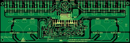

error is fixed
OOPS! Leaving all that space on top of the board was unintentional. I didn't think it would appear in the gerbers. I caught the mistake and sent correct files to Advanced Circuits before it was too late. Before they started making the wrong board.
The top edge and the transistor holes have been carefully measured to assure that the transistors will be flush with a heatsink without bending or straining the leads. I used the chip's PDF's to get correct measurements.
Attached are the correct images from AC.
Also, copper thickness has been increased from 1oz (0.35mm) to 2oz (0.7mm). I am soooooooooo new at this!

Besides the wider board, it seems there are quite a few differences as well when you compare to one of the latest iterations as seen in the other thread (see post #232 by alex mm http://www.diyaudio.com/forums/solid-state/187449-dx-blame-mkiii-supercharged-will-soon-released-24.html#post2647662 ), isn't it?
It looks like Alex was posting three different versions of the same board. The one on the left is the one we went with. You will note it is the same as the images posted here.

what happened to the board ? that is just wrong . it should be @ 10.5 x 3.5 , not 10.5 x 4.5 !!!!!!!!!!!!!
what's all that empty space ? are we supposed to cut it off ?

As Carlos (DestroyerX) said, I got the fixed gerbers to the manufacturer in time to avoid a delay or any extra costs. You should have seen my panic when I realized the mistake Tuesday night!:cuss:
The correct gerbers were waiting for the manufacturer when they opened Wednesday morning. I called and e-mailed to make sure they got them, and they will use the correct ones. Boards are still scheduled for August 4. Price is the same.

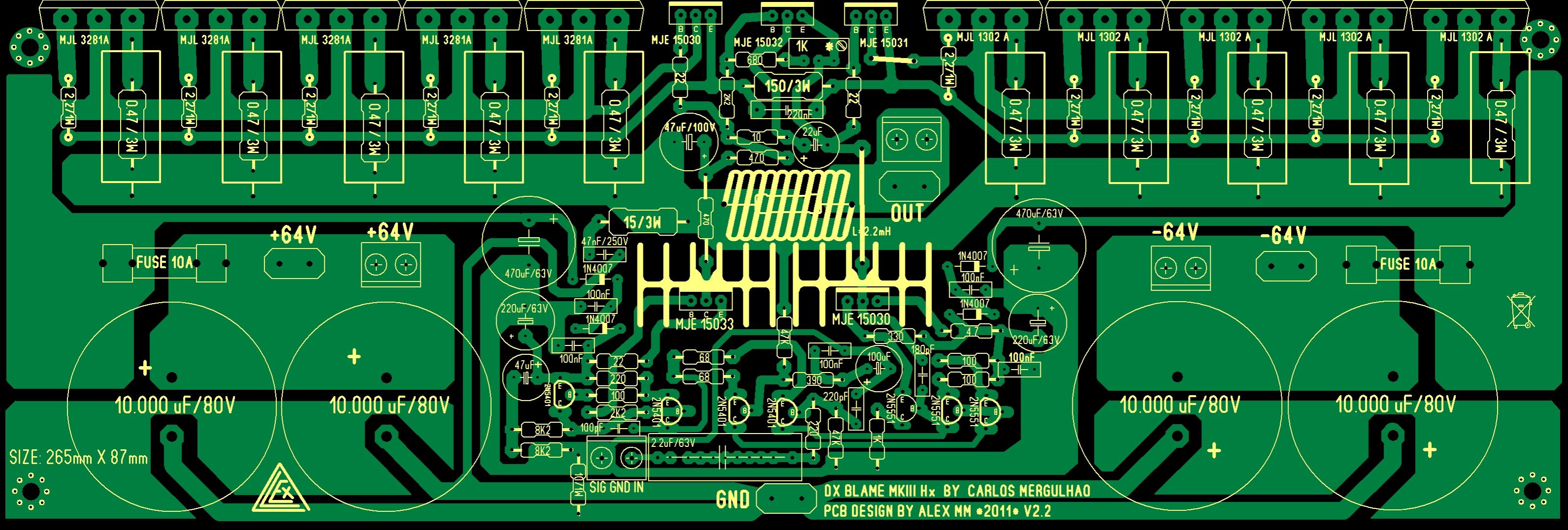

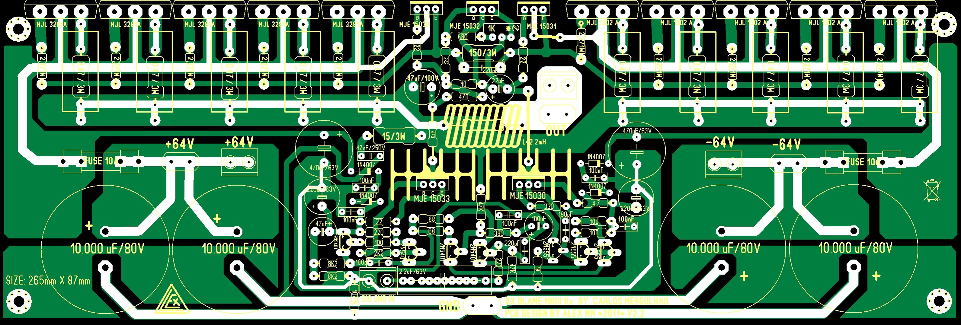

more images
Board size is 266mm X 90mm. The picture on the right shows the soldermask in white. The long tracks are for tinning.

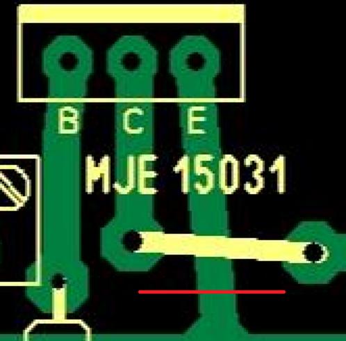

Misalignment?
I'm sorry Carlos, what misalignment? This looks good to me! I carefully measured all the transistors to the edge of the board to be sure the transistors would mount nicely to a heatsink. In the case of the three MJE1530X transistors, there is ~2.6mm between the hole and the board edge. Yet there is also ~1mm of copper-free space around the edge of the board to prevent accidental shorts. I had to make some transistor pads smaller to satisfy this criteria.
Are you joking, or do you really see a misalignment?
Not that important Byron...let it be.

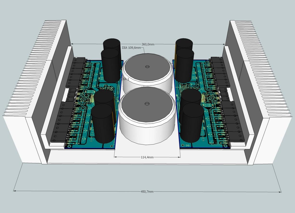

Look at the crew.... you have learned how to use Sprint Layout in three days!....you are a scientist from a US College....look at Meanman... he is with me since 2004.... a strong supporter and one of the earliest members from the Corporation... look at Alex mm... considered the best layout man in our forum...the best 3D man with us....all the best are with me..i have all reasons to be proud..... so...let the small misalignment be there...let it be... i will survive.
