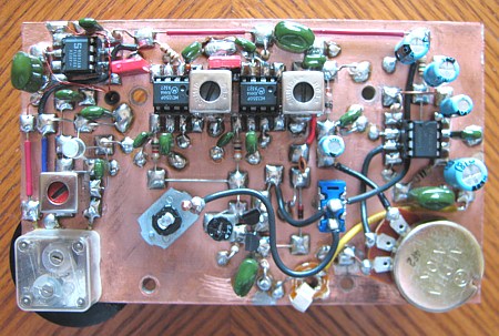

I'm going to build a non-oversampling DAC, thus in the same chip there are both analog and digital signals. Max clock frequency is 12 MHz.
A 4 layer PCB is beyond my capabilities. I'm in doubt between these two solutions:
1) A two layer PCB, the first is used as a ground plane on the components side, and the second is used to route connections between components; negative power supply route is connected in one point to the ground plane (as suggested by bob91343).
2) The second solution is similar, but all ground connections are directly routed to the ground plane (ground returns spread all over the board).
There might also be a third solution, mounting the components "Manhattan style", as many radio amateurs do to build their RF circuits (see the attached image). In this case there is only one layer, used as a ground plane and non-ground pins are soldered to small pads glued to the pcb.
Which solution is the best for my circuit? Are there other possibilities, given that the PCB has one or two layers?

Since DACs support circuitry is 80% analog, the technique in the image s/b more than enough.
Usually you can find good suggestions on grounding, D/A interface techniques, and even PCB layout artwork in high speed DAC data sheets. I suggest you go there first.
I would keep the solder side as ground plane, treating it as though it has 2 sections divided along the line dividing the analog and digital pins on the DAC, all the analog components above the analog side and all the digital components above the digital side.
Now you can route power and signal connections on the component side, place your decoupling caps as close to the power pins as possible and drop their ground connections through to the ground plane.
In some ways it is better to have the ground plane on the component side, but this necessitates many vias to drop the signal and power connections through to the solder side if components are SMT.
Look at all the ground returns and make sure none cross from the digital to the analog sections. This may be affected by whether there are separate digital and analog power supplies, and it will have a major influence on where you make the connections from the PSU to the board.
