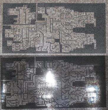

OK I've finished by PCB layout for the DAC im gonna build. This is largely based on MWP's DAC but substituting a differnt DAC chip.
So the basic layout is PCM2902 USB interface => DIR1703 SPDIF receiver => PCM1794/8 DAC chip.
Well as im a complete newbie to digital I basically just copied the schematic for the 2902 and the 1703 and then implemented the DAC chip as per TI's data sheets.
Anyway my main concern is grounding.
I have created three seperate ground planes around each section, a USB ground for the 2902 chip, a digital ground for the 1703 and digi side of the 1794/8, and an analogue ground for the analogue side of the 1794/8 and I/V stage.
So on the PCB I have three sets of copper islands around each different section all isolated from each other. My question is how do I link all these together? Do I run a separate feed to the star ground or do I link them together someway on the PCB?

Hmm...well, we're assuming I guess that the USB ground is total drek. (I think this is safe) If you have a TTL S/PDIF output from the USB receiver then I would be tempted to transformer couple to the main digital ground. I have never heard of people using transformers over such a short distance (inches) so you may want to wait for the pros to weigh in on this.
If your I/V stage output is balanced out then the analog ground should connect to the digital ground through a nice fat bridge under the DAC IC, preferably along the division between analog and digital circuitry in the die.
"tiroth" gives good advice. Join the grounds ender the DAC with a fat piece of copper - 10mm is good.
Joining the ground for the 2902 can be done with a wide strip under the digital signals that go between the sections.
Think about ground return currents. Every digital signal has a return current and it's best to make this go the shortest distance.

OK i have taken a pic of the copper top and bottom so you can see exactly how I have done this. If its complete trash then say so, I have made an active xover board like this and it works superbly. But if you think it will be OK then thats good too. This is already the second attempt at the baord design (the first one was for SSOP, until I realised that might be a bit ambitious so I made is DIP) so I dont really want to go about designing another one.
Mmm,
Does not look too well to me. Seems the current loops will be quite big, since the returnpath is not directly under a trace but has to go all the way around. There should be ground under a trace to provide the returnpath. In that way you know where that current will go and you need to make shure there are no other currents near. Now all will go through same ground.

guido said:Mmm,
OK im not really understanding this term return path etc what exactly is this all about. I was of the understanding that the ground was a refernce of zero volts for things to work from and was there for dumping of current.
What do you mean by the return path is not directly under a trace? but has to go all the way around, ground under a trace to provice the return path.
All the way around what?? to get from where to where? Im sorry if this seems a really obvious question but im completely lost.

You dont dump current into ground and then it is gone. It will continue to flow towards the originator of the current closing the loop.
If you have a groundplane, you know where that current flows: under the trace from sender to receiver. Without it, it will flow in the groundtrace you have made around the edges of the pcb.
As will the currents of all the other signals. Result: interference.
So all the way around from receiver of the signal to the sender.
Think loops, not just current from A to B

No there is no ground plane. I have simply made copper islands around the empty free spaces around the circuit then joined all the places that require grounding in the circuit, to a place on the copper island.
If you are refering to a ground plane as one layer of copper is dedicated to ground then that is simply not possible for me to do, I need the two layers to connect it all together.
I intend on joining the top and bottom copper islands together via pins or something.

My DSP pcb (see the story) was also connected according to schematic. Did it work, well eh most of the time
After all your constructive criticism and an email from Peranders it got me thinking that ive not really had a good word about the way ive done this. Having looked at something PA linked me to it got me playing with my PCB layout program. Needless to say I remade the grounding scheme on the PCB
What do you all think of this one now?? Better?
Green is copper top, red pink bottom.
Some traces seem to be on both layers ??? (ic under at the left)
Try to get as much traces on one side (bottom) and then ONE groundlayer on the other side (top)
If traces need to cross, don't interrupt the groundplane, but use a wire (depends a bit of the traces you are routing, for fast signals you don't want to interrupt the groundplane underneith such a trace (if it is not interrupted, you know where the current

It seems some traces are crossing the boundaries, going from one groundplane to the other, the return current has to go a long way.
But it is getting more difficult now to give comments,
since i don't know the design.
Seems the chip in the middle is a dac (?). Make shure
agnd and dgnd are connected at the dac.
