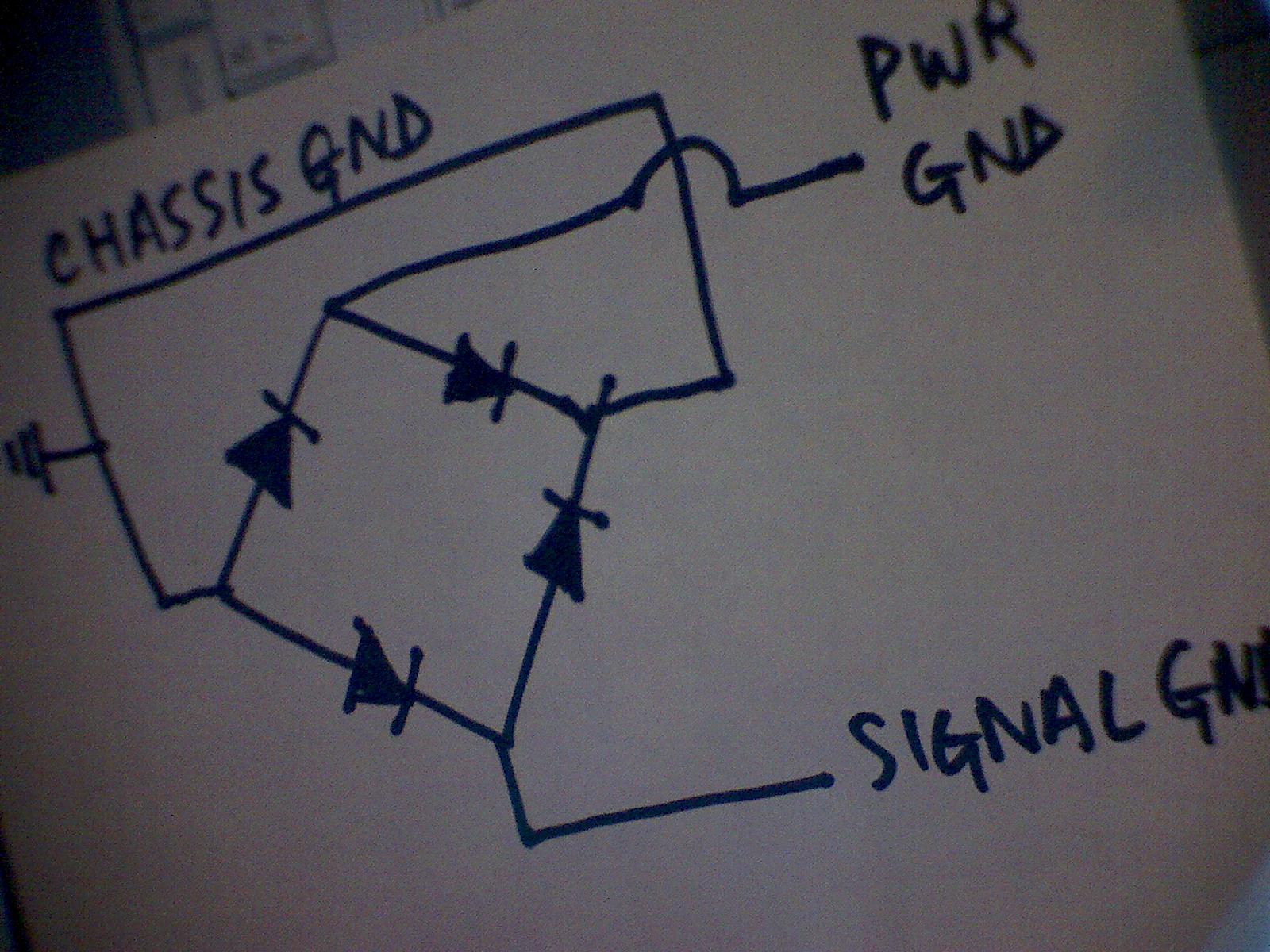

hm..... you got the point most of it correct (of my situation), but mine is not bridge rectifier. I have some picture/diagram in the another thread (just look at the picture is enough though)
MY reservoir capacitor's capacitance is super over powered....... 23.5MF. I only know its too big after i saw other article about it, but nothing bad comes with better ones ?
Currently, my PSU's chassis ground (main earth ground connected) is isolated from every other thing, maybe i will test it next week (not available to experiment and build things),does it necessary to have connection from rectifier to chassis ? And the third one i already have, but my amp currently is not enclosed for testing and rectification. (spare a wire already)

Hi
you are showing me a picture of a surface mount component looking like either 0805 or 0603 resistor or capacitor suggesting it can somehow substitute or work as a bridge rectifier.
It can't, you need to study power supplies. a bridge rectifier is 4 diodes arranged to rapidly switch an AC signal, without a rectifier you cannot achieve DC - your power supply by all intents is delivering AC,. to an amplifier designed for DC.
take some time to study power supplies they are a simple but very serious side of electronics.
Cheers / Chris

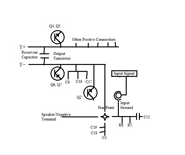

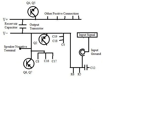

I'm showing the transformer configuration is layout (not the first 3 picture, further down)

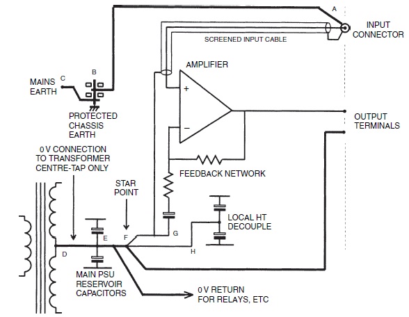

nono, it is really an DC, try to see this (the second picture)
I agreed that bridge is most of the time better, but it required another 2 diode (i don't have the same exact diode here, but i purchase the 40A bridge yesterday, use that ?)
