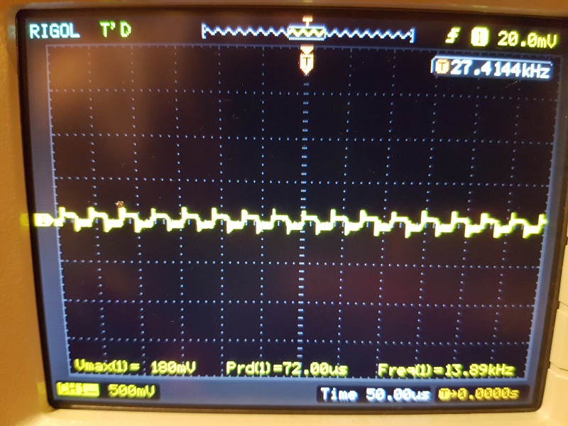

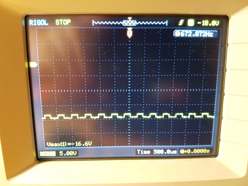

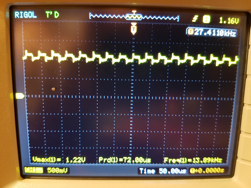

I replaced 21844, all parts are soldered in except output transistors.

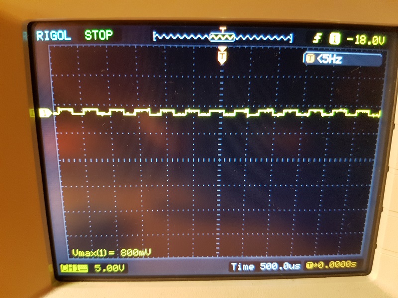

This is the output low-side gate:
But the high-side gates are without drive signal (both banks). The drain have positive rail signal.

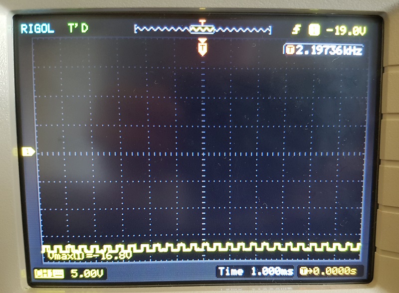

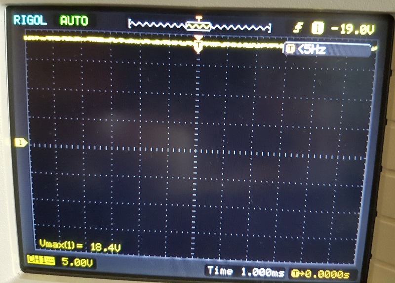

The picture of the drain
Or there will be no high side drive signal, because there is no carrier/oscillation?
I did not supply 21844 high side with 9v battery. Thats why there is no high side drive signal... For those who dont know how to do it and also reading:

The high side supply is generated by the pulses from the output transistors. Since you're testing with the outputs out of the circuit, there will be no supply voltage for the high-side drive circuit. Pins 11 and 13 are the supply pins for the high-side.
Connect a 9v battery with the negative terminal on pin 11 and the positive terminal on pin 13. I'd suggest inserting a 1 ohm 1/4w resistor in series with the battery in case there is a problem that tries to drive voltage back into the battery (or any other problem that could cause the battery to overheat).
Drive a signal into the amp. If you drive the amp with a strong 100Hz sine wave, you should see a 100Hz square wave on the gates of the high and low side FETs. The square wave should have rising and falling edges that are essentially perfectly vertical.

Just removed output chokes and i didnt found any visible shorts, soldered them in and secured with e6000.

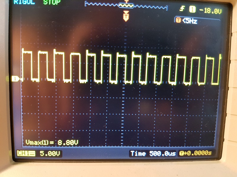

Here are the pics from high side and low side, all 4 bank drive signal looks the same. Scope probe set to 10x. No transistors and capacitors connected.
Is that the only part you have or are you trying to find something that you can use so you don't blow the correct FETs?
I think I'd remove the rectifiers and check the drive signals with the output FETs installed. The loading of the FET gate capacitance will affect the drive signal. The full load of the correct FETs is better than testing with a partial load of FETs.
