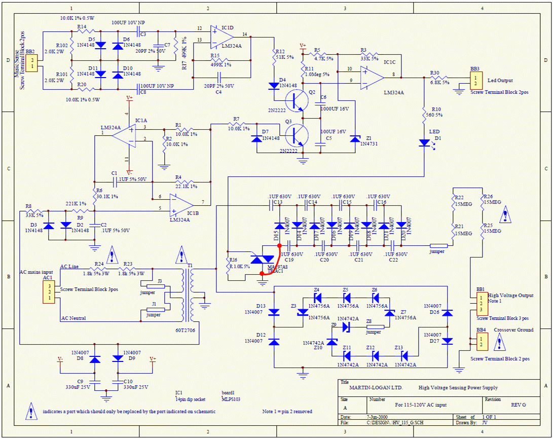

Now i have put the SL3 power supply up i no you have this but i would like you to look at this an tell me how i can bypass the turn on an juSt say on all the time ... it looks To me like the switch is just the bias 0...When the 0 in it truns on... can you give me some input....thanks
  • sl3powersupply120v[1].pdf

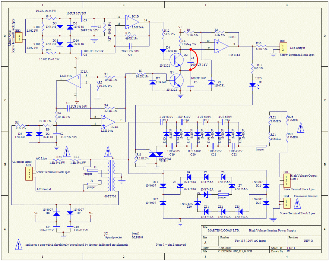

There are many ways to force the SL3 bias supply to stay ON. Here are two.
1) Solder a wire as shown to bypass the TRIAC switch. The bias supply will stay on. The LED will still turn on with applied audio, and turn after 15 minutes or so after audio is removed.
2) Solder a wire as shown to short out C6. The bias supply and LED will stay on whether or not there is audio applied.

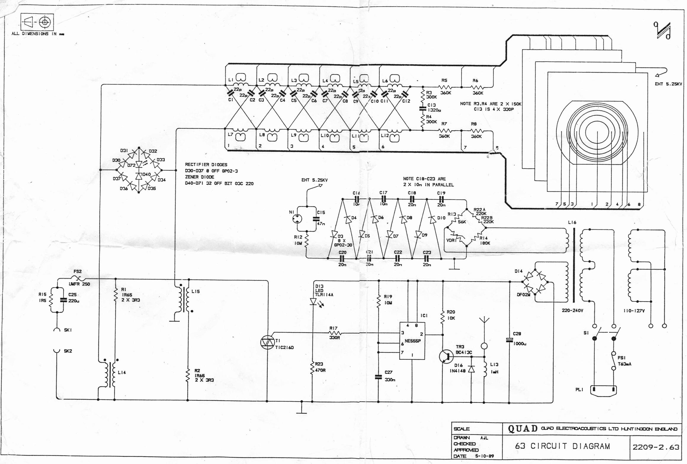

Quad grounds the CT secondary and the core as well. The primary is left floating.

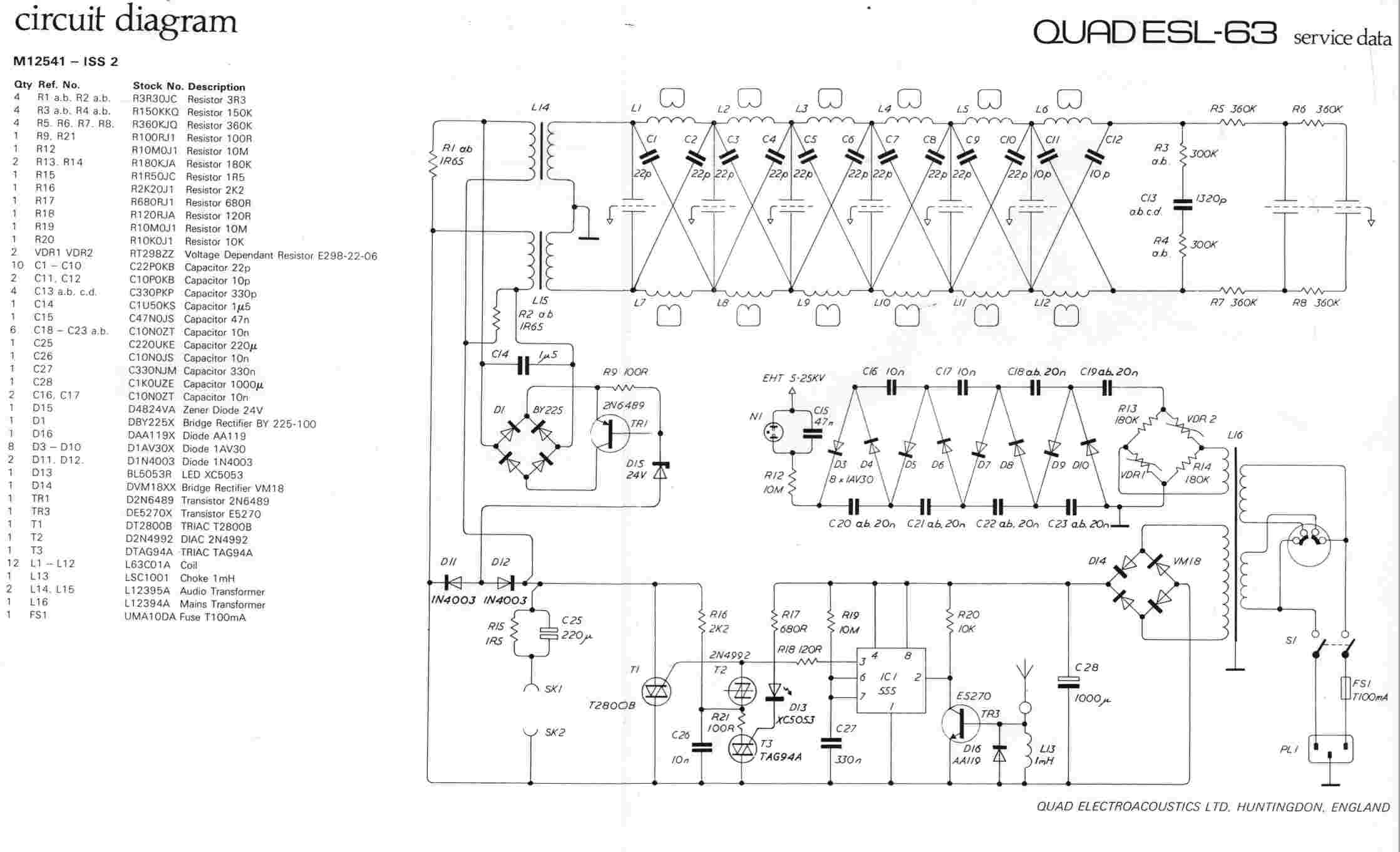

Yes, the original Quad ESL and the early versions of the ESL63 connected the secondary CT to safety ground.
I have always wondered why in later versions of the ESL63 the connection to safety ground was removed, and the secondary CT was connected to the primary.
Attached are early/later schematics of the ESL63 to illustrate this change.

I don't know the answer to that. But I'm willing to take a guess.
In the older models the high voltage section (stators, EHT) is referenced to safety earth and the whole input section, including spark detector, seems to be left floating (or actually referenced to whatever the amplifier is doing). Perhaps there were problems with the reliability of the spark detector? It seems preferable to have the spark detector referenced to the high voltage section in a predictable manner, not just by parasitics and whatever amplifier is hooked up.
In the later models the input section and the high voltage section are referenced to the same internal ground. Which means connecting it so safety earth would connect one of the speaker input terminals to safety earth. Not all amplifiers are going to handle that gracefully so that might be the reason to keep the whole speaker floating?

Thanks for the Quad info...looks like thay were using the {limiter} way back whin...What is that a NPN..PNP..no fet??...an how about that Cap..1.5uf
nothing is new....
Power BJT technology was much more mature back in the 60s than power FET. I'm sure that weighed in to the decision to use a BJT device for the limiter rather than a MOSFET. Most likely the 1.5uF cap is there to filter out the voltage transients from when the NPN transistor attempts to turns OFF after limiting a voltage peak.
