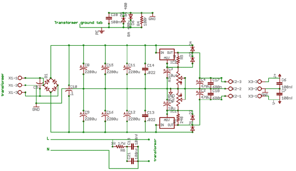

The current PSU

Nordic said:
The current PSU
I have some suggestions that might improve your supply, some of them from the datasheet itself:
1) Put a smaller cap at the output, like 100uF. See if the audio quality improves. If it does, then change the .680uF caps for .100uF film types.
2) Put those 470uF caps to filter the adjusting pin, in parallel with the trimpot. You will have to put protection diodes there too.
3) See what value the trimpot is and swap it for the closest 1% resistor value you can find. A resistor will not change value, while a trimpot can.
4) Add two series 1ohm/3W resistors between C15/C11 and between C16/C12. That should clean a bit garbage from what's going into the regulators.
Remember that capacitor quality may be better than capacitor quantity. High temp and low ESR seem hints that a cap is a bit better and may improve things for you.
Some may change the diodes too, but others may not think so. If you can (and want) try faster types: fast/slow or Schottky.
Hi Carl, I have only 1 trimpot, (the other died and was replaced with a metal foil resistor like you said)
Also, the board has holes for the series resistors, but I have not bought em yet, as ppayday is 2 days away... they are just jumpered right now, I will try upping the cap in parallel with the resistor from 10uf to 470uf... I just went with 10uf as that is what the datasheet suggests. the output was 10uf, but on the problematic circuit the larger cap was better.
Regulation is pretty good, if I bypass the output relay, I can not even hear when I flick the power switch on and off , while it keeps running off the caps...
Tommorow I want to strip it back to 1x 2200uf before and 10uf after regulators and work my way back up...
Don't need to be metal foil. Just precision metal type.
What board is that? It's unusual that it has holes for series resistors. Good!
Yes, but noise will be much be better if you filter the bypass pin. Try it with the pin bypassed and just 47uF to 100uF at the output, and see what happens.
Which output relay? The supply has one? Why? You don't need it. Relays shouldn't be used in regulators, except at the input.
That's the way to do it. You probably won't need more than 2200uF, but you may need another one for a better RC filter.

The PCB I made for the PSU has the holes...
Also had some extra .1uf caps for bypassing, but I think at the time I had too much flux left on the board... as they arced over, so I removed them temporarily...till I can go the shop again...
There is a relay on the output of the preamp to prevent it from playing on on the capacitors... well it does, but the signal is prevented from reaching the amplifier after it.
I suspect I won't get away with les than 2 of the 2200uf caps, they were very cheap, and not nearly as big, tall and nicely finnished as the phillips caps I got last month... will reorder a packet from the UK... only have one left.
You mean too much solder? Please remove it if you can, except if the copper path is too thin, which might make things worst. Solder flux can be capacitive, so clean it after all it's done. Use quality solder.
What solder pen size are you using? Get yourself a 30W one and be quick to solder. If the pcb is arcing you may be overheating your components, which is very bad.
Remove that relay if you can. In fact, if your power amp has an input capacitor, try removing the one at the preamp's output.
Where you should have a protection relay is at the poweramp's output, to prevent it from sending DC to the speakers if it fails.
What brand are them? If they are Philips they are good, others who knows?
I suspect I need to remve the transistor sockets.. very hard to get the BD transistors in there... more likely the problem than cold solder...
Transistor sockets? That explains it. Of course you must remove them. They are good just for comparisons, then solder the part.
