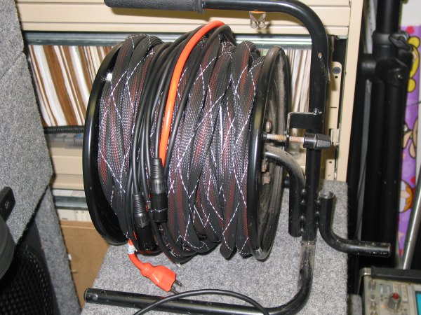

ps..for the summer app, I just made my own snake from the stage. it carried the stereo feed to the stage in one mike cable, I was not too concerned with channel seperation at 10Khz...and it had one microphone cable to the mixing rack.

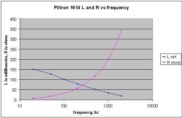

Here's the plitron info.
It is a #1614, 225 va, 50 hz, there's also the number 067014011 on it, whatever that means..
Ran it from 20hz to 2Khz..boy, don't know what the core is, but it hits the skids awfully fast.. I think it may have been designed to also filter stuff out..
Here's the plot. I used one of the secondary winds, and was also suprised at how fast resistance climbed. I'll have to unwrap one to get the wire details, guage and turns..
Cheers, John
ps..don't forget, R increase is certainly not consistent with the skin effect exponential approximation equation. One must always consider the flux environment the wire is in, as the core proximity will affect the wire's current distribution profile..
Cheers, John
