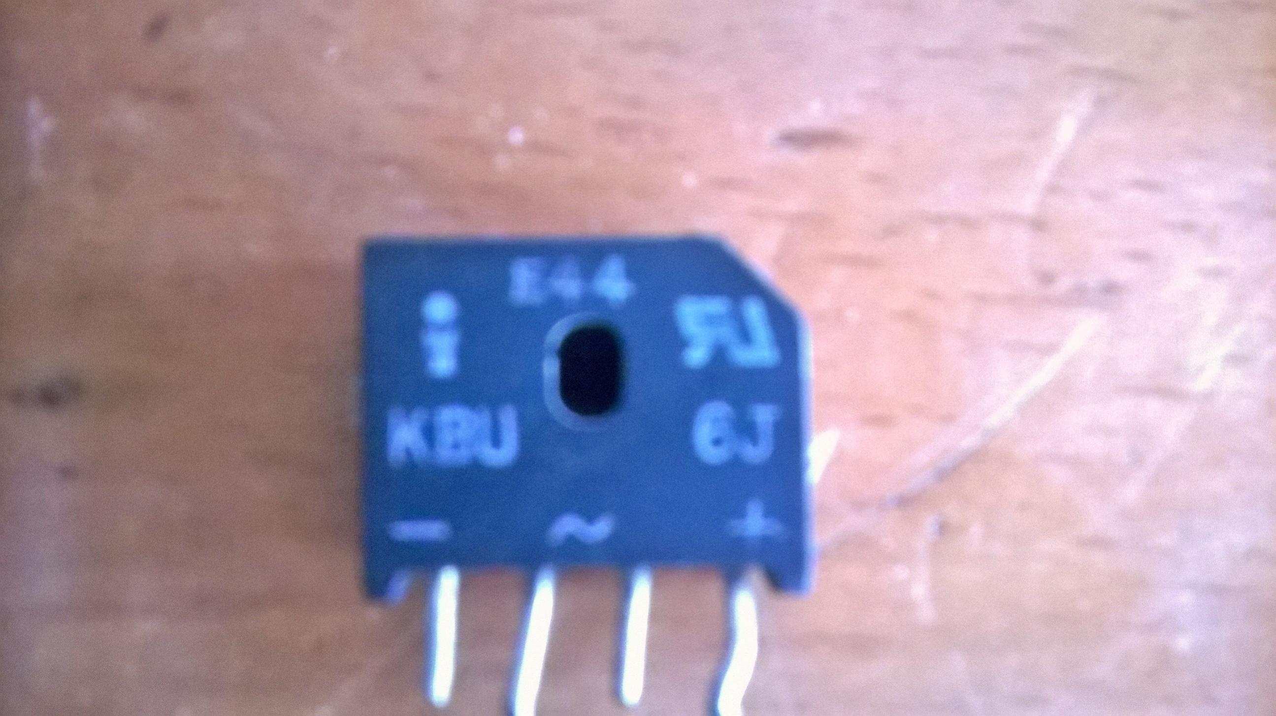

Thanks Osvaldo & Andrew. Will be enough 6A bridge rectifier in place lf 35A?
test it !
It may have to pass upto 10kA.
That's the rating of the MCB often fitted at your mains distribution board.
Mine are rated at 6kA, some are 5kA
They are rated that high because the mains voltage into a shorted Live line can pass Fault Currents that approach these values in domestic installations.

you have clearly not understood Fault Current when a mains wiring fault conducts to the PE protected enclosure.
Have you read my report when I tested a DN to check that it survived longer than the fuse during such an incident?

The bridge needs to survive the fault current for long enough to trip the breaker or blow the fuse. A 35A bridge may survive a few 100A for a few seconds, which should be long enough. A smaller bridge would be fine if you could guarantee that it would fail short circuit, but I suspect that you can't. In fact, I suspect that for most purposes people would prefer a rectifier to fail open circuit so that is probably what they often do.
