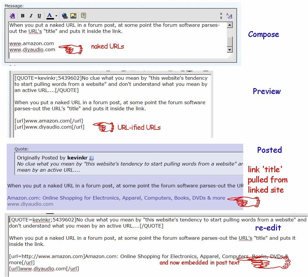

On a side note, is there some way I can shut off this website's tendency to start pulling words from a website, when I have even asked the website to make the address an active URL? Very annoying.

No clue what you mean by "this website's tendency to start pulling words from a website" and don't understand what you mean by an active URL.
This isn't any forum behavior I am aware of, but you should report it in the forum problems forum.
What OS, browser, ad blocking software and anti-virus software are you using? (Include in your report)

I had no clue what he was talking about, what you point to is a forum software behavior (feature) that goes back a long time. There are ways to trick it into not doing that. (Edit: those tricks no longer work)
We are migrating to xenforo relatively soon, this annoying feature is unlikely to be addressed. :D

I re-edited with a picture while you replied.
Yes, I know the "title grab" goes WAY back, and in fact is usually preferable to those gross over-long naked URLs that blow-out the right side of my monitor. And know we are moving soon.
Hogwild: a (tedious) trick is to manage the tags yourself. Type a normal sentence. Highlight the word/phrase you want presented as a link. Click the "world-chain" icon above the compose box, it asks for a URL. Paste your url. It displays like:

Note the link does not shout the linked-page's title.
The underlying code (but [] changed to {} to avoid parsing) looks like:
I just bought {URL="https://www.amazon.com/gp/product/0934041113/ref=oh_aui_detailpage_o00_s00?ie=UTF8&psc=1"}this book{/URL}
