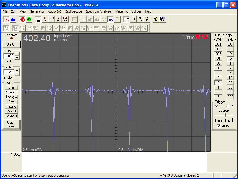

I am running a Supratek Chenin preamp which I have modified to use a cascoded IXYS 10M45S CCS on the plate, Cree SiC Schottky Diode bias, and single 2C22 output tubes in a parafeed-type configuration, replacing direct-coupled 6SN7 output tubes (too much gain!). Output transformer is a Lundahl LL1674 and Parafeed cap is 0.56uF. The CCS has 1k gate and anode stoppers already installed.
Here's the problem: I am currently installing the Lundahl x-former and am measuring its effect using TrueRTA on my Laptop. When I ran a square wave through the preamp I saw pretty severe ringing on a the leading and trailing edges of a 1kHz square wave (first plot below). There was no grid stopper stock on the 6SN7, but the 2C22 tube has the grid as a top cap, so it needs a longer lead to reach the cap, which is probably exacerbating the problem with stray inductance compared to the 6SN7.
I have tried a series of carbon comp resistors soldered directly to the top cap; plots 2 and 3 below are a 55k and a 79k grid stopper, and in the next post plot 1 is a 100k and plot 2 is a 150k carbon comp - they do decrease the ringing quite a bit.
Calculating the -3dB point using the Miller capacitance of the 2C22 shows a -3dB point of 21kHz with a 100k grid stopper. Based on that I'd rather go with the 79kohm resistor, but there is still some ringing on the trailing edge of the square wave.
The question is: How much ringing is acceptable? I'd like to eliminate it altogether, but not at the expense of frequency response. Any advice is greatly appreciated!

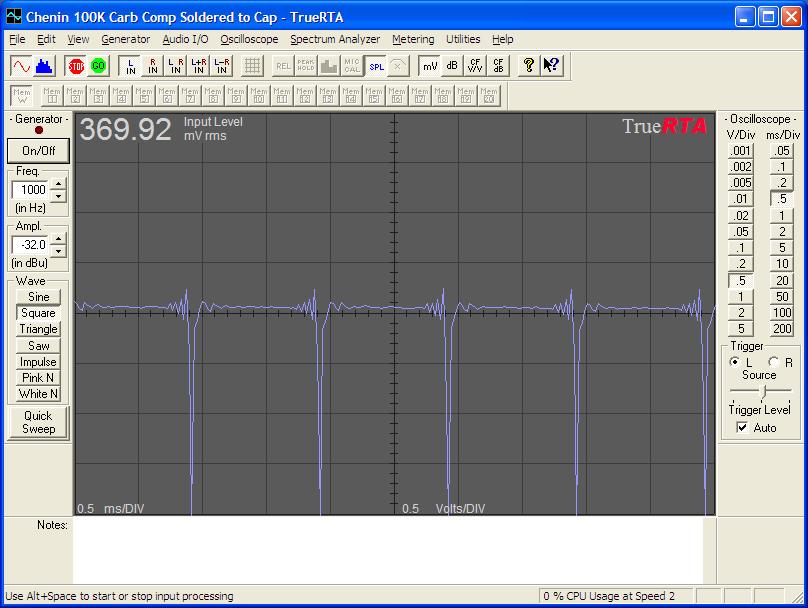

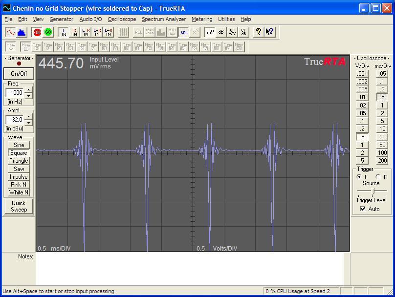

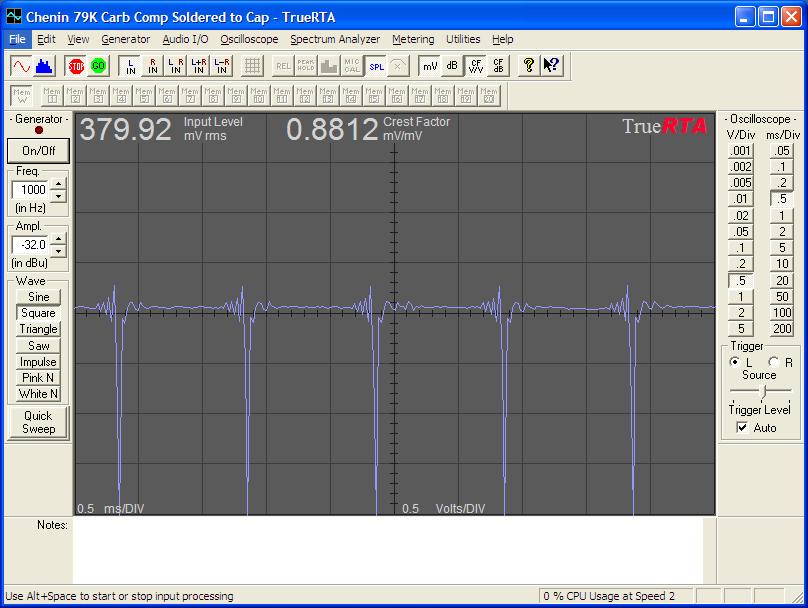

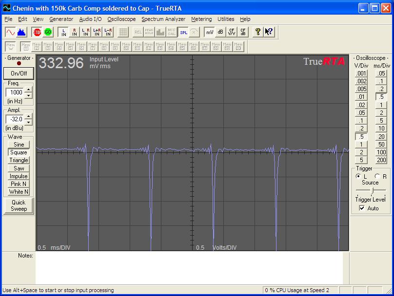

I tried 1k carbon comps on the grid and they did nothing. I needed to get into the 10s of kohms to see any effect at all. Once in that range, they do seem to stop most of the ringing, and the frequency response still looks very good from 20-20kHz with up to a 100kohm stopper. If the issue is with the transformer, why do the high value grid stoppers seem to work?
I intend to look into lead dress as well - the Supratek preamps are a bit "disorganized" in terms of their point-to-point wiring. They sound very nice, however!

First and biggest problem- you're using the wrong tool to measure. Doesn't it strike you as odd that the transformer starts ringing before the impulse?
This is one where a good old fashioned analog scope is the right thing to use, with the source signal coming from a function generator, not the sound card.

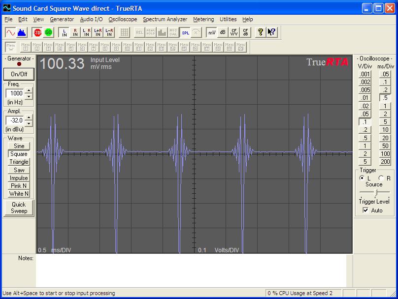

OK, I'm officially an idiot!
I ran the output of the soundcard directly back into the input, generated a 1kHz square wave, and voila!, the graph below resulted. It looks like the "ringing" I'm seeing may be purely the result of the crappy sound card!
Once I borrow the function generator and scope from work I will know for sure, but it certainly looks like the preamp is faithfully reproducing what I feed into it!

Are you actually seeing just the effect of an anti-alias filter before the A-to-D? This will produce ringing from any sharp edge, as the higher frequency components which cancel out the ringing have been filtered away. By adding a big grid stopper you are softening the edge, which gets rid of the ringing. So you may simply be seeing test equipment artifacts. Is your input signal clean, or does that have ringing too?
Let's assume for a moment that the ringing is really there, and would be visible with an analogue scope. The most likely cause is the output transformer. The solution is to damp down the resonance with a snubber, not ruin the frequency response of the whole amp.
If you want to reduce the frequency response, then large grid stoppers is about the worst possible way to do it as it makes the amp response depend on the details of the internal capacitances of the particular valves you happen to have installed.
Stubs and standing waves etc. may be relevant to the true purpose of a grid stopper (stopping VHF/UHF parasitics) but these have nothing to do with audio. Nothing magical happens with a 377 ohm stopper!!
I suspected as much. With propper gear you mentioned you should be getting more meaningful results. Now remember to read the other part of my reply (regarding the ffects of application of LF filtering to square wave signals) before jumping the gun and blaming your transformer once again

You are measuring your soundcard response, or whatever it is you're measuring. The pulses (you did not mention anywhere what you are measuring or what the signal source is, other than "square") show ringing characteristic of the sinc(x) function, which rings before the event, a "nonphysical" response. This is typical of sharp filters, like the high order 20kHz lowpass used in sound cards.
Grid stoppers are only intended to address MHz band oscillations, primarily a concern around high transconductance RF tubes. Oscillations in the 100kHz band are due to poor wiring methods, and grid stoppers are not likely to address problems there. Oscillations in the 10kHz band are even further removed.

Reducing the HF bandwidth of the stage driving the transformer to control ringing in that transformer is not the best thing to do. A snubber across the primary could help, OTOH audio signals are not square waves and getting carried away with damping the ringing may be overkill, and arguably it isn't necessary at all in 0 fdbk applications. Doing so may or may not improve the audible performance.. Make sure that the transformer is loaded as it would be in use before applying any networks to tame the remaining ringing.
A small grid stopper at the grid cap of your 2C22 is appropriate from a stability and EMI standpoint, 1K is more than adequate, and smaller values down to 220 ohms or so are also effective.
Thanks, Kevin.
So soldering a 1kohm Allen-Bradley carb comp resistor at the cap may still be a useful step in terms of EMI rejection and stability. Are you a proponent of carb comps in this position, or do you prefer another resistor type? Carb comps are non-inductive for sure, and since the current is negligible shouldn't contribute much noise; on the other hand they are not very temperature stable and can pick up moisture. Something like a Texas Components Z-foil resistor also has very low inductance, but is extremely temperature stable to boot - at $10 each they are pricey but $10 is not so bad when I only need 2 of them. What do you think?
