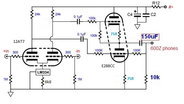

Grid resistors -> GND
Sure - see attached
Looking at the schematic I think the problem is that the dc conditions for the output tube are set by the plate voltage of the right hand input tube which is directly connected to the top grid of the output tube. So I would suggest you add a capacitor between the right hand input tube plate and the 100K feeding the grid of the top tube and then measure again.
Cheers
Ian
Incredible! Ian, I think you've found an error in Broskie's circuit!

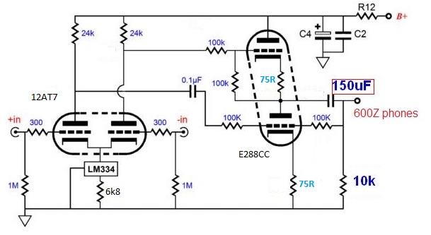

So, you mean install the capacitor as per this diagram (attached)?

I've verified the fault in the circuit. After installing the 0.1uF capacitor as suggested, I re-measured the plate voltages and have 102 to 103 volts across all four plates of the E288CC!
With a 75R bias resistors, the bias is 2.2v, so by my calculations this is running at about 30mA - does this seem correct?
Ian - you have broken new ground my friend!
OK< looks like we are getting closer. 30mA at 100V is probably too high as it represent 3W of dissipation per anode. We want to be nearer to 20mA. It seems I misread the data sheet. For 20mA at 100V we need 2.5V of bias not 1.5V so the cathode resistors should be 120 ohms rather than 75. Try 120 ohms and measure again.

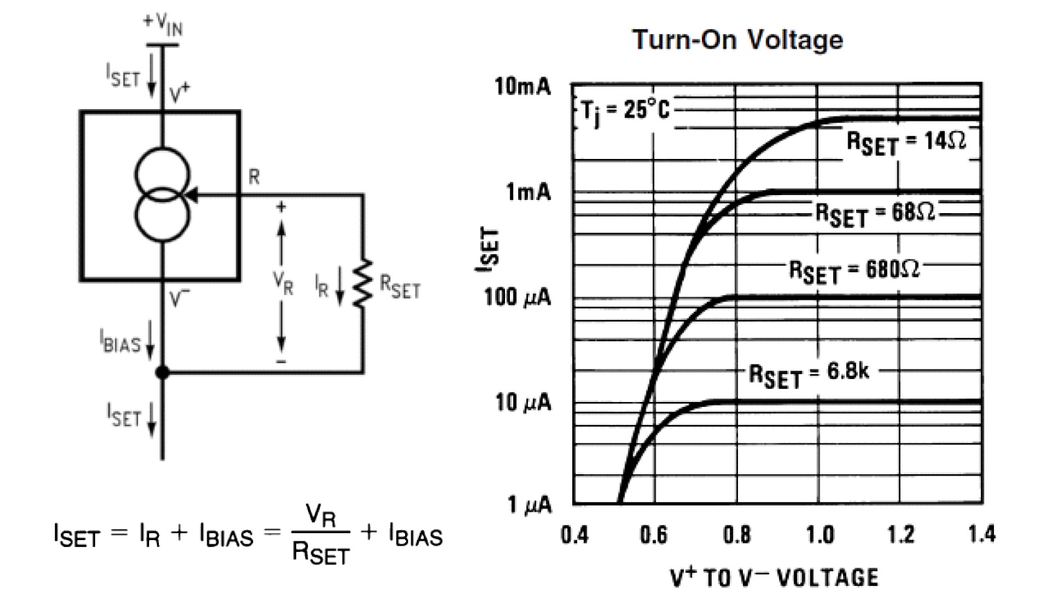

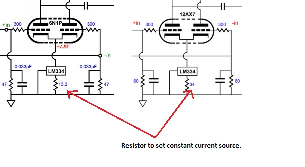

You can see below two example circuits that Broskie gives for I/V stages. I've highlighted the resistor which sets the constant current source (the IC is LM334). He selects 34R for 12AX7, 13R for the 6N1P. This would suggest he's using 1mA plate current for the 12AX7 and about 8mA for the 6N1P.
So, for the 6072A, which has a preferred plate current of 3mA, would the CCS resistor be more like 17R?

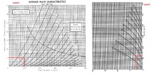

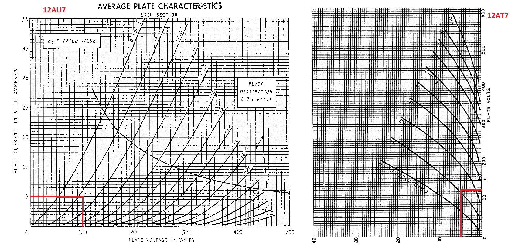

Ok well in relation to the linearity & gain, with the way I have it arranged at the moment, there is a constant current source of 5mA per plate in the gain stage.
So, from testing, a 12AU7 has 100v on the plates, about 2v bias, whereas a 12AT7 has 130v on the plates, about 1v bias. (see attached)
So in order to obtain best inearity with the current CCS circuit (without de-soldering), we need a medium/high mu tube which likes 5mA plate current with plate voltage of 100v to 150v.
Am I thinking along the right lines here, or is this incorrect?

Message from John Broskie re: "error in unbalancer"
I normally don't visit here anymore (I was the original poster of Buffalo and Unbalancer thread, the one with the Neohms ;) now gone... Anyway, someone pointed out this to me and I spoke to my friend John B.
He says:
Yes, the BCF pushes and pulls, but it does not generate its needed anti-phase signal, thus no reflexive, as it finds the required two-phase signals already presented by the input differential stage. Moreover, do headphones really need to go down below 2Hz? As for the missing cap, it is only missing if you need it. I assumed that some would need it, so I long ago added it to the PCB, as the schematic from the user guide shows:
(image missing)
As I scanned the forum, I note that the wrong input tube is being used, for example a 12AT7 or, worse, 12AX7, as these triodes will not develop enough cathode voltage for the CCS to work well. A low-mu triode, such as the 12AU7 or 6CG7, is needed. On the other hand, with a negative PS rail or with an LT3092, these tubes could be used. Yes, much hacking. "
