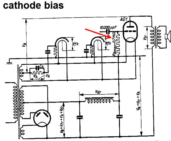

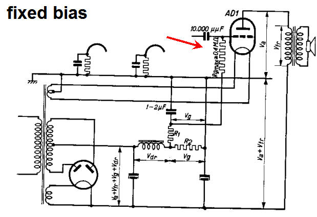

In post five I meant to say adding a resistor on the ground side of the choke. Is this actually a low pass? I mean the signal is not going through the choke. The choke is a shunt for the grid of the AD1 power tube. The AD1 power tube has -74 volts of bias applied in a fixed bias mode. It needs a path to ground. But using a lower value grid resistor would shunt too much of the AC signal from the second stage to ground. I think.

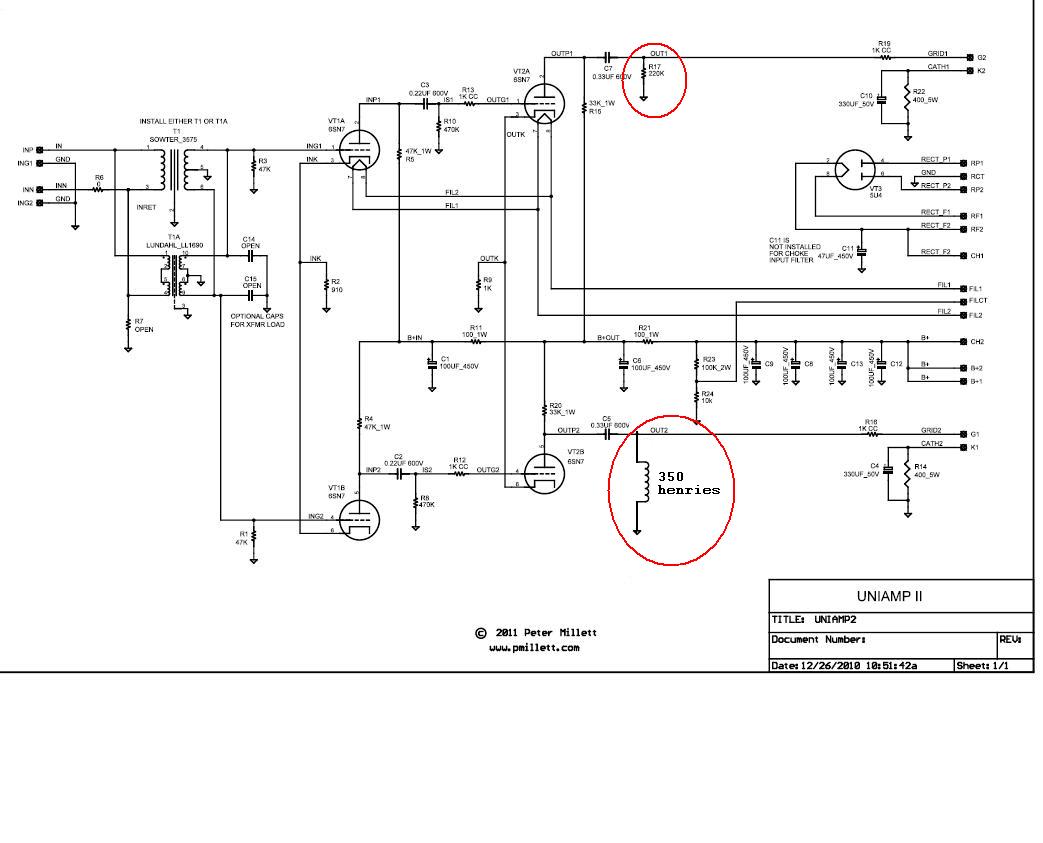

In one datasheet i found, it explicitly shows max grid leak resistor value is 0.4Meg in a circuit that use fixed bias on the AD1. If you're building that Uniamp2, the 6SN7 driver has only 33K plate load. I figured you can use 330K for the grid leak, not needing any grid choke. Am i missing something?
https://frank.pocnet.net/sheets/145/a/AD1.pdf
edit: Pete uses 220K grid leak, even better.
It's a high pass filter. Series resistor (the output impedance of the driver tube), shunt choke.
A low pass filter would have series choke, shunt resistor (or capacitor).

350 HENRY grid choke?
How many pounds does it weigh?
They're not big, because they don't have any standing current across them (at least not until the output tube draws grid current). Well, they are very big compared to a resistor, it's true.
