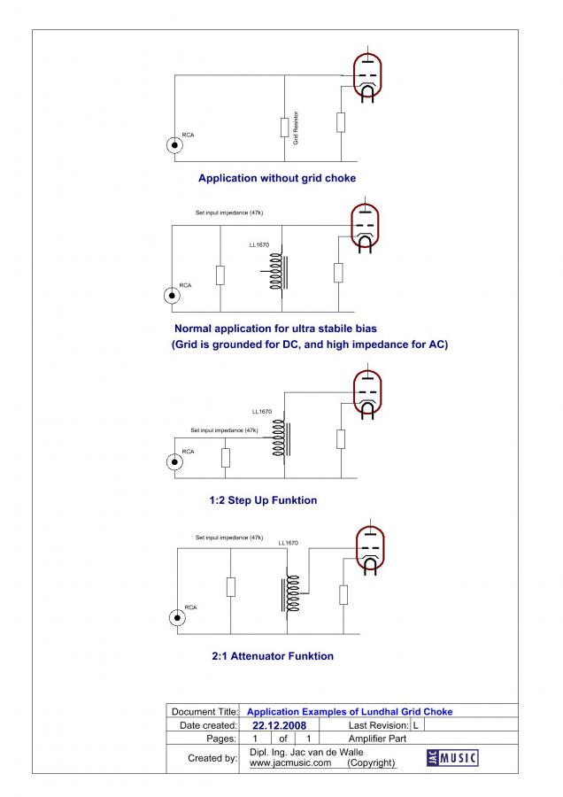

As you drive more current thru' an output tube then grid 1 current increases, this grid current develops a voltage across Rg1 which SUBTRACTS from the bias voltage. Thus you get more anode + Screen current and therefore more grid current which develops more voltage across Rg1 etc. If Rg1 is too high then thermal run away occurs untill the tube "melts". Thus each tube will have a max Rg1 spec. This spec depends upon whether cathode bias or fixed bias is used. With cathode (auto) bias this opposes the bias shift caused by the voltage developed across Rg1 from grid current. With fixed bias that does not happen and that is why max Rg1 values for Fixed bias are smaller than for cathode bias.
With 2 tubes in parallel and with fixed bias then the max Rg1 is typically 50K even thou' most manufacturers use 220K or so.
That is why guitar amps blow up about 10 times as frequently as tube HiFi Amps where proper attention to such things is more likely (but not guaranteed). If you have 10K grid stops then that leaves just 40K for the grid leak back to 0V via the bias supply.
The common 12AX7 phase splitter would have a hernia trying to drive that so it is not done.
If you look at some old tube data sheets, take KT88 as an example, you will see that in fixed bias at 42W Anode + screen dissipation then max Rg1 is 100K. If you take the disspation down to less than 35W then Rg1 can be increased to 220K. This is the maximum value to prevent thermal run away of your output tube.
So for your average guitar amp with max Rg1 RECOMMENDATIONS violated/ignored then biasing so that tubes idle at around 70% of max dissipation makes good sense from both a reliablity point of view as well as tube longevity. I would use 80% of max dissipation as the absolute limit.
UNLESS
You use a good beefy driver (NOT a 12AX7) with low value Rg1
OR
A grid choke. The grid choke gives you lots of AC Impedance so as to not load down the phase splitter / driver BUT very low DC resistance so that max Rg1 values are not exceeded, that would allow you to bias the output tubes right up to the 100% dissipation limit without the large risk of thermal run away.

Man this is really extremely interesting reading.
Anybody got some relevant schematics to look at?
In the guitar amp I'm fooling around with at the moment, (see attached schematic) with 6 6L6 output tubes, how would such a "grid choke" conversion and conversion to bias pots (instead of "output balance" pot) ideally be done? Replace each of the two 33K resistors with an 8,000H choke and a pot? Or rework the circuit with a choke and pot for each output tube?
In a guitar amp, you're looking for a "sound" and this is one way of tuning it. With RC coupling, the high pass function is a first order filter and thus has no peaking in the frequency response. Now, convert to chokes and you have a second order filter which can have a wide range of response depending on how you choose the values of C, R, and L. A big peak and the resulting whomp (i.e., a high Q at the cutoff frequency) is a disadvantage in a tube amp, but may be what you're looking for in a musical instrument amp. Likewise, a very low Q and some slow LF rolloff may be useful depending on what you're trying to get for a sound.
This is one where I'd spend some time with a simulator juggling values to see the effects on frequency (and hence transient) response.
With a sufficiently beefy driver stage, a grid choke would allow you to stray partway into Class AB2 mode - you could draw some grid current on peaks without upsetting the bias too much and getting blocking due to the coupling cap getting charged up. Think of it as a poor man's transformer drive.

Back to my question about the parallel tubes on each side...would I need just one grid choke for the push side and one grid choke for the pull side (to ground, instead of the existing 33K resistor) and leave the individual 1500 ohm resistors to each output tube's grid? Do I 'tweek' with resistors for similar but hotter bias current (compared to stock)?

I assume that you refer to the schematic of the Super Twin.
First one remark: the 33K are going to the bias supply not to ground.
To your question: You can use one choke per side as long as you don't want to adjust the bias separately for each tube (pair).
My experience: If you want to go for a bass amp (no guitar overdrive usage) I would insert additional MOSFET follower as driver directly coupled to the power tubes, This has the advantage to enable real AB2 operating mode.
You're right, I'm wrong. Yes, the 33K, thru some other series resistors and caps to ground, is from the 60v AC bias secondary winding that's half-wave rectified.
So where would a grid choke go, in the supertwin schematic I posted? Replacing those 33k bias resistors? Will the 'standard' grid chokes handle the bias current of 3 6L6 in parallel? Do I still 'tweek' the circuit with resistors to achieve some bias spec? There's no spec for current or voltage at the grid in the schematic. Can I still use a small pot on each tube for individual bias adjustment?
