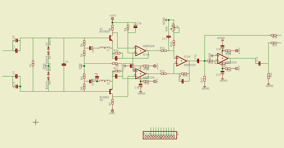

Green Pre board - modular
I am building a new preamp for my studio, so I made a new board for this pre which has pin connectors to allow for different base-boards and even different kinds of premps.
So please comment on my design, especially possible ground loops and other power-related problems.

My Eagle took kubeeks files ( .brd and .sch )
I did a Screen Capture & here is the schematic ( 7 kB .png )
So ..... Comments for kubeek's work, Please! :)

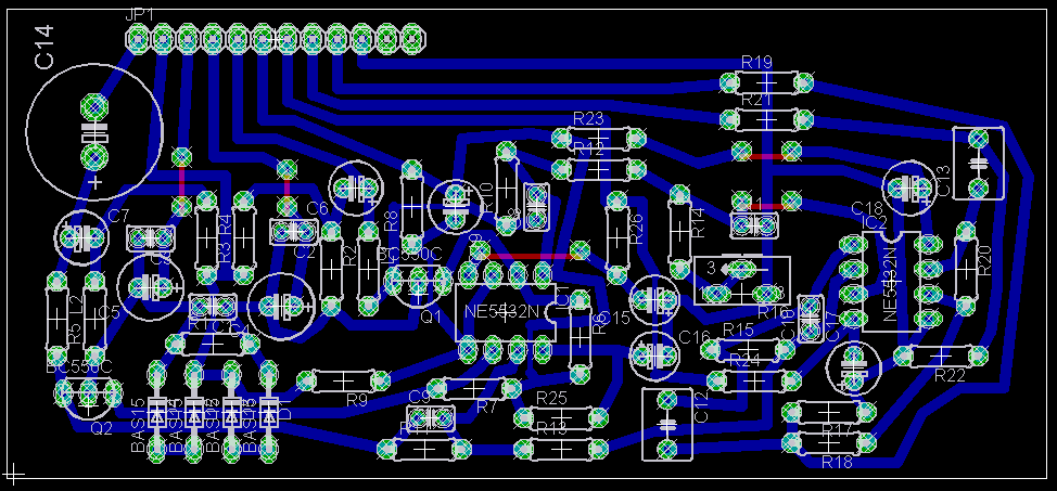

This PCB screams trouble on top of the lungs - there is so much stray capacitance and inductance on it that you can easily turn it into wide-band transceiver.
Kubeek, search the forum and look at the works of the more experienced members - you'll learn a lot ;)

Schematic.
The positive end of C14 is not connected to anything in the schematic. Agnd symbols are incorrectly oriented. The connector is not connected to anything. Labels are superimposed and illegible. Inputs and outputs are not clearly indicated.
This makes it a bit difficult to evaluate the PCB.
PCB
Silkscreen lables are illegible. Tracks are higgledy-piggledy and unmitred. Ugly.
It's better to keep inputs away from outputs and away from power connections if physically possible. This also makes for a sensible signal path. Not that I'm saying yours isn't, it's just a lot of trouble to go through it component by component especially when you can't read the labels.
Try to keep your tracks horizontal, vertical or at 45 degrees. This is just good practice. Mitre all corners where possible. Never create an internal angle <90 degrees. Look at any motherboard...
65/100

Thanks for all the input, now to the details:
The in fact are connected, but to make the schematic readable they are only connected by nets, not visibly by wires.
Silkscreen lables are illegible are just how they came after placing the components, they are not meant to be printed on the board yet.
I understand it is hard with that (no) labeling, so I will try better next time.
Why not <90degrees angles? And why there should be only multiples of 45?
It seems to me that any angle will carry current, which is the main concern.
Re: Re: Re: Re: Re: Re: Green Pre board - modular
Not on the schematic I saw. Am I supposed to guess?
I need to see the labels so I can tell which component is which.
That is the main concern. Your board is probably quite useable, although to be sure I would prefer to be able to see how close capacitors are to their chips without a big effort.
Most PCB's are produced by chemical etching. Tight corners can trap etch solution even after washing and cause problems years later.
Keep lines straight or at 45 degrees. This will make angles <90 less likely to occur and encourages a disciplined approach which may be more critical if, for example, you need to route a 16-bit bus. If your lines are straight then the spacing is less of a problem. Miter corners habitually, it generally makes little difference below RF but again, it's a good habit to get into.
Be careful with your clearances when taking tracks between pins.
Look at a PC mainboard. This will show you the standard expected of a modern PCB layout person. It's not difficult to achieve with software.
