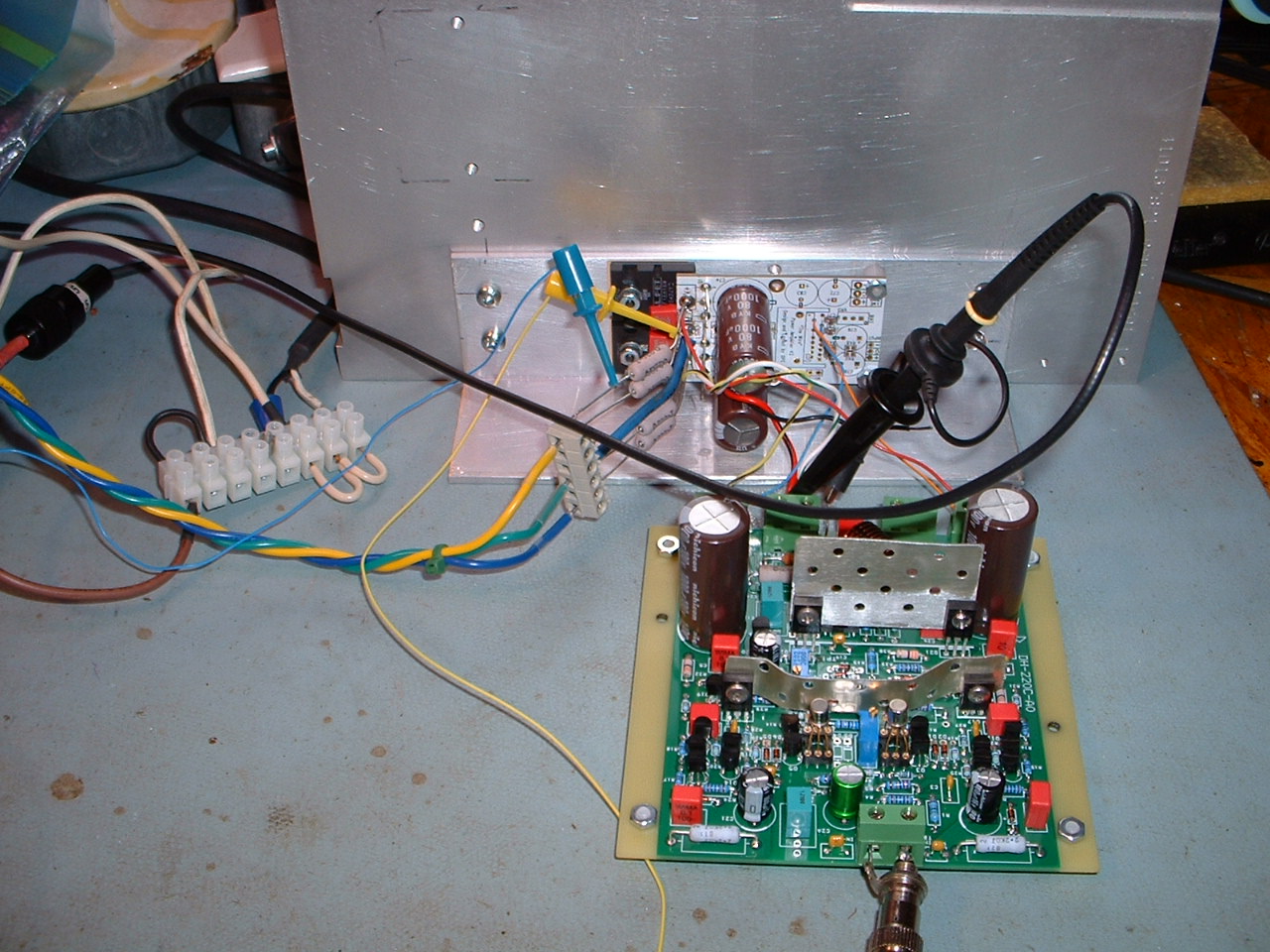

Powered up DH-220C last night, using some dual die lateral fets, I had on hand, hoary, it works, rise/fall was around 350ns, half of what the bjt OPS design does. Bob C. says that he runs his at 200mA per device, so that is 400mA through those devices, that big heatsink gets warm. Adding the two 0.22 ohm resistors in series with the drains allows you to measure the bias current.
One thing I noticed, the DH-220C bias is steady, from power up to warmed up. With the bjt ops design, the bias goes all over the place, +/100%, until it stabilizes, an hour later with a big HS. This is with the sensor bjt mounted onto one of the op devices as recommended.
How fast does one need? What was the original DH-220, I wonder?
I measure it flat into the MHz. A 100Khz square wave looks perfect.
The limitation is written in the book, the RC time constant at the gates, there is a 220 and a 330 ohm in series with the gate capacitance, iirc ~900pf for the P-channel device. The series R's are to inhibit oscillations.
The drivers are running at 20mA, with a +/-65V supply, I had to put a heatsink on them. Bob spec'd it for 16mA, so it is close.

I wasn't sure where the issue was, and I did indicate that the slew rate you have is probably good enough for audio. It is nice not to have too much phase shift in the audio band, and that requires a higher frequency response as you have. You didn't state what the gate charge/capacitance was like, and I'm not going to dive into a book over a casual post.
Boy, are you being picky today.
Yes, the driver need a heat sink. You might even be further ahead to use a TO-126 part with heat sink instead. That's up to you. The originals already have a heat sink anyway. I always found these amps to be nice in their way, and reliable too.
-Chris
Electronics is picky work :) One wrong pick and smoke.
You say a way to make it faster but fail to say why you would need it faster.
You are funny, "probably good enough for audio" :)
Can you name an amp that you have measured or they have spec'd, being faster? not that it matters a whole lot, but it is a *******(pi$$ing) contest. <--- AI at work
What do you think the rise time is for a tube amp, you are into 10's of uS.
I'll ask ASTX (Tony), what his CFA amp does, out of curiosity.
