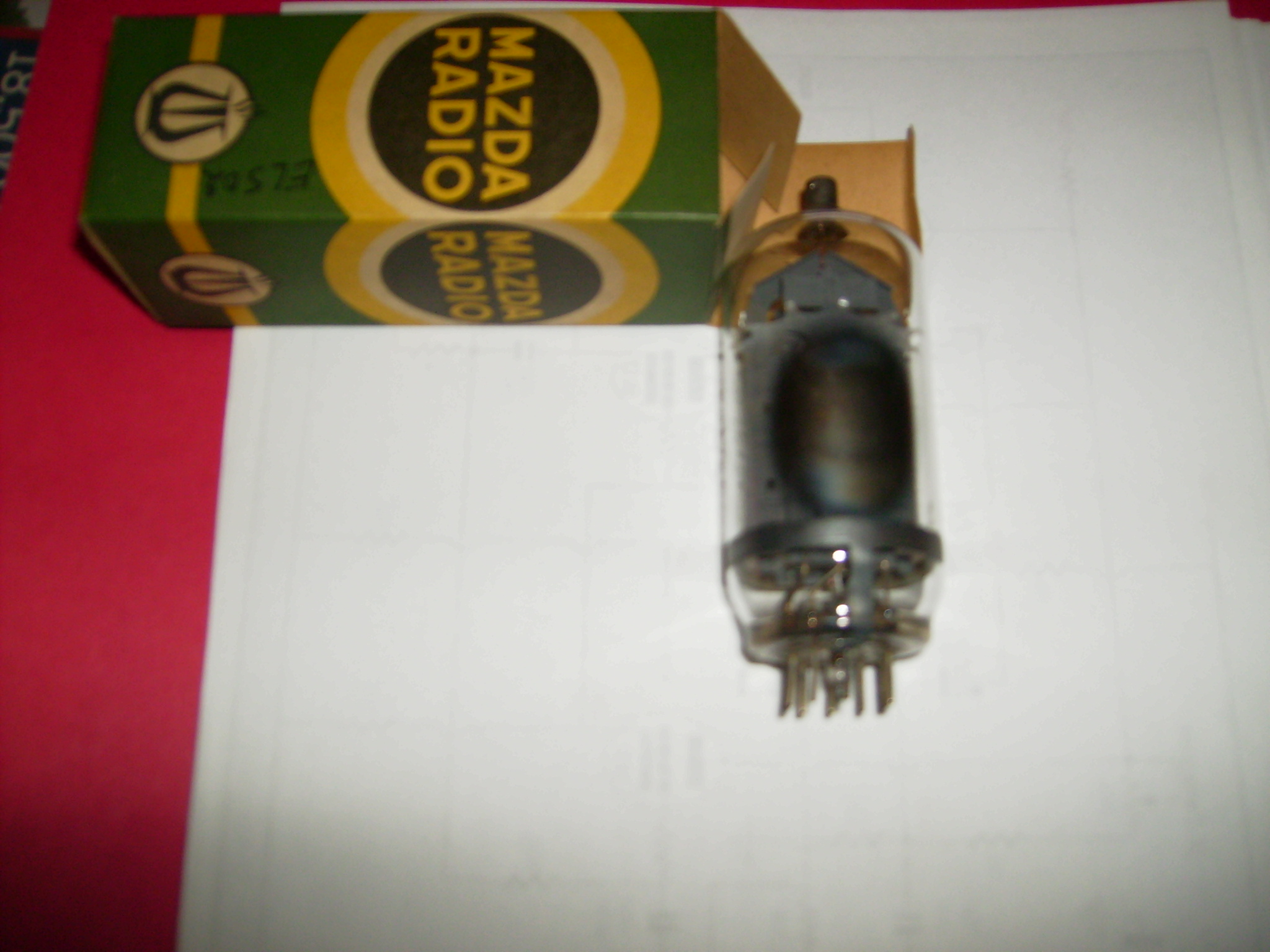

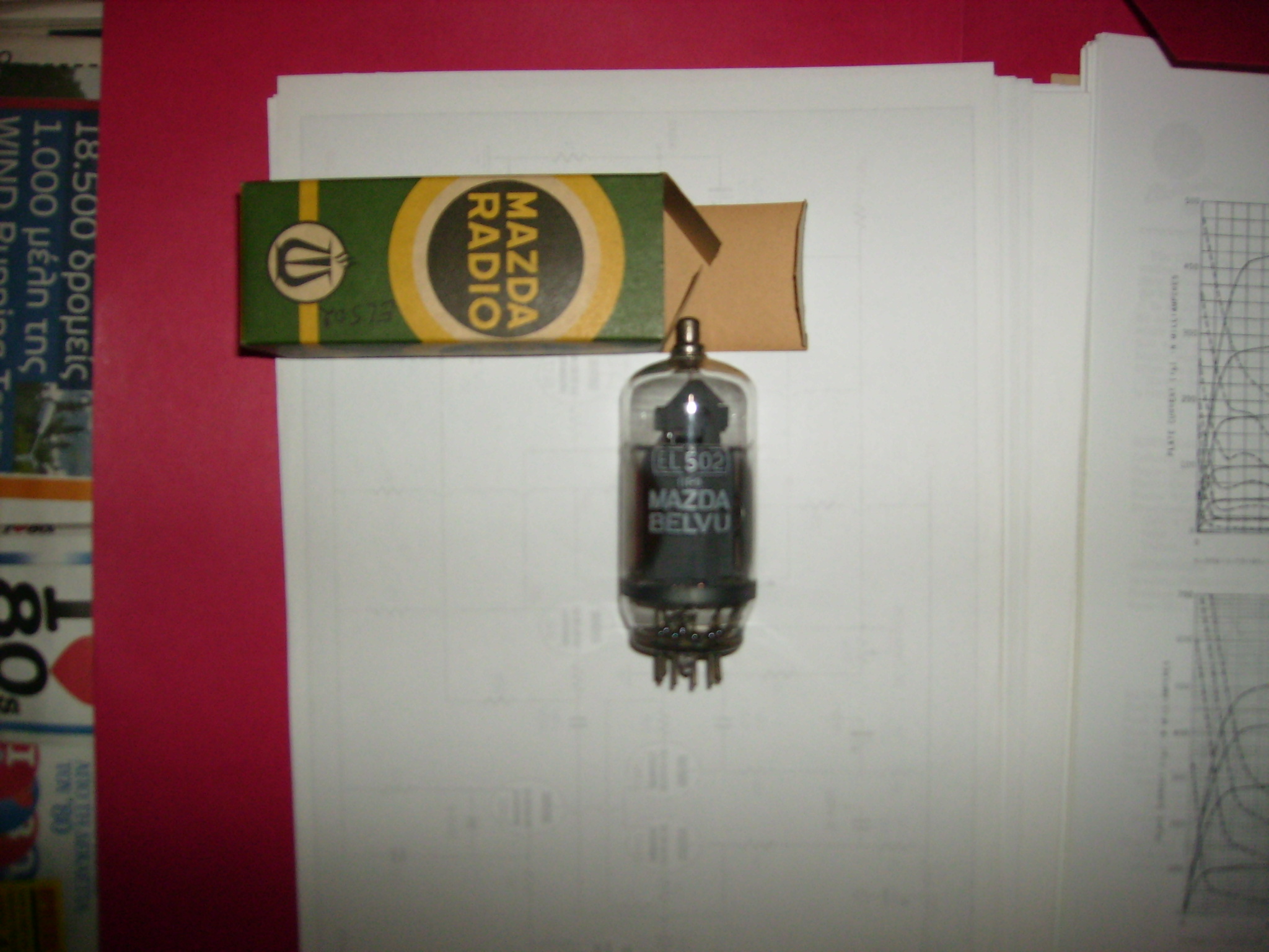

What was the graphite ring (looked like aquadag..a line that went around the tube base about half an inch up the bottle) that was put on the outside of glass on some sweep tubes for?
I have seen them arc across it..I can't find any pictures and I am sure it was connected to one of the pins on the bottom of the tube..

Graphite ring on sweep tubes is always on the outside of the glass envelope.
And it is usually not connected to anything.
Examples:
PL509 @ The National Valve Museum
exhibits of same type designation
Only tubes with plate cap seem to have it.
