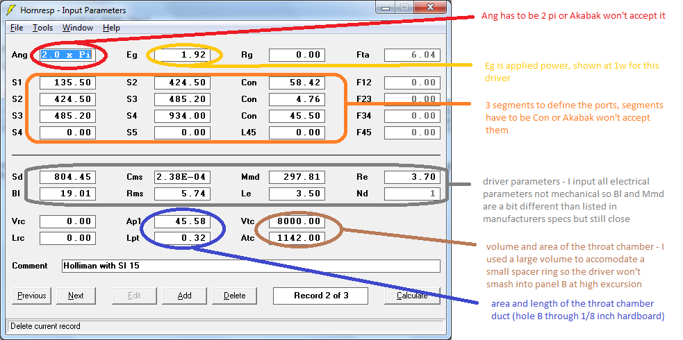

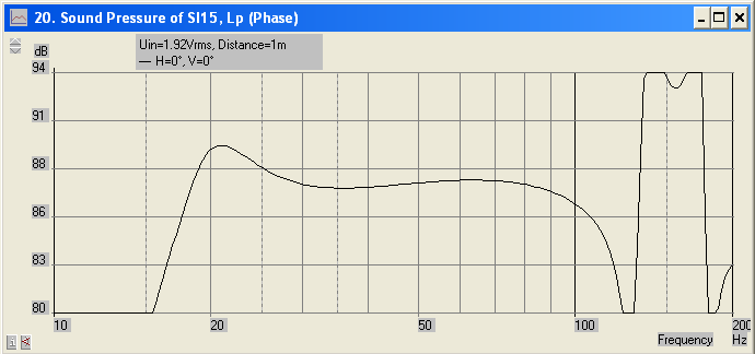

Graham Holliman encl. simulations
First, let me start by saying I expect people to check my work and make sure there are no mistakes. Please check to make sure I got cross sectional areas right (S1, S2, etc) and segment lengths correct (L12, L23, etc). Check my Hornresp inputs and my Akabak script. I'm going to look it over tomorrow to see if I can spot any errors but I think I captured the essence of this thing pretty well.
Ok, here we go...

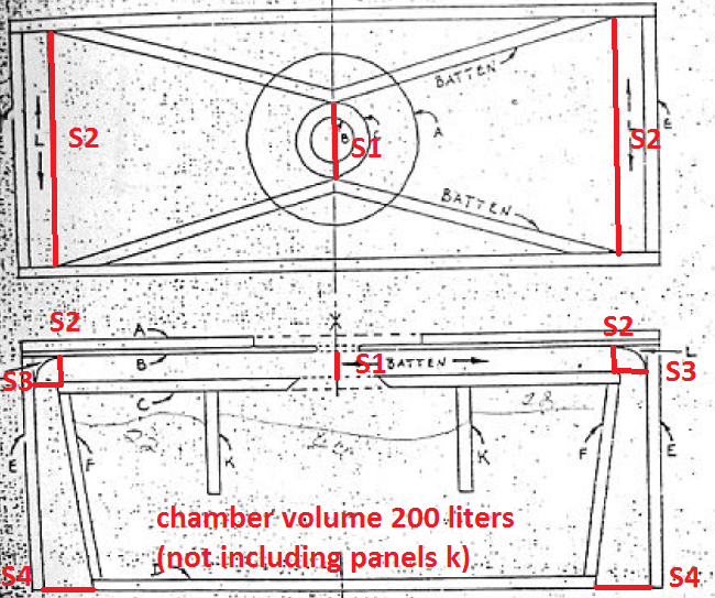

First up is a picture showing how I split it up into segments and calculated the compression chamber volume for Hornresp inputs.

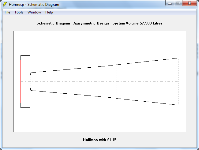

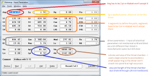

Next we have a picture of my Hornresp inputs. Everything is here except the details of hole c and the compression chamber. When you have to use Akabak I recommend starting with Hornresp first and importing that data into Akabak to continue, unless you are a masochist.
Starting with Hornresp gives a couple of important benefits, it generates the Akabak script for you and it allows you to view a schematic to make sure you aren't making stupid mistakes. Here's a picture of the Hornresp schematic (remember, this doesn't include hole C or the compression chamber but everything else is there).
You can see I chose to use the Stereo Integrity HT 15 inch subwoofer Stereo Integrity | HT Subwoofers since it's a fair value, has 22.5 mm xmax and 600 wrms power rating so it should do what we need it to.
Next I exported the Hornresp data, which is as simple as going to the Input screen, selecting File - Export - Akabak script and then I placed that file into the Akabak script folder.
Then I opened the file in Akabak and continued the script by adding the details of hole C and the compression chamber. Hole C is a waveguide consisting of S5, S6 and L56. The compression chamber is an enclosure with a volume of 200.4 liters and a length of 1m.
(I will put the Akabak script in the next post.)
Then I ran a few simulations starting with frequency response at 1w.
Not quite 7 hz. And clearly either the driver or the box dimensions need to change for smooth response down near tuning but that's not too important right now. Let's continue.

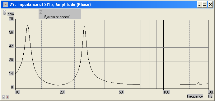

Here's the impedance.

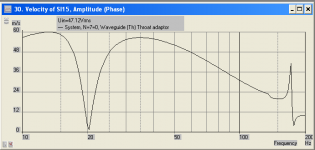

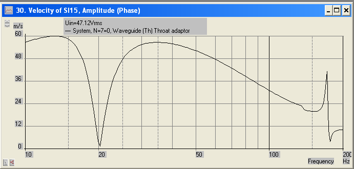

And at this point I was just itching to see the throat velocity (through the 3 inch diameter hole B). Here it is.
Yup, that's approaching 60 m/s inside the passband. In fact this is unacceptable all the way through the passband with the exception of a small area right near tuning.
Unless I've made a terrible mistake somewhere this is not a viable design for modern drivers. Probably not for antique drivers either. Throat velocity like that is going to squeal like a little piggy even with both ends of hole B smoothed (as per the plans).
It's interesting to note that opening hole B up to a 5 inch diameter reduces throat velocity to about 20 m/s and doesn't change the response at all - it really doesn't change anything. But the point is that if it's built according to the plans you are going to see very high velocity through hole B. If I was going to build it I'd make hole B with a 6 inch diameter - that's the same size as hole C and it's as big as you can go without changing the design significantly.

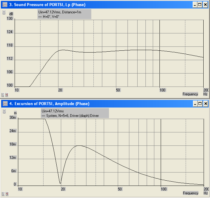

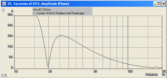

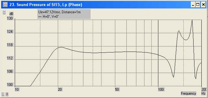

But here's the interesting part. This next picture is the same driver in a similar sized ported box with the same 600w applied.
Easier to build and much MUCH easier to simulate. IMO a much better solution overall.

Hi there J: Once again, your efforts have added knowledge of the G.H. enclosure, Please notice the relationships between the 1w and 600w graphs posted for G.H. 15" enclosure. For comparison of the two curves, I over-laid the two curves in a screen trace with 100hz being equal for both curves. The 600w curve flattens the response and lowers the 20hz peak, shifts the peak slightly higher and reduces its slope, as well as extending the high roll off somewhat. This suggests that further tuning of an actual build may improve the response. regards, Michael
Before going to all that work did you notice the scale difference in the 1w and 600w graphs? There's 3db per division in the 1w graph and 6db per division in the 600w. Maybe I should have noted that.
No it doesn't, see note above about scaling. Even if it did any of these things that would not be a benefit. You don't want a box that changes response with power level.
Hi there J: There is a graphical departure from the regular arrangement of graph divisions of 3db between 86db and 89db, such that Graph #20 may show the response different along the curve. I agree that it is undesirable to have a change in the response curve with changing voltage and most simulations I've seen (or done) do not vary much in this way.
...regards, Michael
There is a graphical departure from the regular arrangement of graph divisions of 3db between 86db and 89db...
That is weird, I didn't notice that. I guess I should have shown 80 - 95 db instead of 94. I'll have to look into that at a later date. Maybe Akabak doesn't like fractions in the scaling legend. I'll have to keep an eye on that in the future, thanks for pointing it out.

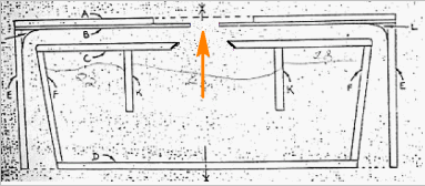

What everyone seems to be missing though, is that GH stated that Panel B should be as Thin as possible & as Rigid as possible. As i mentioned earlier on in the thread, i have the original Wilmslow Audio GH design i bought from them back in the day. I just dug it out, & he recommends either Formica or Dural of about 1/8th inch = 3.175mm.
I also feel sure that the HiFi magazine that published his design, & written by him back then which i have somewhere, said an alternative to having Panel B all 1/8th inch, would be to make the B hole area out of the Thinest/Stiffest material you could, & bond etc this to Panel B. So for eg, this could be Aluminium/Steel etc 1mm thick by 5" x 5" with a 3" centered hole !
How much of a difference it "might" make by reducing the thickness as much as possible ? But i think it's worth simming/trying just to see
@ just a guy
I didn't miss it. What I did miss was the smoothing (roundover) on both sides of hole B as per the plans but that would be a much more complicated sim to do and wouldn't make much difference.
Here's the line in the Akabak script describing the length of hole B.
Lpt = 0.32e-2; |Throat adaptor length (m)
I admit I could have been more accurate and used 0.3175 cm instead of 0.32 cm but I didn't think rounding up would hurt since the difference is 0.0025 cm.
You can also see this in the picture of the Hornresp script. Look at "Lpt" (in the blue circle). To the right (in blue text) I even state it's 1/8 inch.
