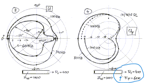

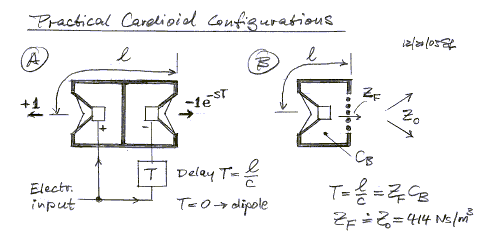

Rather than using an electrical delay T it is possible to derive the necessary delay from lumped acoustic elements as sketched in (B). The compliance of the air volume inside the box corresponds to an acoustic capacitor. In combination with the flow resistor ZF it forms an RC lowpass filter. Below its cut-off frequency the lowpass has nearly constant delay. The difficulty in this approach lies in finding a practical flow resistor of the necessary value, linearity and flat frequency response. It is difficult to obtain a resistor that can handle the large volume flows required for a woofer and (A) becomes the best solution. For higher frequencies variations of the concept in (B) can lead to cardioids with very wide bandwidth. By proper dimensioning of various parameters the roll-off of the rear radiation, due to the lowpass filter, can be made to coincide with the decrease in rearward radiation from the front side of the box, due to front baffle size and driver diameter becoming acoustically large. When combined with a coaxial tweeter, that takes advantage of the horn like nature of the midrange cone, it becomes possible to extend the unidirectional frequency range even further. A commercial example is the Revolution loudspeaker by Gradient Ltd. .
The question is how that absorbtion works:
Does the the speed of sound get reduced inside flow resistor and this is causing some delay to back wave?
or
It just reduces the pressure of sound (SPL), speed stays the same and because of that we get asymmetric dipole with cardioid-ish behavior?
From Linkwitz Lab page I am 99% sure that this has to be velocity related, because we need some kind of preferably uniform delay in wide frequency range for it to work, so the speed of sound has to be less in that mechanical flow resistor to get that delay. Right?
Lets assume I want mechanical cardioid for the coax part of the speaker, with as little of no dipole behavior. Then the question is - from which practical material to make flow resistor and how to calculate the right amount, thickness, approx fiber length, density, etc at least to the level to start practical experimentation? Are there those calculations available at all or all I need is to buy some Rockwool and start experimenting? Is there some science to it?

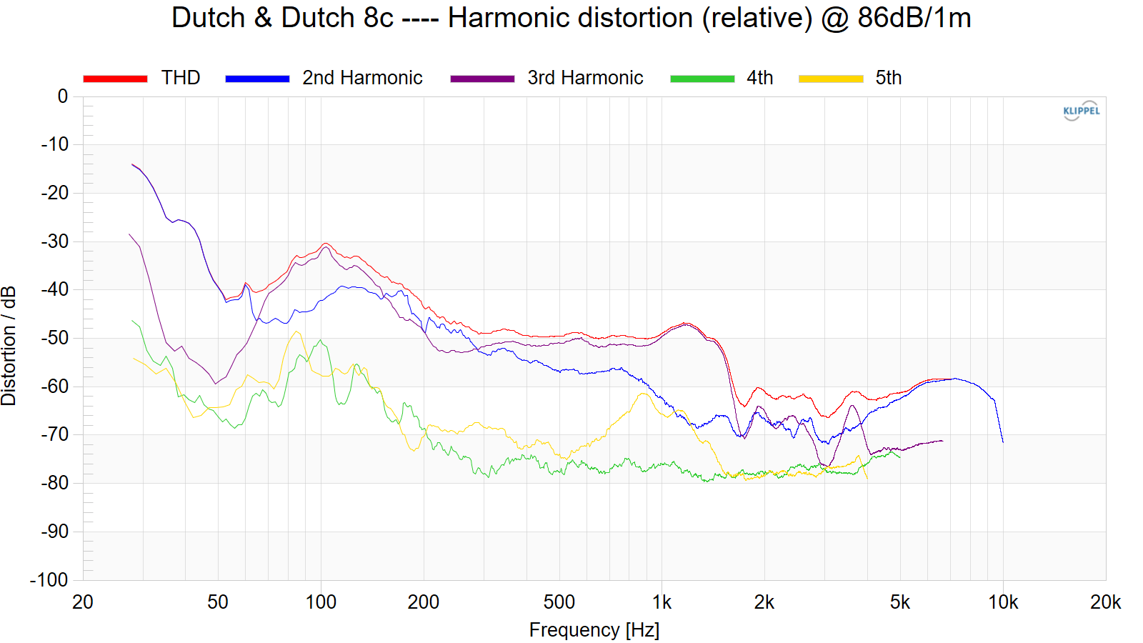

D&D 8c is a case to study! https://www.erinsaudiocorner.com/loudspeakers/dutch_dutch_8c/ Even it has highish distortion at 200Hz

Directivity of this speaker is exactly the reason I want to build my project. Budget is not as big to go with active system, so have to stick to smth simpler. My inner voice of reason says that the speaker with good directivity will save lots of tuning and eq-ing headaches. The THD in the graph is indeed high in 60-200Hz range for speakers costing 10k+ EUR but THD is less important than good IMD and directivity values.
