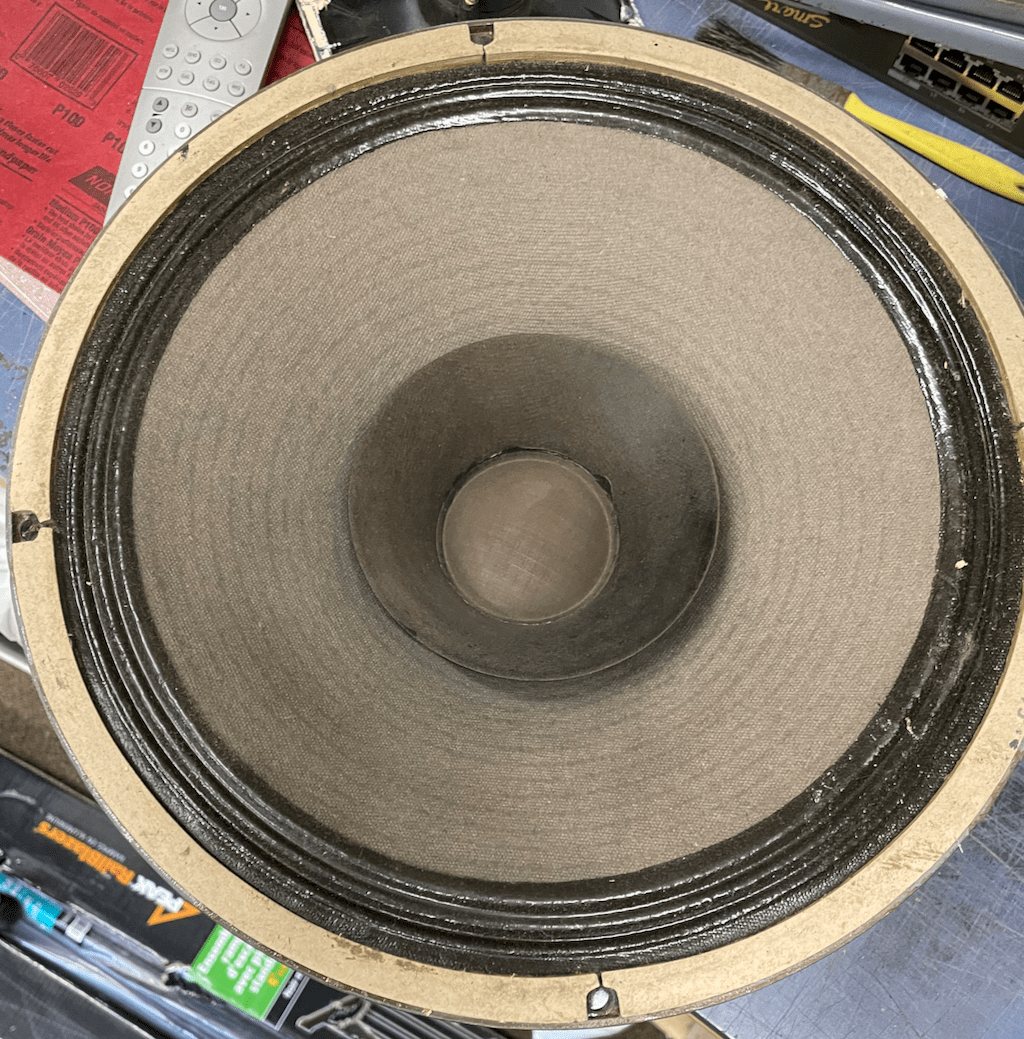

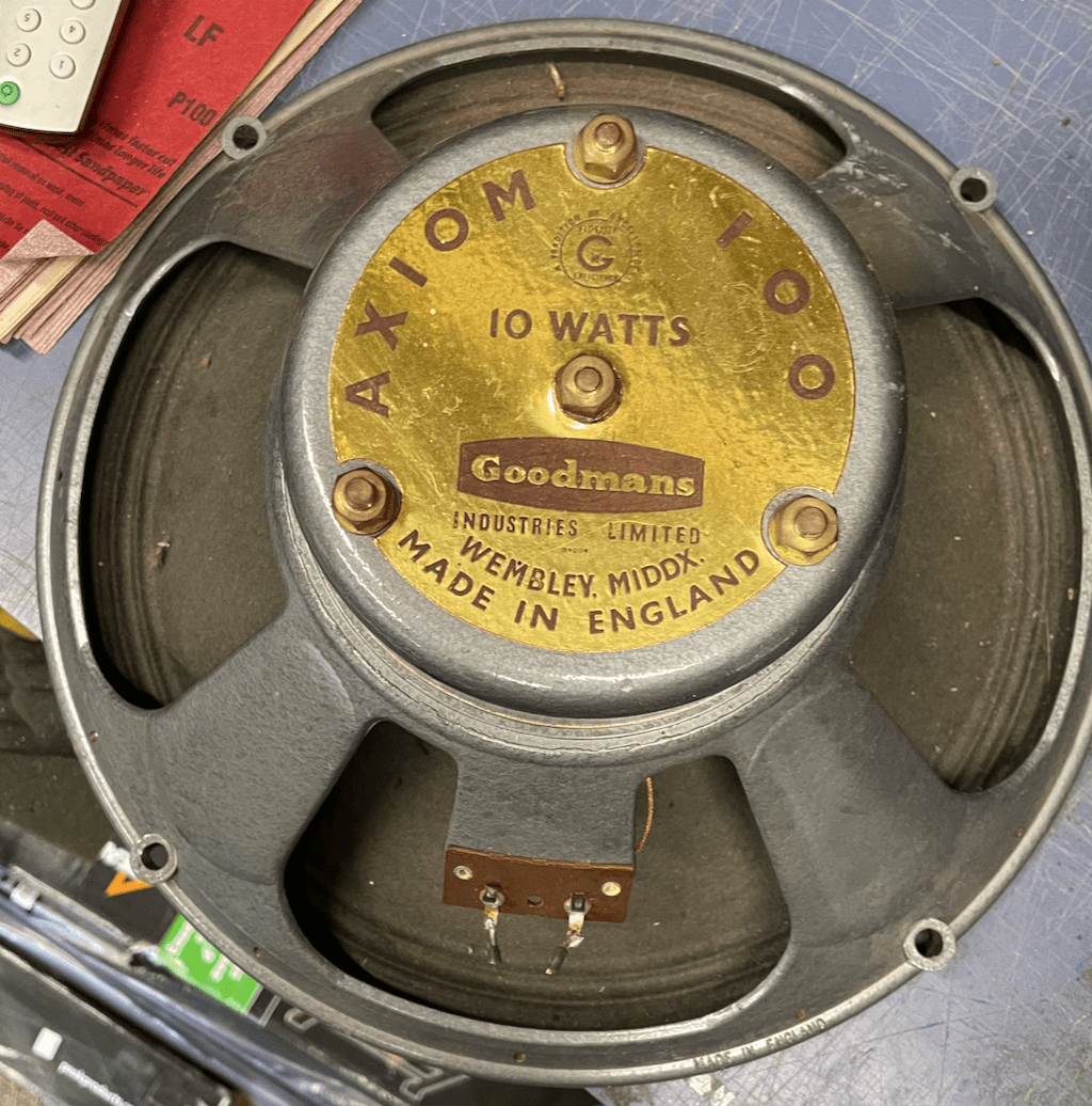

I pulled them out of ugly cabinets based on the bass reflex design. I think I'm going to get rid of them. They're too big for my purposes.You can find the original Goodmans enclosure designs at this safe site:

I am well aware of the driver's qualities. I've always had a dim view car audio. I pitched the 15ohm 201 against a 12" MTX Road Thunder (250w, 4ohm). Even in the Road Thunder's cabinet, the Axiom kicked the MTX's ***.
But they're too big, and I'll just damage them.
They're going.
