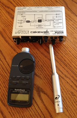

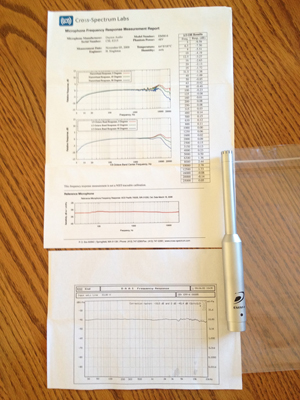

Point A) This is why I have been reluctant to publish data when people don't even believe me when I say it works. The measurements were made with a calibrated Dayton microphone with a separate USB preamp/DAC that provides phantom power to the microphone. I used Room EQ Wizard v5 open source software following all of the pre-calibration methodology outline in the instructions using a Radio Shack digital meter. I did fudge a bit and took the reading at a little closer than one meter.And yes if you look at the published plot it says I did apply a small amount of smoothing. Pretty nice plot, huh? It did not look so great when I tried to adjust the dampening by ear. But then I used this setup to adjust it and voila! Looks great and sounds great. It did sound good before but now it was like silky smooth. I will post picture of the hardware later.
So from listening tests done by yourself, would you say that this thing has output at 23Hz that is similar level to the rest of the spectrum? Because I seem to remember someone saying it dropped off around 100Hz.
I am a little confused by this whole licensing process. If I wanted to build one of these things I would have to first pay you $500 for the blueprint and license. But we have seem many prototypes already without the license and no sort of attempt to stop them so what then does this license actually get me?
Would you be willing to post the raw, unsmoothed response with no editing of any kind? Also the sensitivity measurement to give that graph some context.
Also info on the room would be great. Distance from walls, nearby large objects, etc. Total room dimensions. Carpet, windows, wood floor, etc, anything that could affect it. Also this will include information on your floor noise. For all we know a jet happened to fly by while simultaneously your furnace turned on, providing all of your low end output. And then your cat came along and meowed and then your kid ran by and knocked over a vase. Then after all of that happened the response was smoothed and walla we have a perfectly flat response.
Once again don't read this negatively, it's just necessary background object. The scientific method asserts that an experiment should be controlled enough that the results will be relevant to the change of only one variable. And without knowing everything there is to know about the test setup we have no idea if you adhered to this principle.
Regards
