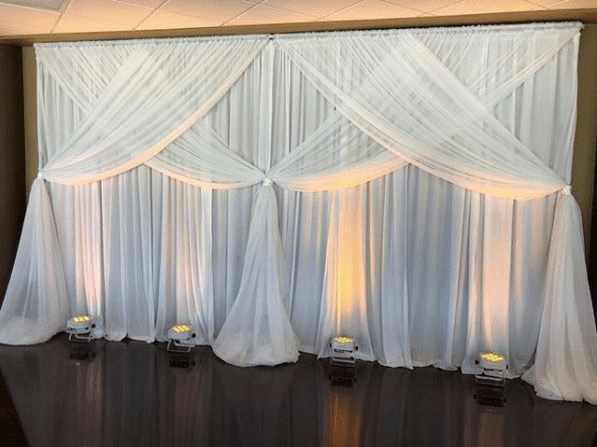

Use a Area rug for floor.
The walls use a "audio grade" product called.....
Drapes
Or use what movie theatres use.
Combination of drapes and glue weaved / loop carpet ( cheap office carpet)
to the walls
