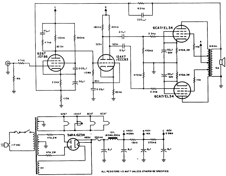

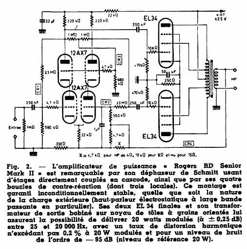

I'm pretty sure Frank just snagged these off the net (i've seen them both before), if so what you see is what you get. URLs to those sites would probably be more useful.
dave
Rino odorico said:Hate to bother you about it, but when I print it...can't really read it very well. Could you if possible (please) e-mail it to me?
dave

PRINTING
Rino,
If I send you the same stuff it's not going to solve the printing problem.
Try to open them in a graphics program and split the pic into 2 or more sections.
Save the separate parts,enlarge them so you can read all that's on it and when printing those enlarged parts make sure your printer is set to "fit to page".
That should solve it.

Re: NOT IN THIS CASE.
It is a little trickier to get them, but i just drag them out of the browser on to my desktop (it may be trickier under windows), change the *.php to *.jpg or &*.gif and open it in PhotoShop (or graphic converter or back in my browser).
The ones i posted have also been cleaned up a bit (they are actually gifs) from what Frank sent.
dave

Power...
Hey Frank,
Hum, 2 PP El34's...is that enough power? I would have to say yes, unless you have something up your sleave. Now the question (as I sip on my morning coffee) is, should I even ask...yes I should.
Ok Frank, I'll ask...why, what do you have in mind?

WHAT IS WAS THINKING
Well, I was thinking about a multiple PP of El34s but we better forget about it.
When I think I run a pair of self-made bookshelf speakers with a set of 2A3s PSE putting out a couple of Watts to more than satisfying levels....
No,I thought also that you could add a volumecontrol at the input
with a bypass connection straight in.
So for CD you could connect to that and for sources requiring a preamp you could then use the direct connection.
After all it is easier and less costly to drive speaker cable of some length than to use long interconnects.
