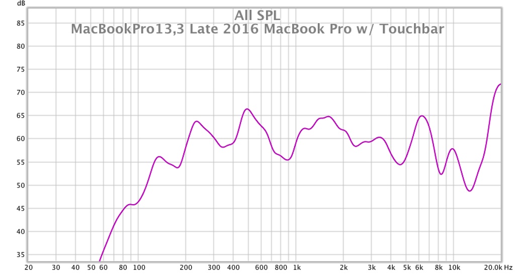

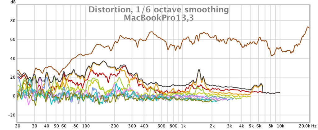

As an initial seed to this thought, I measured my MacBook Pro tonight using calibrated Earthworks M30 through RME babyface. See attached average of 3 measurements around head position with the laptop sitting on my desk. This is NOT quasi-anechoic but meant to get an idea of what I'm hearing where I'm sitting..... I can do quasi-anechoic when I setup to test another build this week if there is any interest...

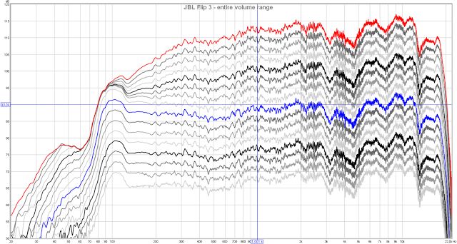

Attached is an example of how the response changes as drive level increases, capping the bass output (this device probably violates my patent LOL), taken from:
Oluv's Gadgets: Review: JBL Flip 3 - the UE Boom killer
The compressor is used to create the distortion in a controlled way that sounds acceptable to the ear, instead of just overloading the driver. It also uses less total power from the amp allowing the speaker to play louder in the region that's not excursion limited. The best way to define the max voltage vs frequency is to define an acceptable distortion threshold (vs frequency) and determine the drive voltage that achieves this. The patent explains how to build this into the compressor, its actually very simple and doesn't require any sub-banding.

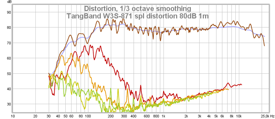

TangBand W3S-871 is a good fullrange. This is in a one liter closed box and a notch filter. However the distortion in low end gets critical. Placement near a wall and eq helps.

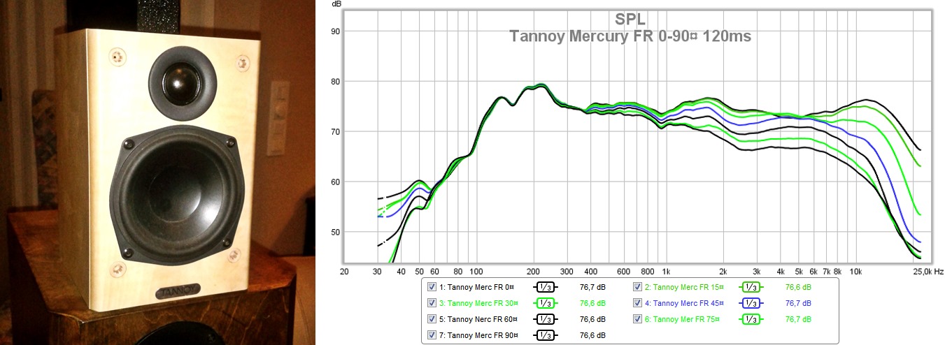

A Tannoy Mercury FR is a 1.5 liter BR 2-way speaker, much lower distortion but no bass below 100Hz!

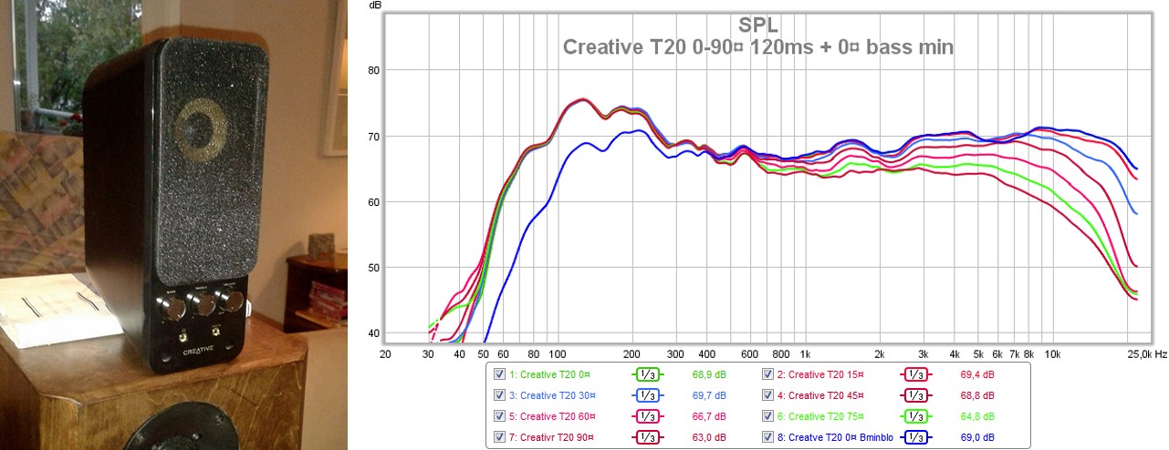

Creative T20 was surprisingly good until it's potentiometers stopped working
