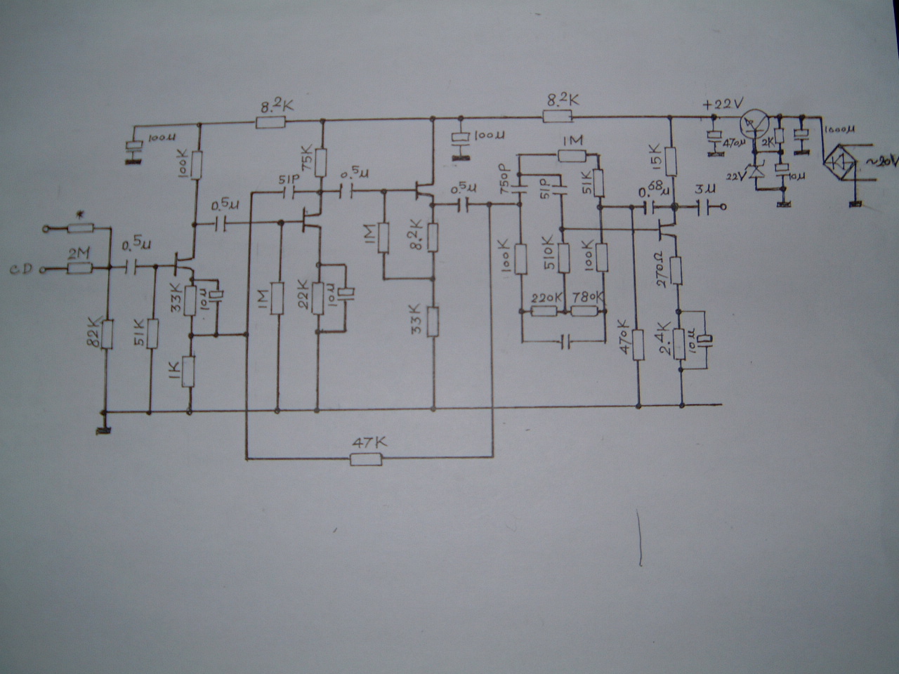

what are the number of your Jfets and the value of the capacitor in the tone area? do you have pcb? i want to try this .
Field effect transistor for the SANYO 2SK304F\/E OR 2SK30.... Capacitor 3300P bass

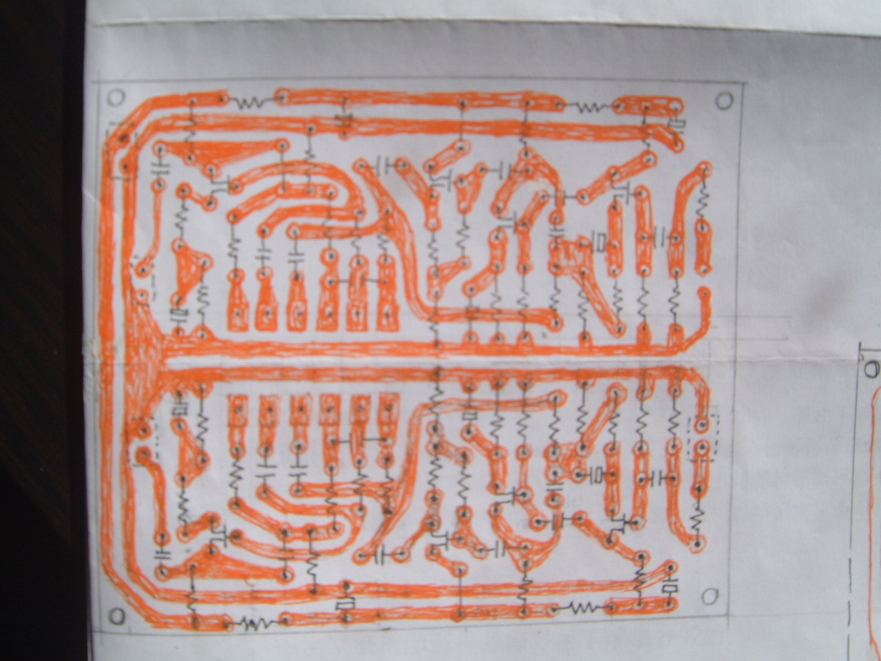

PCB graph. The operator

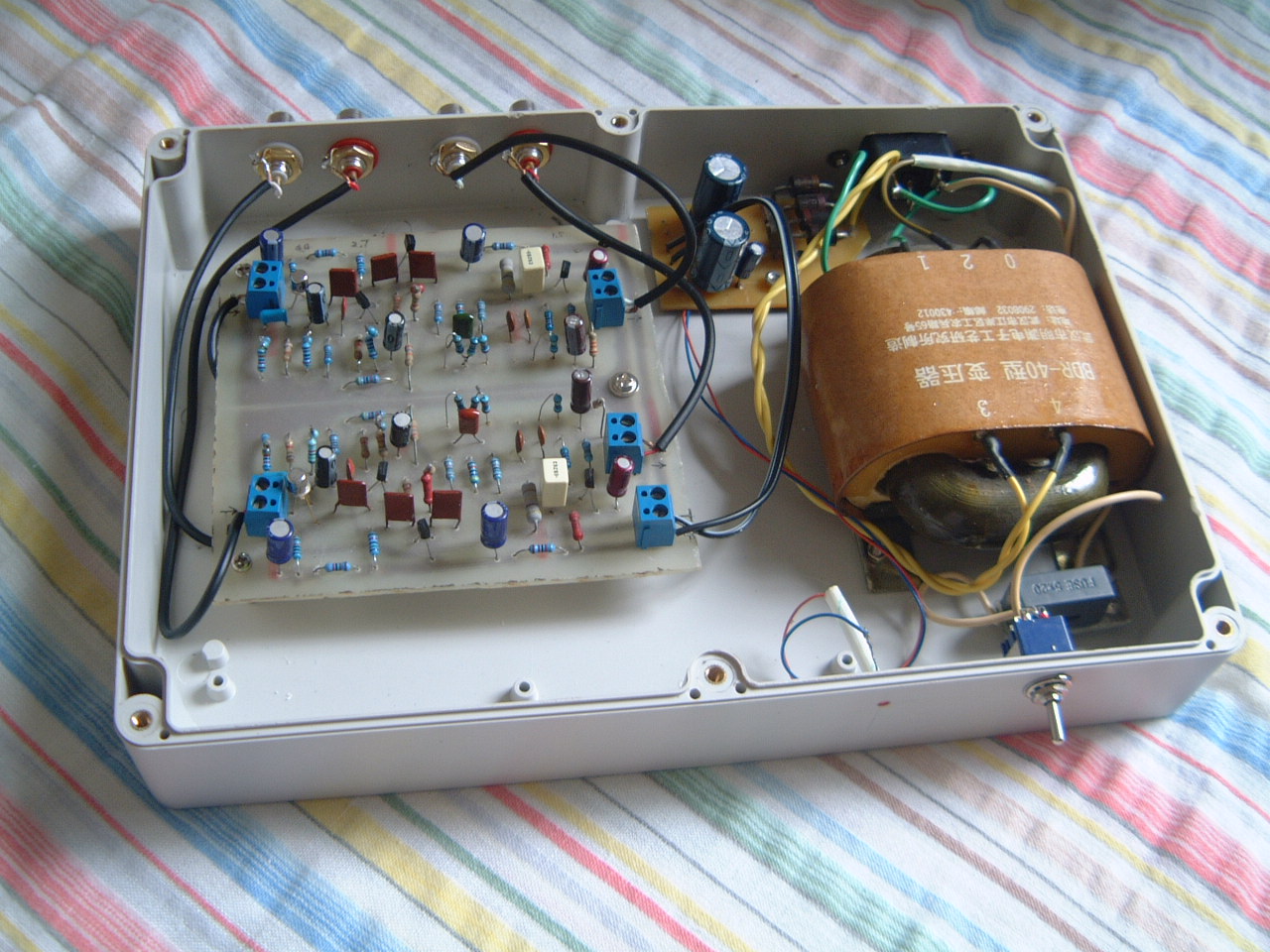

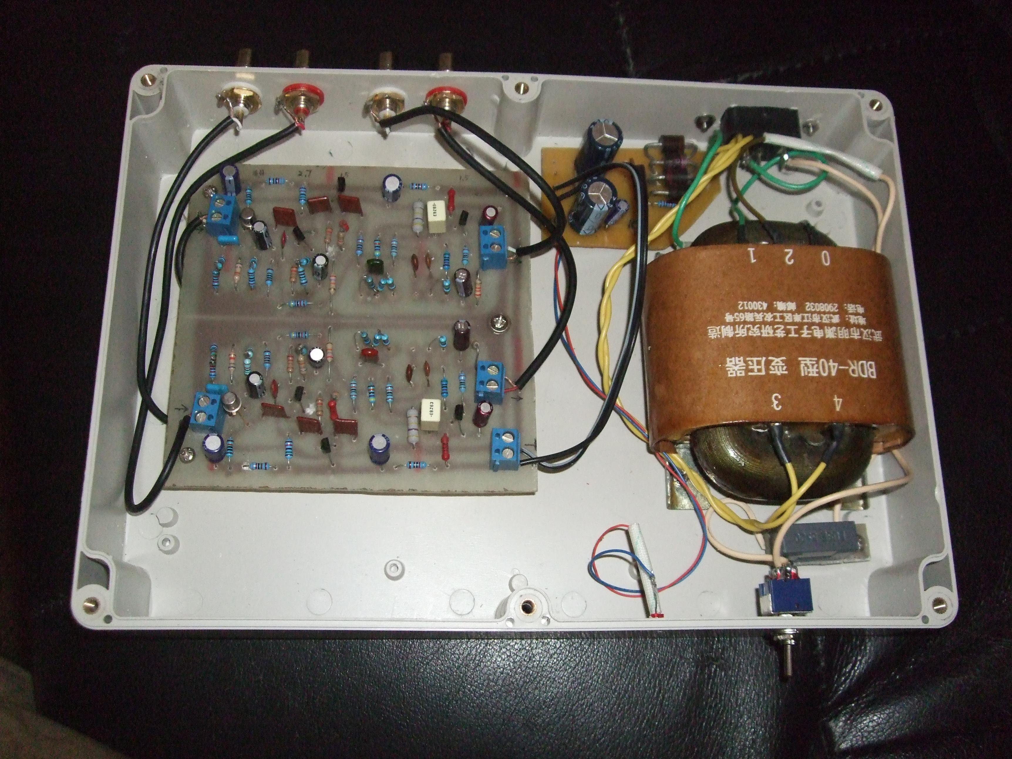

PCB with two 1MX2 potentiometer to adjust the treble and bass
thanks for the layout,so your two 1Meg pots are Linear type and wired?
two 1Meg pots are Linear (X )
