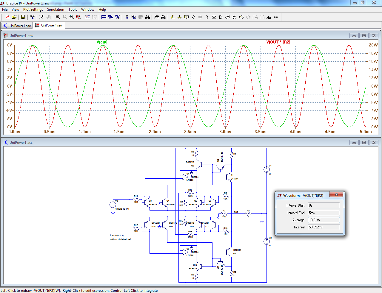

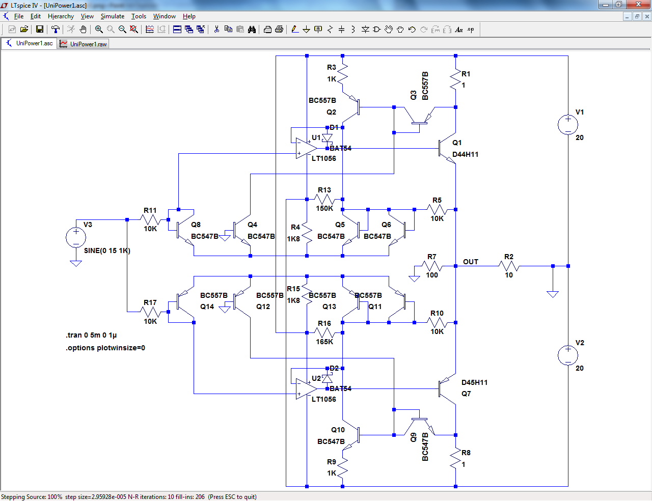

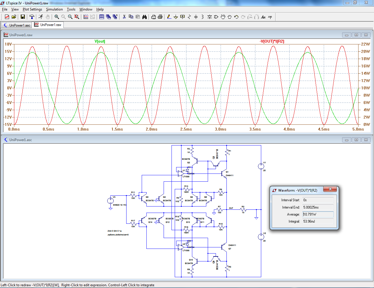

OK, here is a quick-and-dirty proof of concept.
It uses an opamp, but making a purpose-built discrete amplifier having better performances than a general purpose opamp for that specific use is not difficult: just tedious.
The important part, the mathematical "engine" is discrete.
This circuit is neither particularly accurate, as it uses many shortcuts and simplifications like V-I conversion with simple resistors, nor very clever because it is the direct translation of the mathematical function into circuit, but at least it actually does its job in a deterministic way.
A real circuit could be simplified and improved in many ways, here for example, the principal function resistors are 1Ω-100Ω-1K-10K, which doesn't give too much headache, but is certainly not optimal.

Of course not. I thought that was clear from the beginning:
This class of circuits, even properly implemented should have nothing to do with audio signals, and be confined to industrial processing and signal conditioning.
Anyway, by these standards my circuit is undoubtedly bad (I have no intention of building such a thing), but Tan Tai's is even seriously worse, quite visibly: it doesn't even do what it is supposed to good or bad, it simply harms the signal it processes.

I said that this class of circuits has nothing to do with audio applications. That include my circuit, and any future one, even one performing that function in an ideal manner. It could find an application in an effect box for guitar or something of the like, but that's all.
Anyway, my solution is demonstrably better: it is stable, predictable, introduces moderate amounts of distortion, and most importantly it does its job

Yes to both: the circuit does perform the mathematical function, but applying messy non-linear functions to signals is more suited to control than for audio applications
When you design a circuit think about what to serve?
The circuit could easily be made near perfect, but it is a complete waste of time. I simply showed that the function was not difficult to implement, but this certainly doesn't mean it is worth implementing.
Another assumption of your superiority.
It does not well its job, because:
1. it does approximately the math function.
2. it does very badly the function of amplify an electric signal that is much more important.
With your simulation, you haven't demonstrated well nothing.
you have tried just two points that are also relatively close.
Now I think you'd agree with me that for two points can pass:
1. a straight line.
2. parabolic curve
3. hyperbolic curve
4. quadratic curve, etc
so to verify the mathematical function shoulda simulate at least 3 points. :smash:
