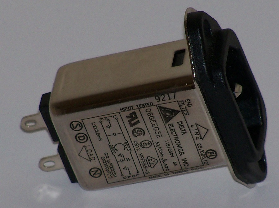

Would any of these be better or best. What do I need to look at as far as specs goes, I live in the U.S. where my wall power is 120 volts.

I would end up needing a total of 4, 1 for a pre amp, and the other 3 for 3 power amps. The second one listed only has a 5 amp rating. I figured 5 amp should still be more then enough for the pre amp. The tabs wouldn't bother me as my pre amp has a cut out for that type of iec plug. I purchased one of the first ones. I figured for 3 dollars I cant go wrong. Know if the 5 amp ones will work for the power amps I should get 3 of those now since they are on sale.

Well, received the first one. I ordered it based on the snap in style mount as I didnt want to have to drill any wholes. But turns out it was slightly larger then the one I had in there so I had to file some down. But I started looking for one of these as I had a hum in my pre amp, in the process of installing this I re soldered a few spots, and found out that I had my transformer wired wrong. So all that got fixed this iec plug got installed and bam no more hum this pre sounds great.
When choosing a filtered socket, choose one that is sized right. If your equipment will draw .5 A, choose a 1 A or so filter. Don't use a 10 A filter thinking it's even better, because it will actually do a much worse job. An equal size/cost filter with a lower current rating generally has a higher inductance in the filters, and this results in better filtering.

I found if you compare a 3Amp unit from a number of manufacturers each one will have different values for the caps and choke. In the end i found a lot of information in this thread Felix project ended up making my own version of the felix filter using parts recycled from a bunch of old ATX power supplys.

6 Amp filter 115V IEC receptacle in stock for $2.00 each

What brand/model # is it?
Delta Electronics
Model # 06GEEG3E
250V 6 Amp 50/60Hz
Picture on post # 2 and my last post too.
