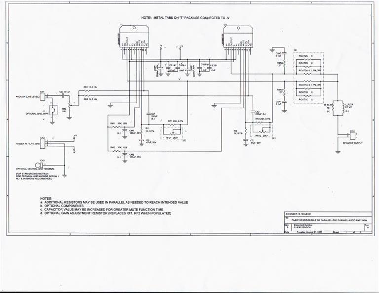

Sorry for the delayed response had to scan my document + scanner use problems.
Attached is the schematic of the amplifier modules. In my second post, a system diagram including the whole amplifier and source units, etc.
I will try again all suggestions above, and recheck how I applied Perry's suggestion.
Thank you again!

As a side note, originally I thought had resolved the noise. The source, the PXA-H701, measured continuity to chassis ground on its RCA shields.
I made a DC-DC isolation module, and isolated all power & ground to the Alpine PXA and 90% of the noise was gone. Increasing the input level on the amps revealed the ground loop noise, which is why I am here again!!
If I connect only one RCA or only one pair of RCA connectors from the source, each one/pair on a separate SMPS/amp, I don't hear noise. However any additional RCA connector in used per each SMPS/amp set reveals the noise.
My amplifier is really like 3 amps in one: all 3 SMPS outputs are isolated from chassis ground and each other, with a star ground configuration to the power connections.
All RCAs internal to the amp are direct to the PA100s & isolated from the amp chassis ground with the exception of the braided RCA shield, connected on only one end to amp chassis (chassis gnd). The reduced EMI picked up if I use cooling fans.
When the system is on I can verify no continuity to chassis gnd on the RCAs. I also disconnected the control cables going to the head unit (to break any ground connections there) and somehow still the noise was still present.
Right now I am having to run one one pair of audio per each SMPS + the sub channel to avoid noise.
I'm willing to try anything and really appreciate you guys helping me.
