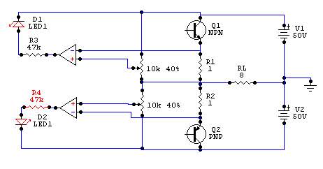

Hi, I was just brainstorming about clipping-indicator and I quickly designed something. Can anybody tell me something like will or won't work? (with the potmeters you can adjust the indicator to the voltage over R1 or R2 at which the amp starts with clipping).
the right values of R3 and R4 must be 1k at 12V supply for the opamps.

Just use an op-amp to compare the input with the output.Pick the signals up at the diff pair.Drive a bridge rectifier with an LED in the center.If you add a one shot set for 40mS it will detect even one cycle of clipping at 20Khz.No adjustments needed.
I think hugobross was asking whether his circuit will work, not necessarily looking for other suggestions. However, djk's idea is intriguing. The idea is that under normal conditions the difference between the input and feedback signal will be very small; if the amp is clipping the difference will be larger.
I think hugobross' circuit will work. The top LED is the wrong way around (I haven't checked all the polarities). If you're using a 12V supply for the opamps you may as well connect the LEDs there instead of to 50VDC (saves having a power resistor to drop the LED voltage). You may want to add a bit of positive feedback to the opamps (see references on using comparators) so there is some snap action.
A retriggerable monostable as djk suggests may be necessary to actually see the clipping when it first begins.
so, it might work.
Indeed the top LED is placed incorrectly, the idea is based to compare the voltage over the resistor with the adjusted voltage at the potmeter. When the voltage over the resistor is higher than the "potmeter-voltage" the output will be negative and at max. voltage (in this case -12V) so the led will light up, in the other case the output will be +12V and the led won't light up. Indeed djk, I'll have to connect the leds to the 12V supply, not only to spare power resistors, but also to avoid lighting up the leds with normal use (50V - 12V = 38V so the leds will light).
the right values of R3 and R4 must be 22k
If you must see the led lighting "on time", before clipping, I suggest to adjust a smaller voltage with the potmeter ;-).
