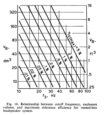

OK, choose your peak SPL, efficency per the chart.

No, speaker design is a bit more involved, though sometimes you get lucky like I did a couple of times early on, but it was more due to drivers of a size having a generic performance for max interchangeability whereas today most manufacturers want the opposite.
That said, it's a rather basic horn, so probably will have some luck scaling based on your driver's Fs, then can sim its specs to find the 'close enough' scaling to the horn's near 500 L net Vb.
