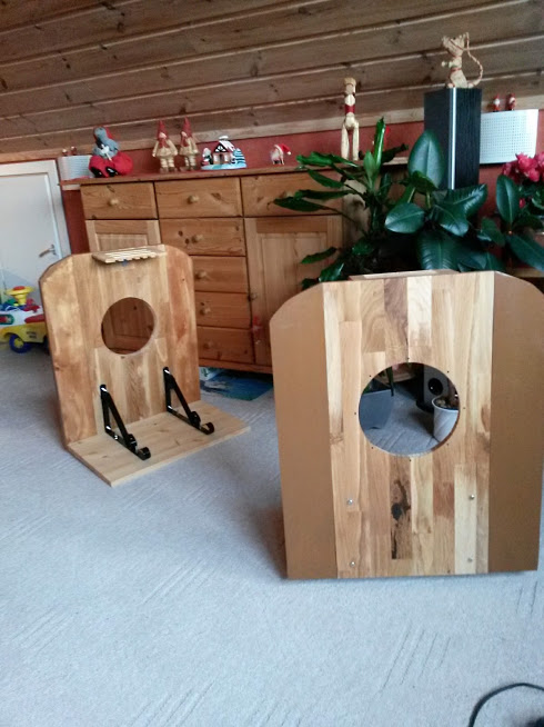

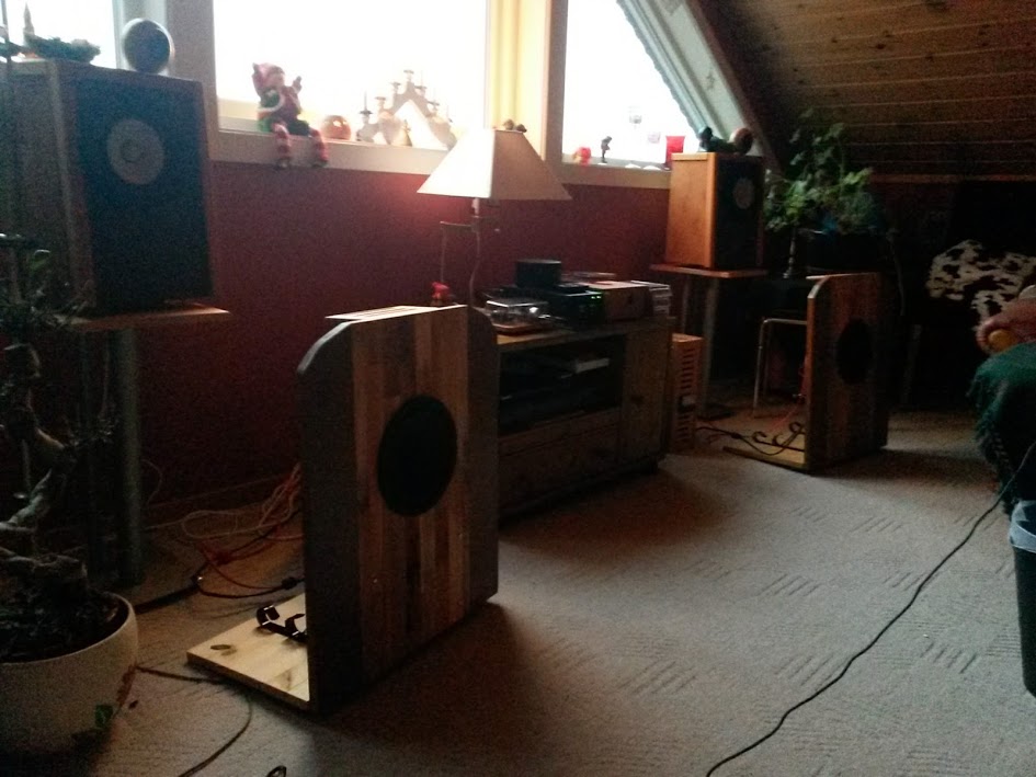

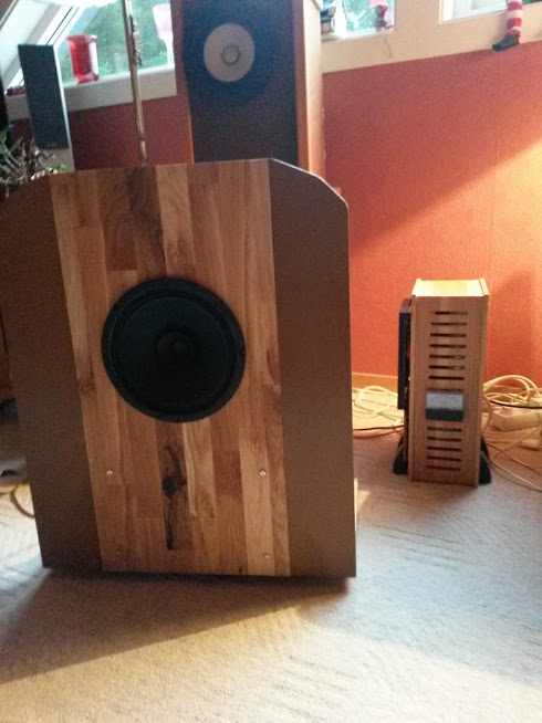

As a fullrange user and partly builder of audio systems I have been interested in OB-builds for some time, and took the chance 1 month ago to get me some Betsy 8 inch drivers to try out.
And the result is amazing - clear and enveloping sound that is more musical than my BR Alpair12P. The Alpairs is more HiFi with a clever, distinct lightning sound. But the Betsy is more easy and good to my musical ears(mind). They both give a 3D organic sound.

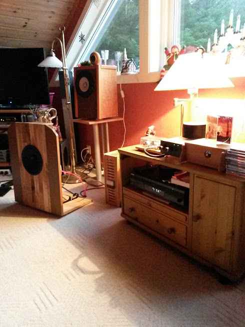

My Audio SetUp is: Sony SaCd player - A homemade Metrum Transient DAC - A homemade Luminaria (SIT classA) preAmp - Mono LÀmp (Resistorversion with SIT transistor).
Now I maybe have to find some OB woofer? to get more punch in the lower reals. Maybe - but not realy needed. Time, work and health must decide....
And today I can`t understand why there ain`t more people using these very nice drivers in their project. Supply them with a woofer & maybe a tweeter and it is a fullrange system that is made of GOLD. Today I play them more than my FHXL Alp10.2 and Alp12P.
My FHXL is connected to a HarmanKardon HD980.

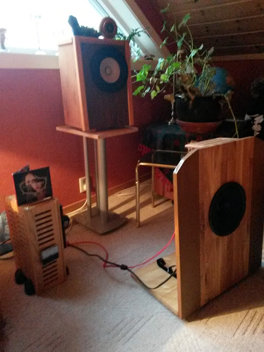

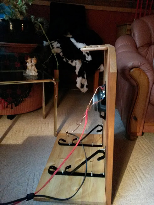

Something like that Yea. I now tries mine with Dayton MiniAMT with 1 uF WimaCap. Should be around 12000 Hz. And with tweeters right on the sitting position and the Betsy stright out. Very good. But maybe a BG Neo3 (or a Mundorf AMT dipol) with a cap at around 7 kHz. Used in dipole and as supertweeter. Simple and with the open soundstage more like a electrostat.
Or just keep it like it is - already super - and with a DSP controlled Subwoofer.
