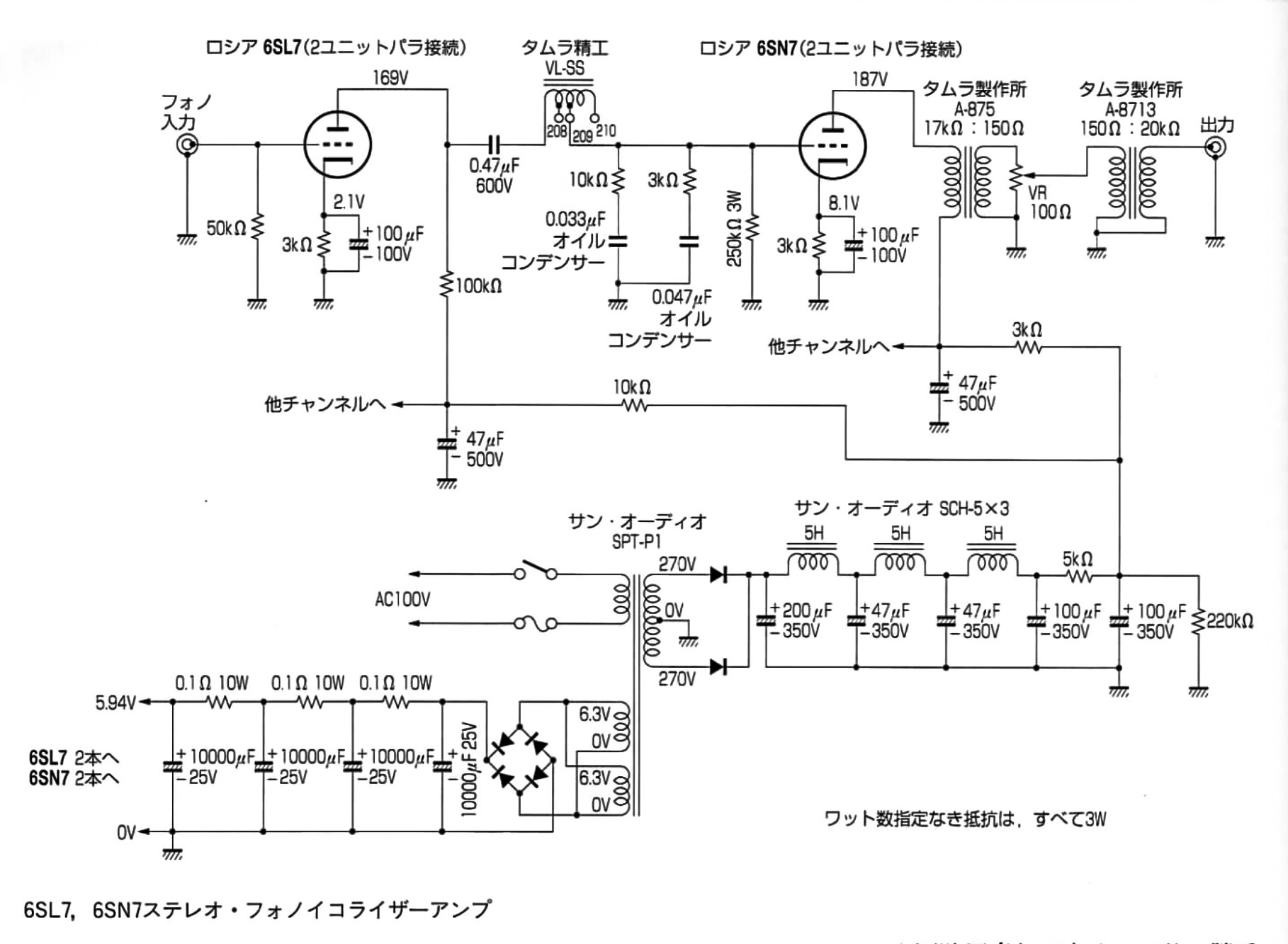

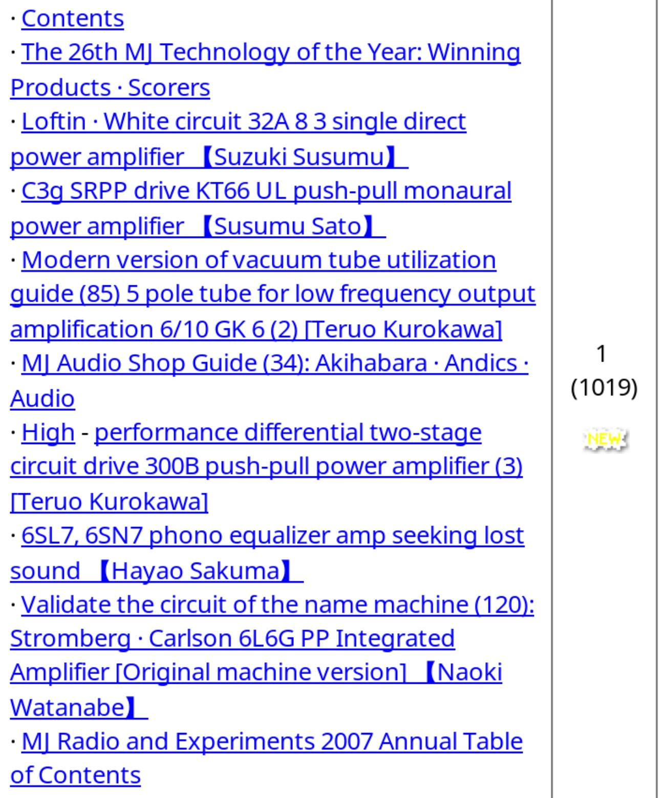

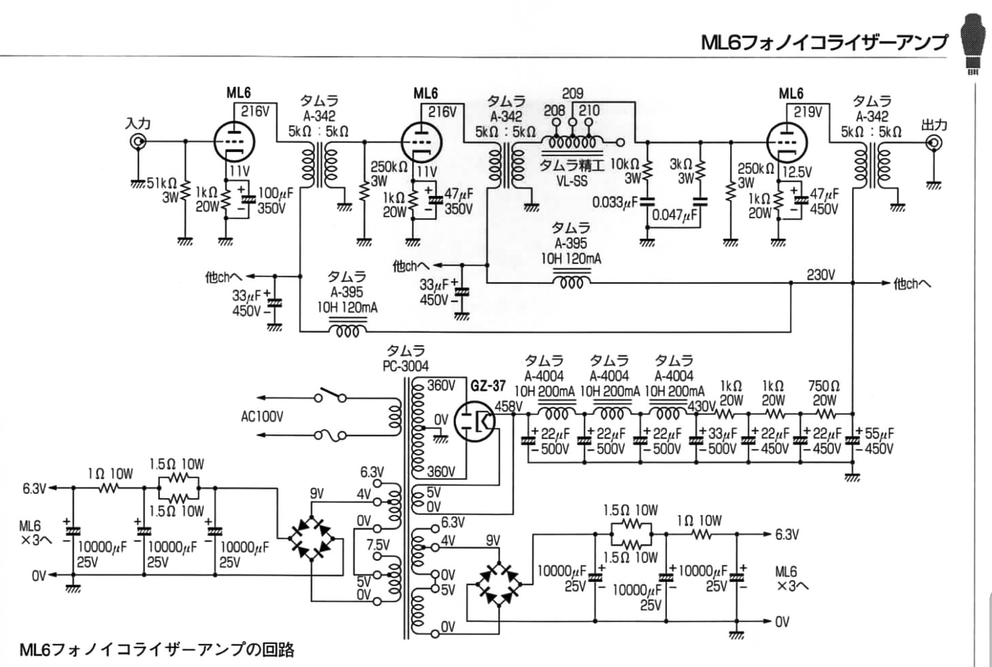

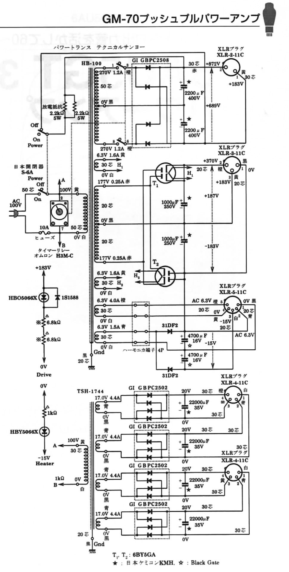

It's easy enough to miss, as I have done it myself. When I started going through the archive, I too thought the articles were complete, but as it turned out, none of them were! So the whole thing is nothing but a big teaser... although having the schematics still proved to be quite useful, so it's not a total waste of time.

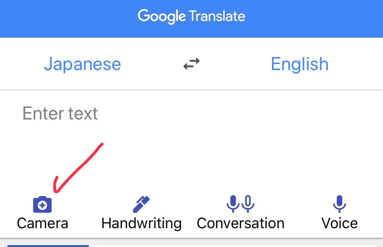

Translate text from photos from English and other languages – Yandex.Translate ocr the image, then you can send the page to their translation page, this is the translated text body all 4 pages sans images

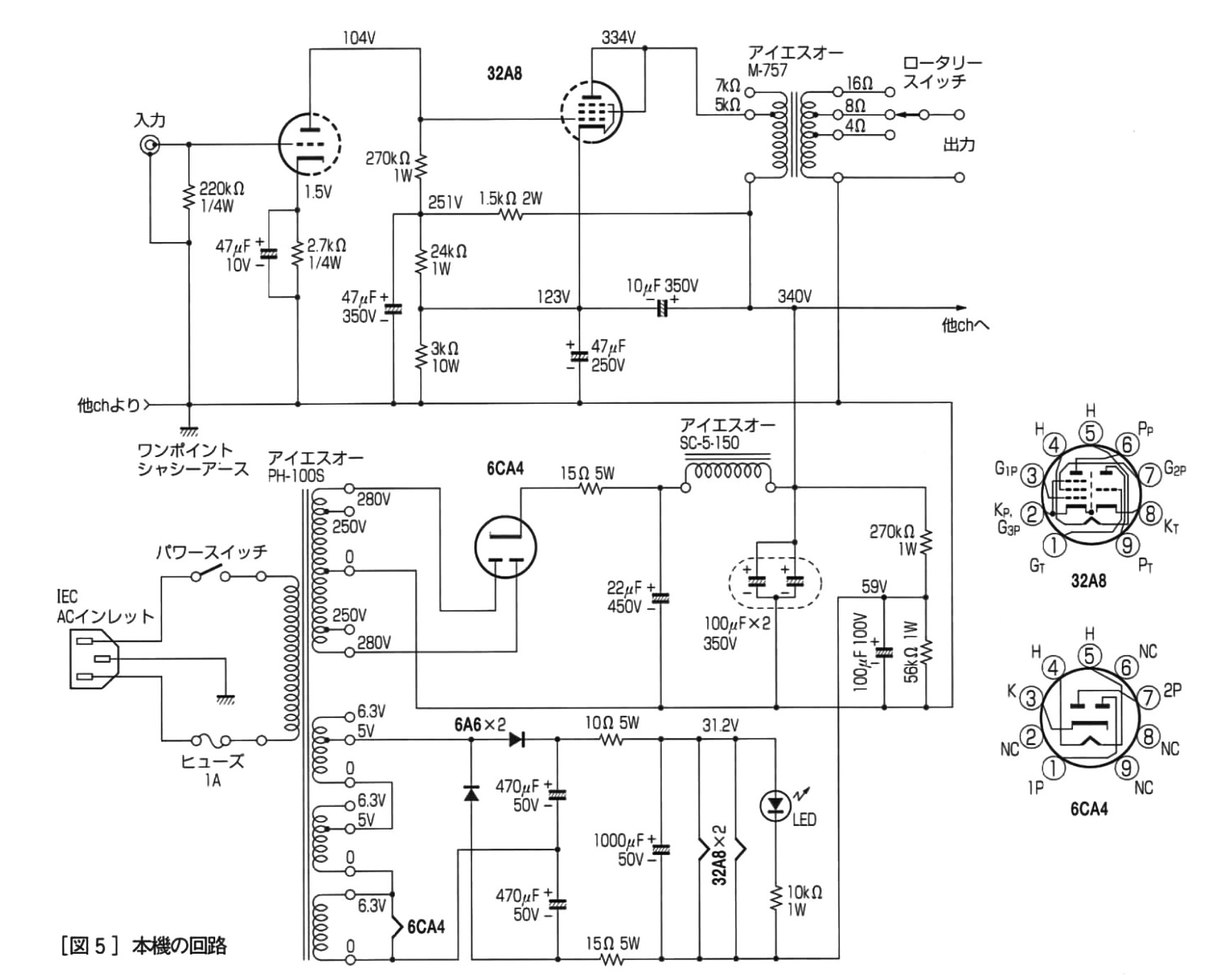

I like that 32A8 amp, simple and compact with the advantage of no blocking distortion. I never heard of this tube before though: http://tubedata.jp/sheets/201/3/32A8.pdf
Surprised they used standard XLR connector for 872v and even no heatshrink at the solder joints.

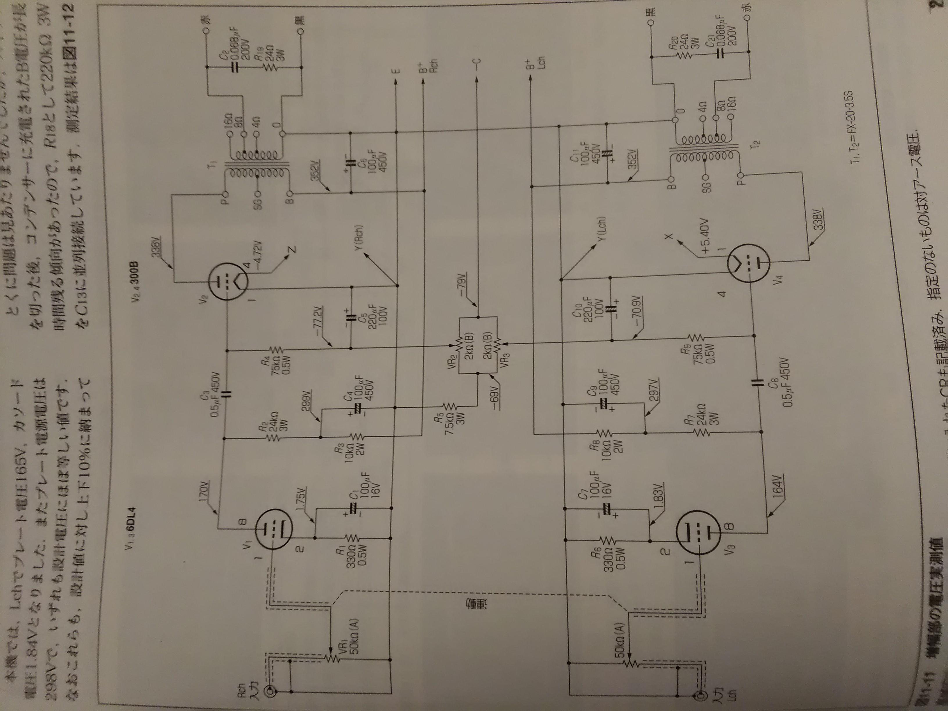

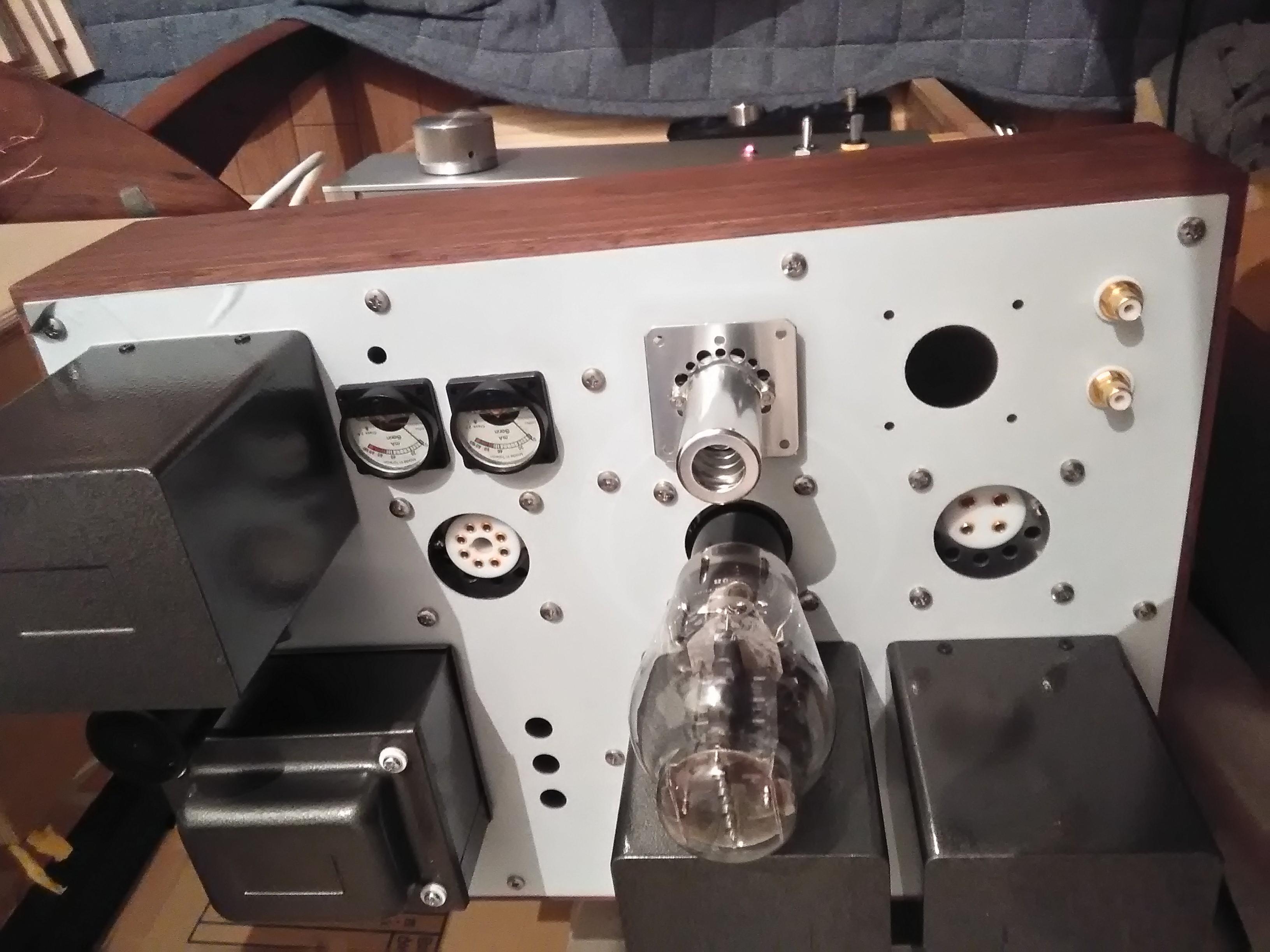

Hello. I am building 300B SE from book (very first tube amp).
First stage is 6DL4, fixed.
Building with new ISO transformers.
This is my first tube amp so taking long time.
