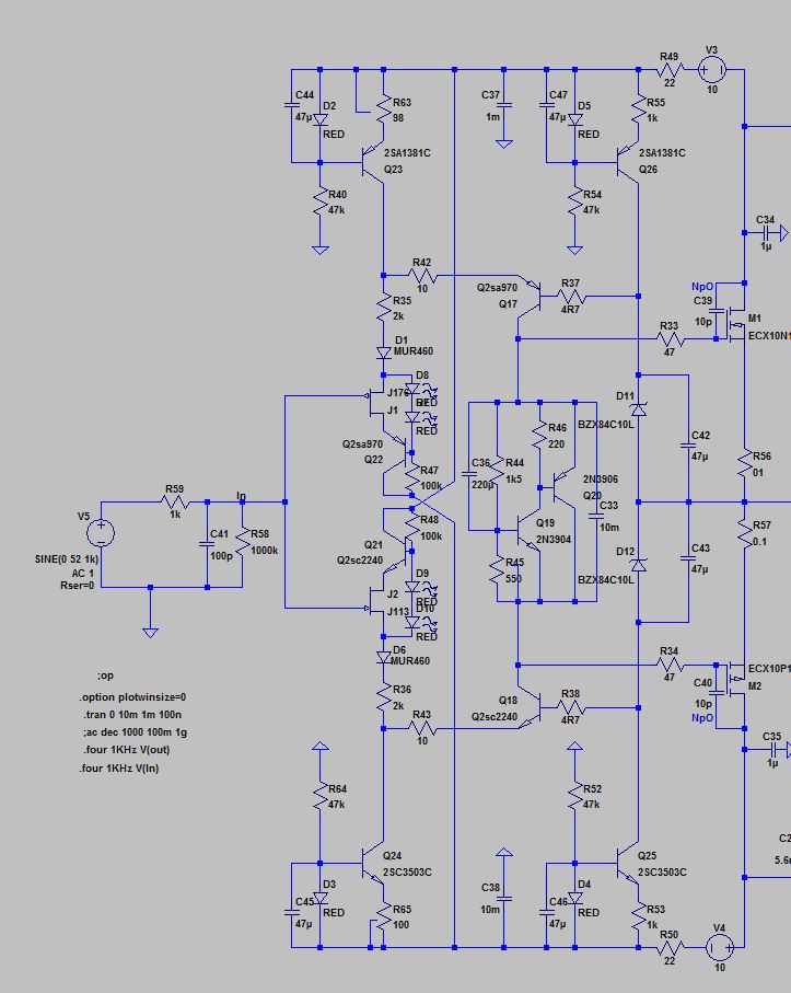

With gentile manner I understand thoughtfully applied. I cant help having the thought that the shorter the feedback path is, the less phase-shift due to device capacitance it has to work through.
Damir has made some good Non feedback voltage amplification circuits. They have low distortion, but need a light linear load to perform IRL.
I have made a gain of one OPS there I use a short cascode like feedback, The loop is really just around one/two devices and it holds excellent simulation results.
The one posted here does not really need the VBE and it can have multiple Fets in the output. It does PPM at 20KHz swinging close to the Rails. I have used jfet for the input as not to load the driving circuit.
