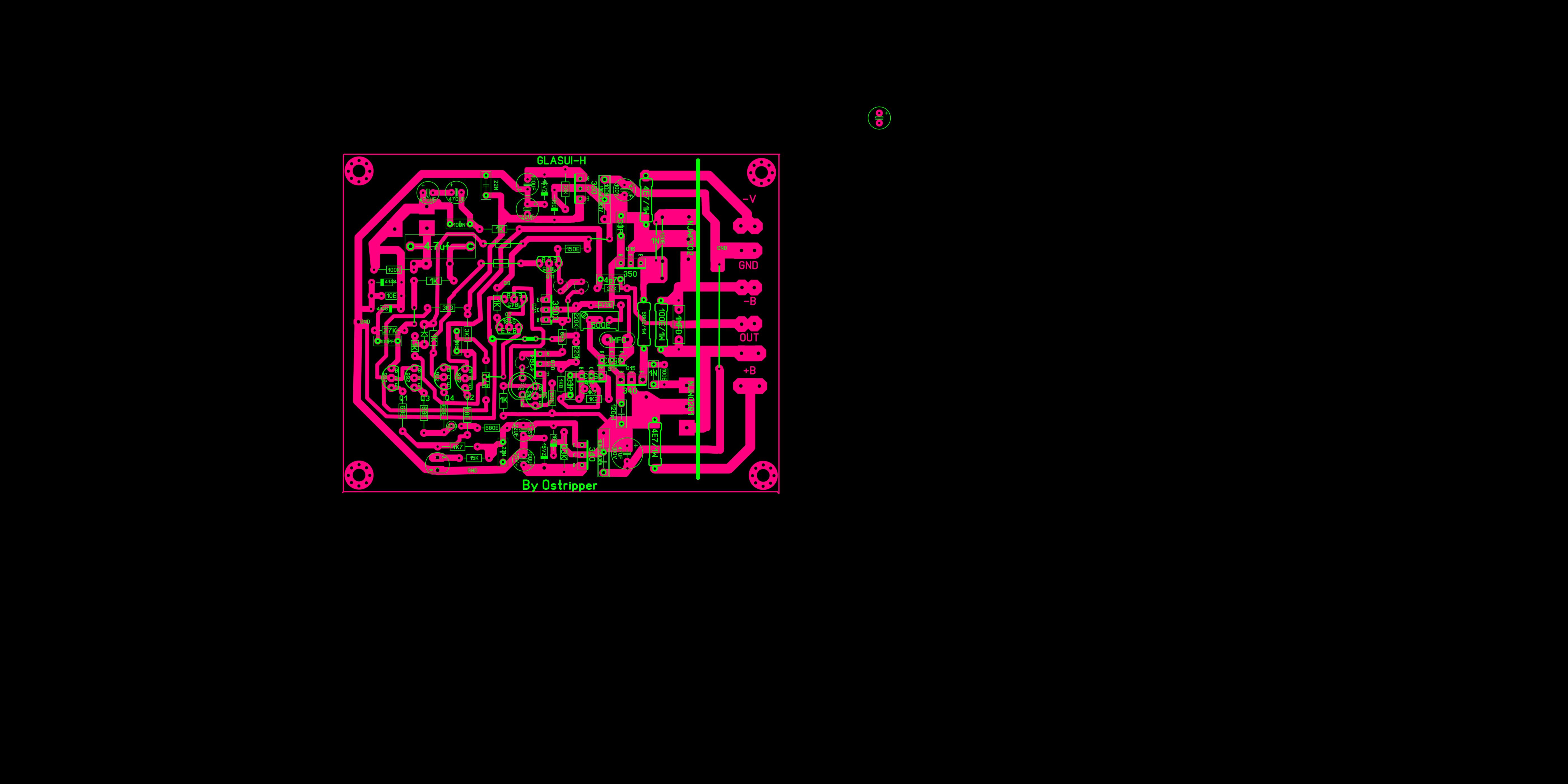

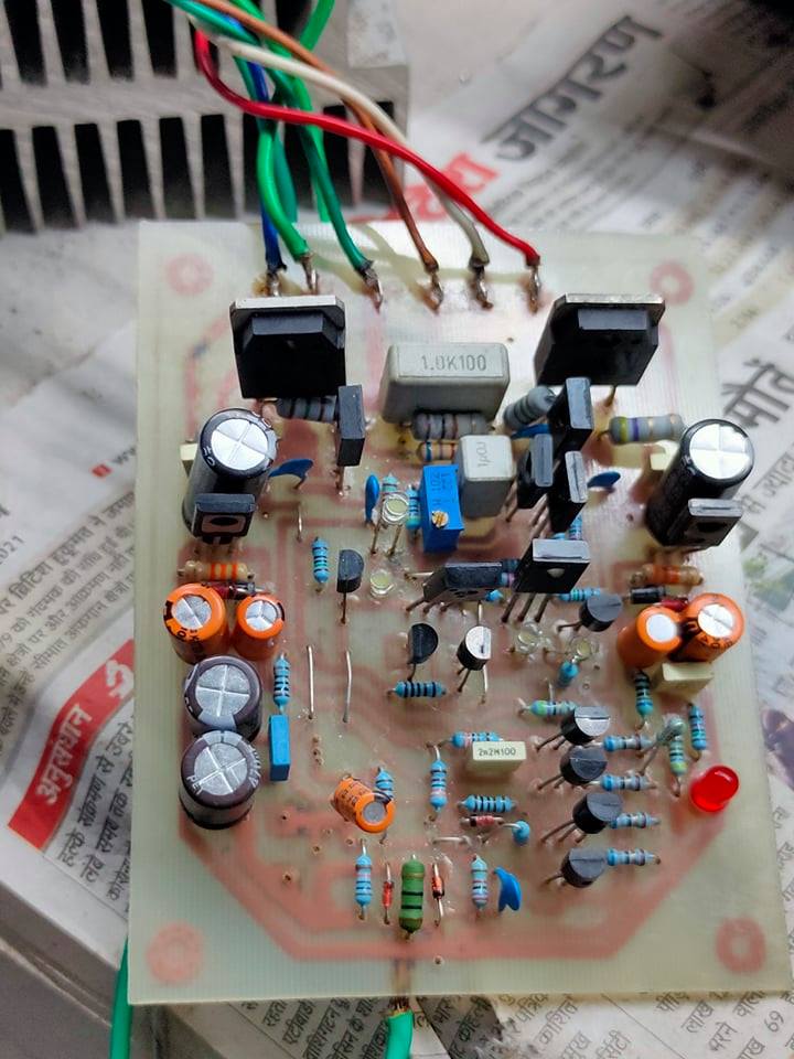

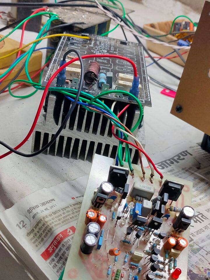

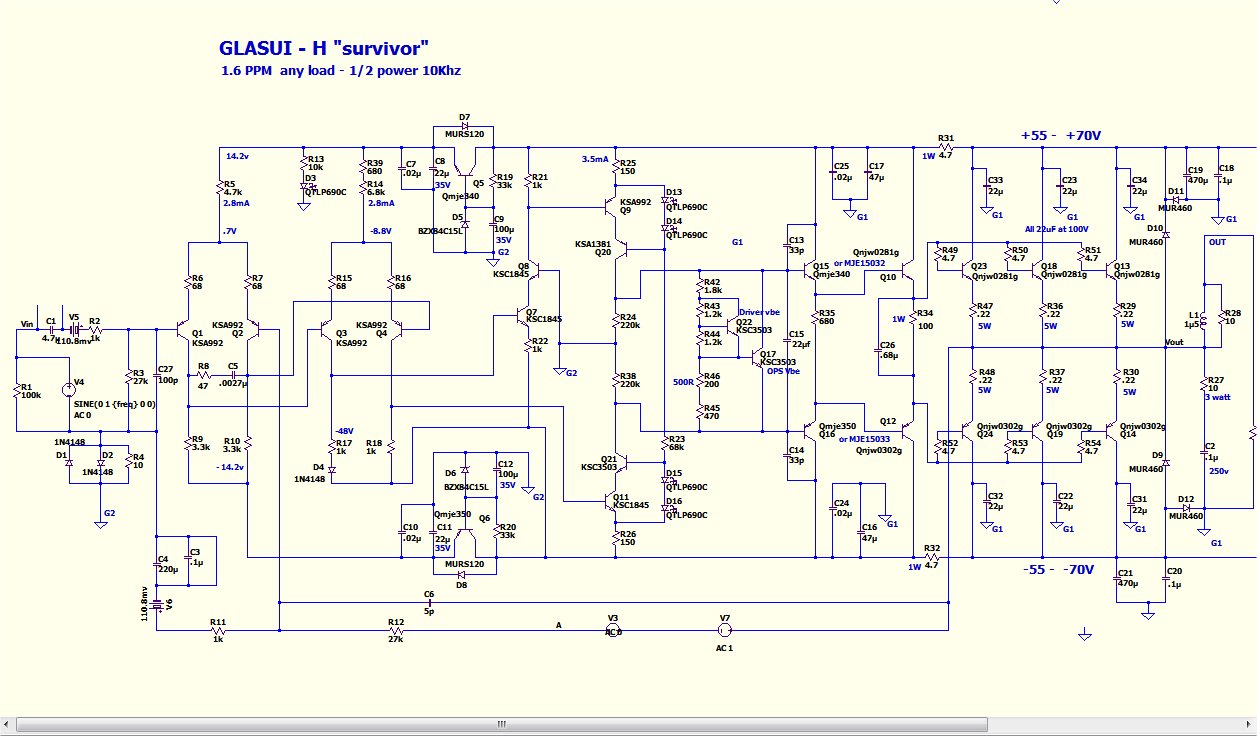

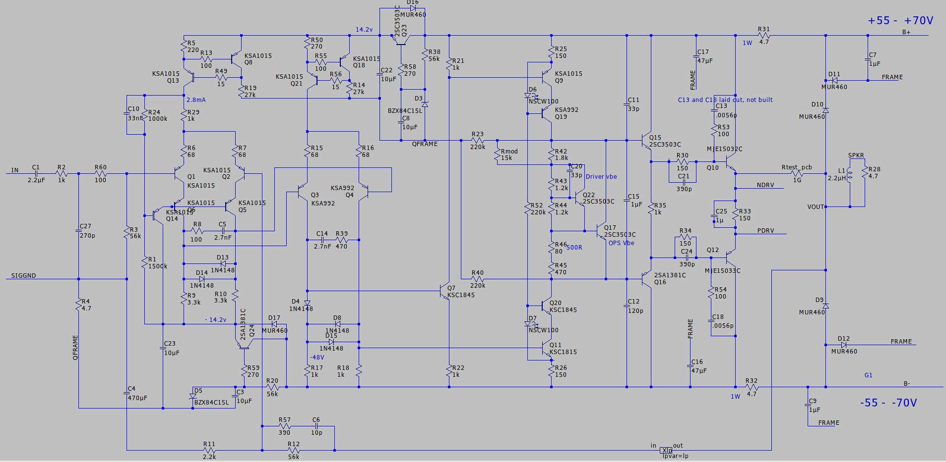

greetings is it possible to help me i have built this driver stage
the bias preset does not work what is the function of C20 33pf
from base to collector on Q22 biasing transistor GLASUI H is
working except for this problem my DC supply rails are +/- 30
DC.
warm regards
Andrew:confused::confused:

Hi Andrew
IIRC there was either some local oscillation on the sim, or more likely convergence issues, and C20 fixed that. So I left it in for the real build. It may not be necessary in the real circuit though.
It's hard to debug over the internet.... so the symptom is a 0 bias current at the outputs? I guess it's time to probe voltages around the bias spreader. Hard to guess what could be wrong. An open circuit near R45 or R46 would do it. If the 22uF cap were installed reversed, it might short out and you'd get no bias. Hard to say.
I hate probing live circuits, even after all these years. If you have a dim bulb tester, that makes it safer. For you and the circuit.
You could also test the driver board by itself without the outputs or ballast resistors connected. Tie one of the driver emitters to the feedback rail to close the feedback loop. There's no load connected for this test. Then you can power it up with some resistors in series with the B+ and B- leads to the driver board. (330's might work, something in that range usually.) If anything shorts when you're probing there's no damage. And you can take your time and relax while finding the faults, you don't have to panic about whether leaving it powered up for too many consecutive seconds is going to smoke something. You could still expect to see the expected bias voltage appear across R34.
But you probably knew that!

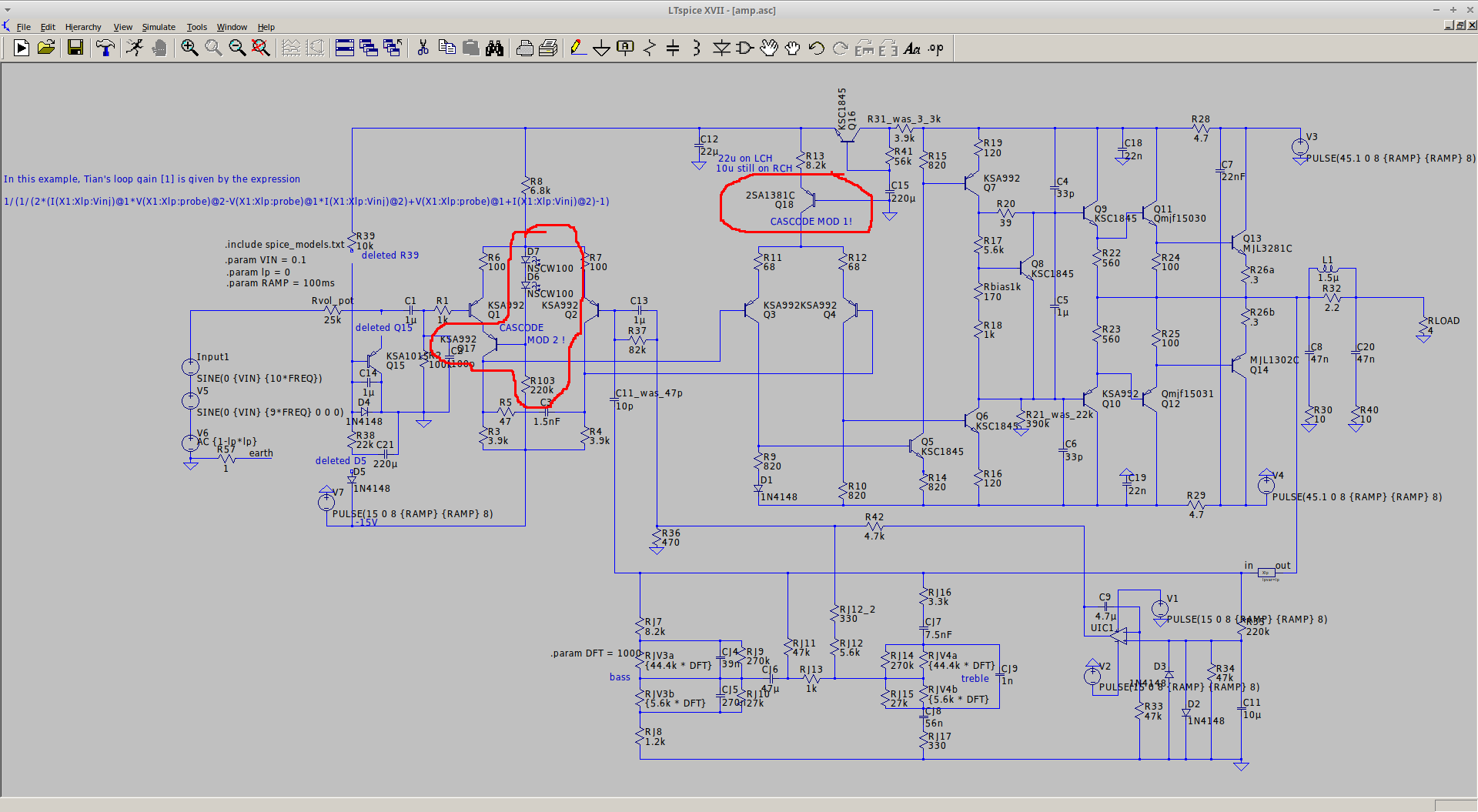

Modifications

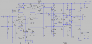

I've attached a spice model of the circuit after the minor mods described here.

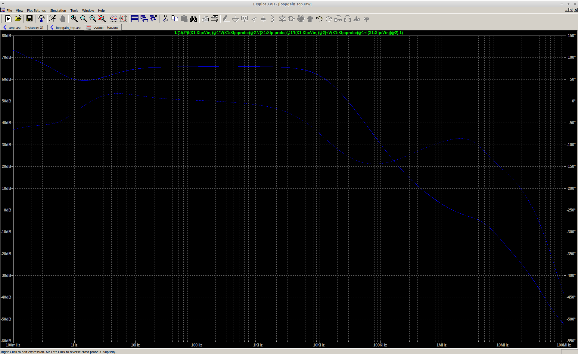

The factory used an enormous 47pF lead cap (C11). This value pushes the ULGF to near 10MHz, and is not ideal for gain margin or phase margin which are both poor. If you only change one thing about your 3900Z / 4900Z / 5900Z, it should be this cap. Values in the 5pF to 10pF range produce ample gain and phase margin without reducing in-band loopgain.
In the factory circuit, the VAS transistors at Q6 and Q7 dissipate around 400mW. But they are TO-92s -- these would run HOT! In fact one of them was dead: Q6 was open in the dead channel. Maybe it failed first from heat, then took out the outputs. Who knows.
To reduce heat dissipation and improve loopgain, you can:
  • replace R11 and R12 with 68 ohms. (This is the emitter degeneration for the 2nd stage.)
  • replace R21 with 390k ohms. (This is the "lag" resistor from VAS output to ground.)
  • replace R13 with 12k ohms. 10k would probably work too. This is the current source for the 2nd stage, and reducing its current reduces the VAS current and reduces power dissipation at Q6 and Q7 to walk it back from the hairy edge of safety.
That also boosts the in-band loopgain from ~42dB to ~55dB at 20kHz. The modded circuit simulates around -97dB distortion floor, falling to around -90dB with the volume pot at worst-case -6dB position where the source impedance is 25k.
It's too bad that Sansui doesn't use a zener to regulate the voltage that Q16 supplies to the front end. This makes the circuit more difficult to model and to modify: changing the amount of current that the front-end draws changes its supply voltage, and vice versa. Small changes in wall AC voltage lead to changes in the frontend supply voltage, lead to changes in the VAS current, lead to changes in the loopgain plot and stability margins. Ewww. But Sansui saved 15 cents.
The Inexplicable
I have no idea what transistor Q15 is supposed to do. It looks like it might have a muting function, but neither simulation nor the real circuit suggests it's needed to reduce power-on or power-off noises.
Q15 hurst distortion performance badly, by 25dB in sim. Spice could be wrong: this transistor is reverse-biased when the amp is playing, in a region that spice may not model well. But it seems like a bad idea to have the high-impedance input node looking into the emitter of a BJT not involved in the signal chain. So I deleted it to ensure it doesn't affect distortion performance, which doesn't seem to cause any trouble.

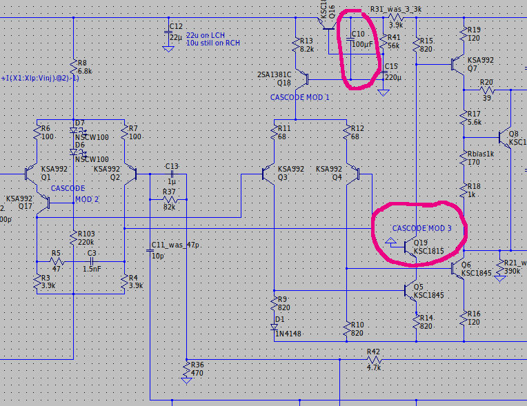

Proper muting fix
The factory amp thumps at turn-on. It happens because Q3 and Q4 turn on quickly, as soon as the B- supply sets up, whereas Q1 and Q2 turn on much more slowly, as the ripple eater sets up. In the interim Q3 and Q4 are "driving" the OPS but there's nobody at the wheel -- no IPS anyway. The result is a pretty good thump before the IPS comes in and controls things.
The fix is simple -- add a transistor to cascode the tail current into Q3 and Q4 so that they don't conduct until the IPS is also conducting. This makes Q3 and Q4 turn on last and turn off first, and that fixes the thump. It doesn't hurt distortion performance at all. See the pic below!
Cascoded IPS
The volume pot is actually 150K, not 50k as I mistakenly stated above. Early-effect induced distortion at the IPS is a dominant source of distortion at higher volume pot settings.
We can fix that with a very simple 3 element cascode, or four elements if (like me) you don't have a 4V zener and have to substitute two LEDs in series instead. See pic below.
It's a bit odd to only cascode one of the IPS pair, but really only Q1 needs it -- Q2 sees only hundreds of ohms of impedance at its base, not enough to cause trouble.
This improves distortion by ~15dB in the worst case and between 6-10dB at more typical volume pot settings.
How Does It Sound?
OK. A bit cleaner than factory. Much better than most 800ppm distortion '70s amps. Not as good as the best amps.
Probably the tone control network in the power amp feedback loop isn't a great idea -- it's exposed to higher voltage levels than you'd find in a discrete preamp tone circuit and so the nonlinearities of polyester caps and carbon resistors are amplified.
Maybe it really needs the cascoded VAS of ostripper's GLASUI and the extra 10+ dB of distortion performance that provides.

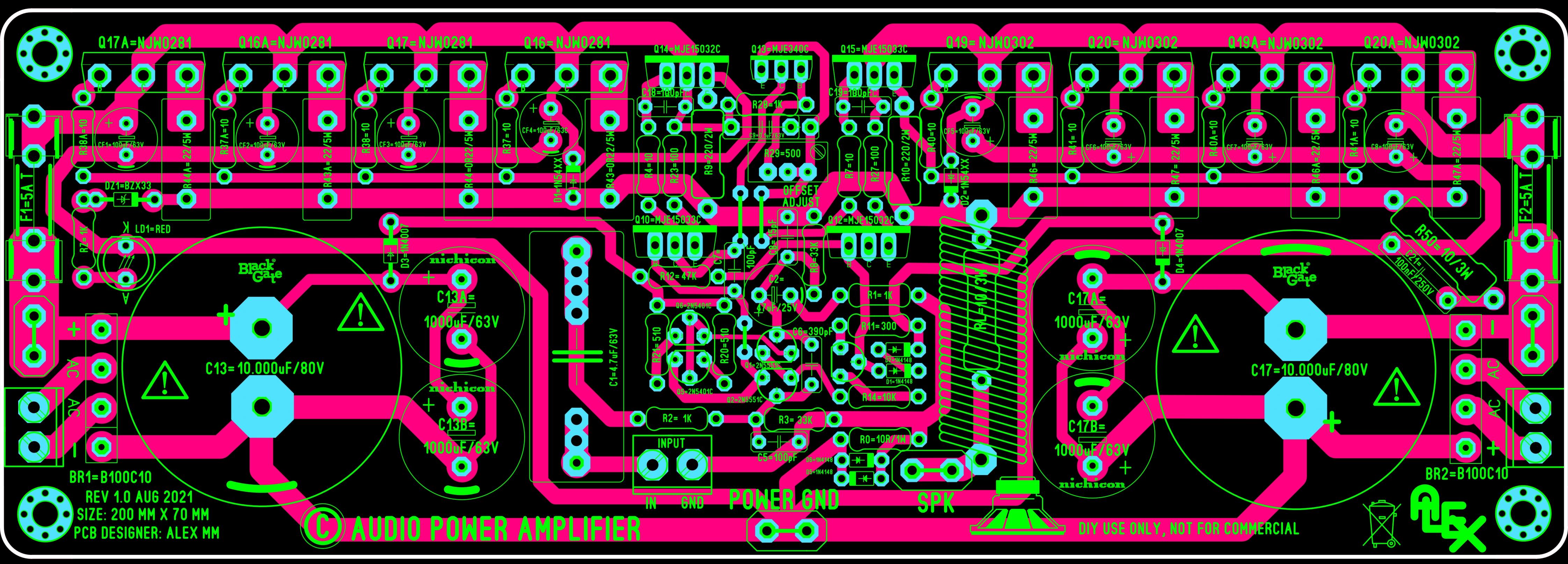

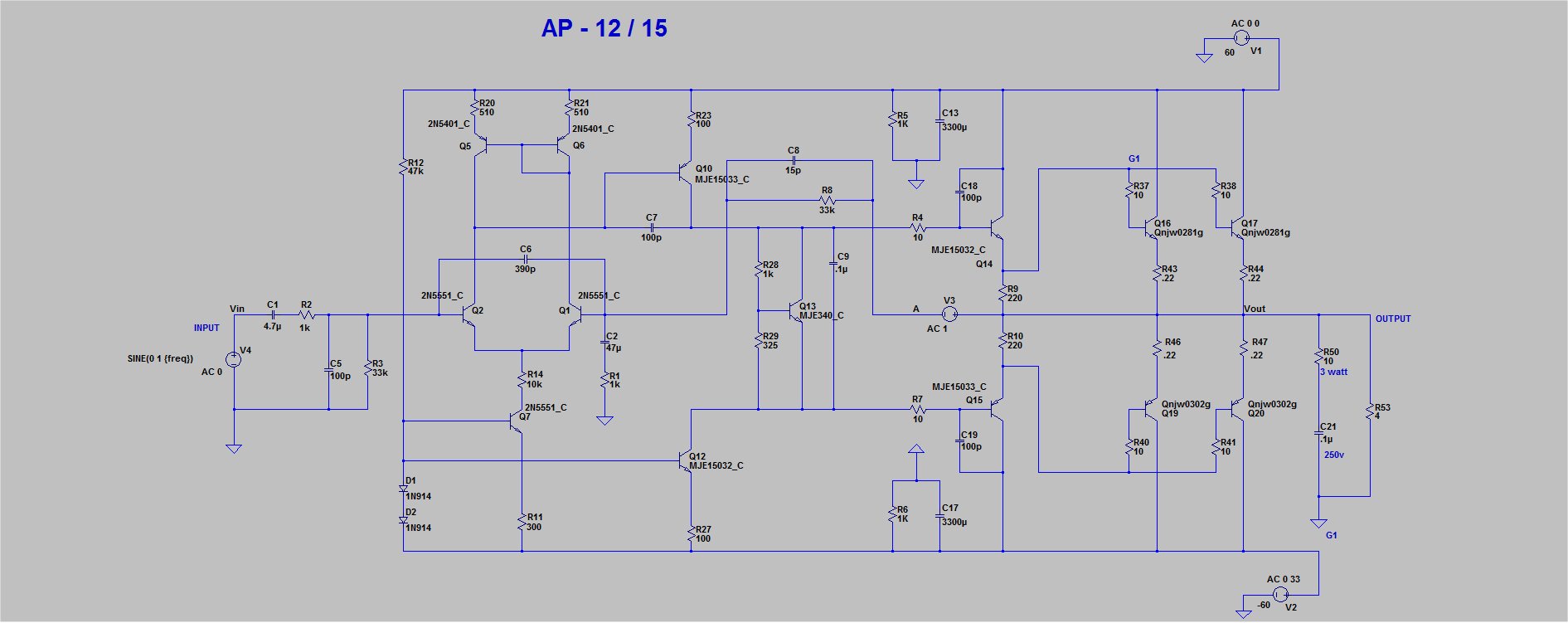

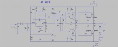

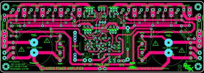

Hello
Hello jpc2001
greetings and many many thanks for your deep explanation
this schematic by ostripper has very deep bass if you ever
get time PLEASE see if it can be modified further if its worthy
of your appoval i will post gerber pcb was dsigned by Maestro
Alex mm.Working schematic just a quick test.
warm regards
Andrew
:confused:
