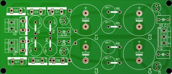

I've attached the board layout for the filter and rectifier, Jumpers are not show but should be self explanatory. The wires will just be soldered onto the traces, not going on top of the board. I paralleled the resistors, the first stage resistors are 2r2 and the second stage is 10ohm.
