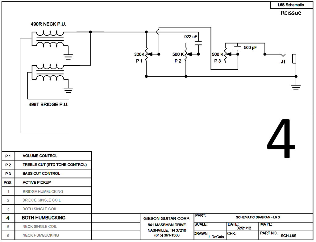

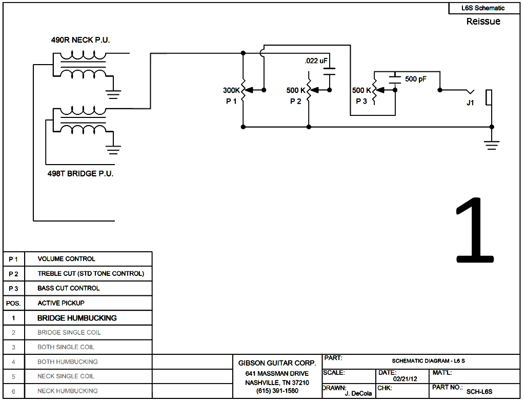

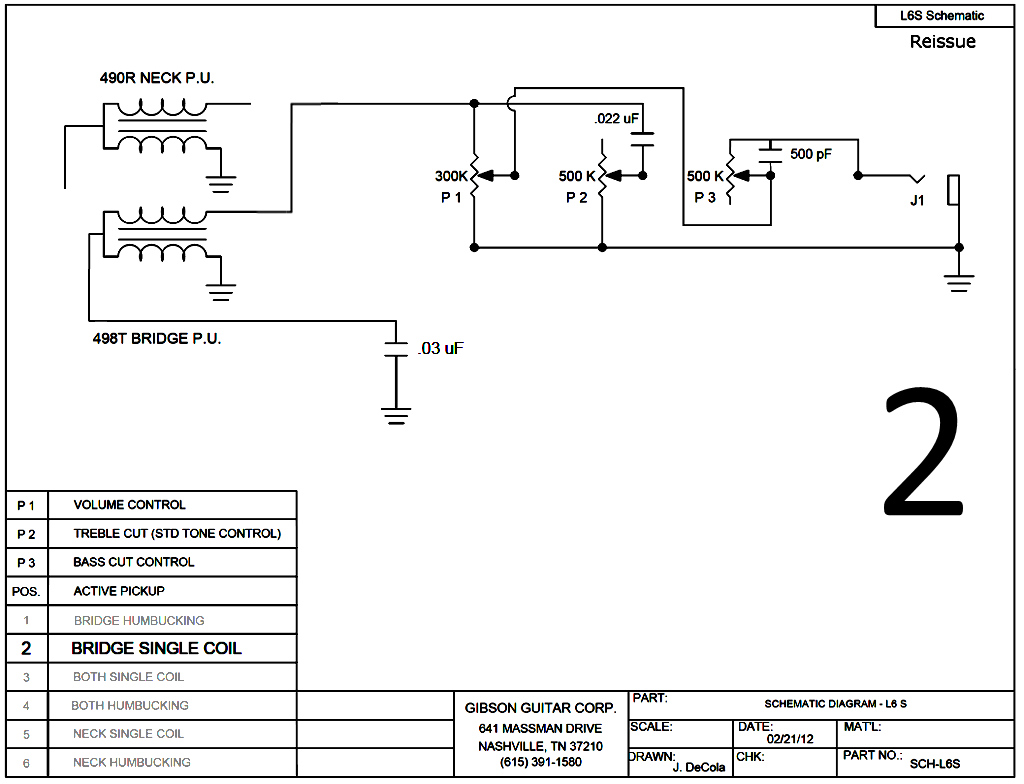

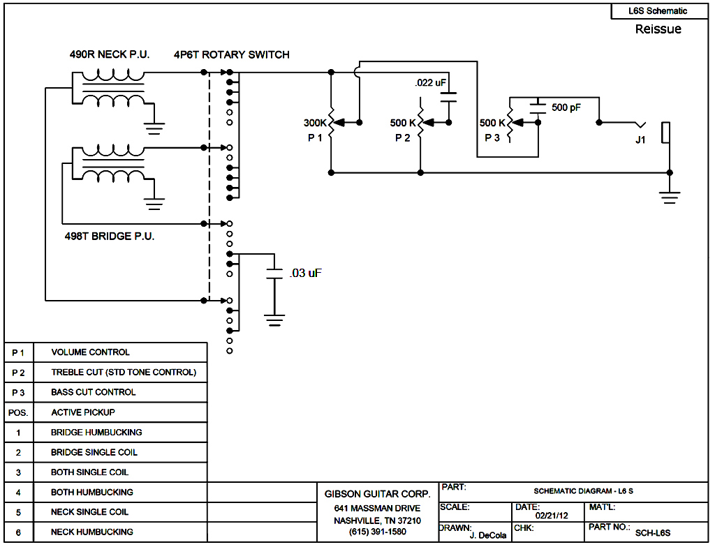

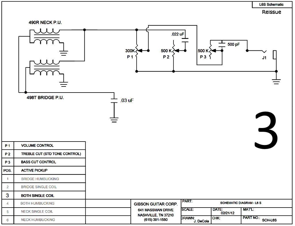

I finally got a schematic for the new one from Gibson. I definitely would prefer the original Bill Lawrence 'mid' tone control with an inductor and ALL the pickup wirings. I need the out of phase settings. The new controls are more "pleasant" but have a lot less variety.
I plan to re-wire it completely. I'll probably eliminate the rotary selector entirely, but keep all its functions.

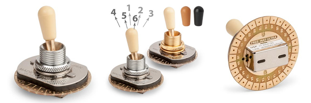

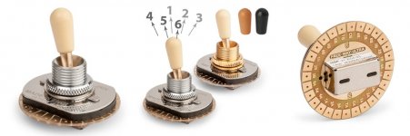

Has anyone tried the Free-way Switch or Free-way Ultra 6-position toggle switch from NSF Controls? I'm curious how the "shift pattern" actually operates. It's two rows of 3 positions. I assume you can go directly from any position to any other; that the toggle bat feels like a 3-position switch horizontally and like a 2-position switch vertically. IMHO that would have MUCH better tactile feedback than the stupid stock rotary switch.
It is a toggle switch with 6 positions: an upper row of three and a lower row of three. I haven't tried one, but it seems just about perfect for what I want. It is not very deep, so it's easy to mount in even a thin-body guitar like an SG. It has some rather complicated combinations of make-before-break versus break-before-make for specific uses.
The wiring examples show that it can be wired to do all the same 6 rotary positions of the original L6-S. The lower row would act like the normal Les Paul or SG switch: bridge, both in parallel, neck. The upper row would have the weird original L6-S configurations: both in series, both in series out of phase, both in parallel out of phase.
It can probably also be wired to do all the same 6 rotary positions of my reissue L6S, with the single-coil positions instead of the series or out of phase ones.
But...it is as convenient as the other L6-S guitars that had a toggle, or a Les Paul.
So, my plan is to rout a new cavity in the backside just like a Les Paul toggle, since both the Les Paul and the L6S are single-cutaway and can have the switch, convenient and visible, instead of a pointless second cutaway (unless you're a lefty). That Free-way ultra will be wired to provide all the settings of the original L6-S and God and Bill Lawrence originally intended. Then all it's missing is the single-coil settings. Those could be most easily implemented as a DPDT push-pull switch on one of the pots, that would short out one winding on each pickup; since the two coils are in series that would just turn one off. Well, not quite "short out"...like Gibson did for the re-issue I would switch a carefully chosen capacitor across, so the treble & midrange is shorted out making it sound like a single-coil, but the bass and 60 HZ is still using both coiils, so it still bucks hum and has better low bass than a real single-coil.
Alternatively, you could have even more flexibility by having a three-position center-off single pole toggle switch for each pickup, so that you can select WHICH coil you are using in single-coil mode. I don't imagine they sound very different when mounted so near each other, but the exact choice of exactly which single coils are used together when two pickups are used will, when both bridge and neck pickups are on, affect whether the two single coils (one in each pickup) will buck hum together. The valid choices of coils for absolute minimum hum are different when the Free-way has the pickups "in phase" versus "out of phase". The independent singel-coil switches for each pickup also lets you use one pickup as a humbucker and the other as single-coil.
Then of course I need to make a new pickguard without the hole for the old rotary.

Has anyone tried the Free-way Switch or Free-way Ultra 6-position toggle switch from NSF Controls? . . .
The lower row would act like the normal Les Paul or SG switch: bridge, both in parallel, neck. The upper row would have the weird original L6-S configurations: both in series, both in series out of phase, both in parallel out of phase. . .
But...it is as convenient as the other L6-S guitars that had a toggle, or a Les Paul. . .

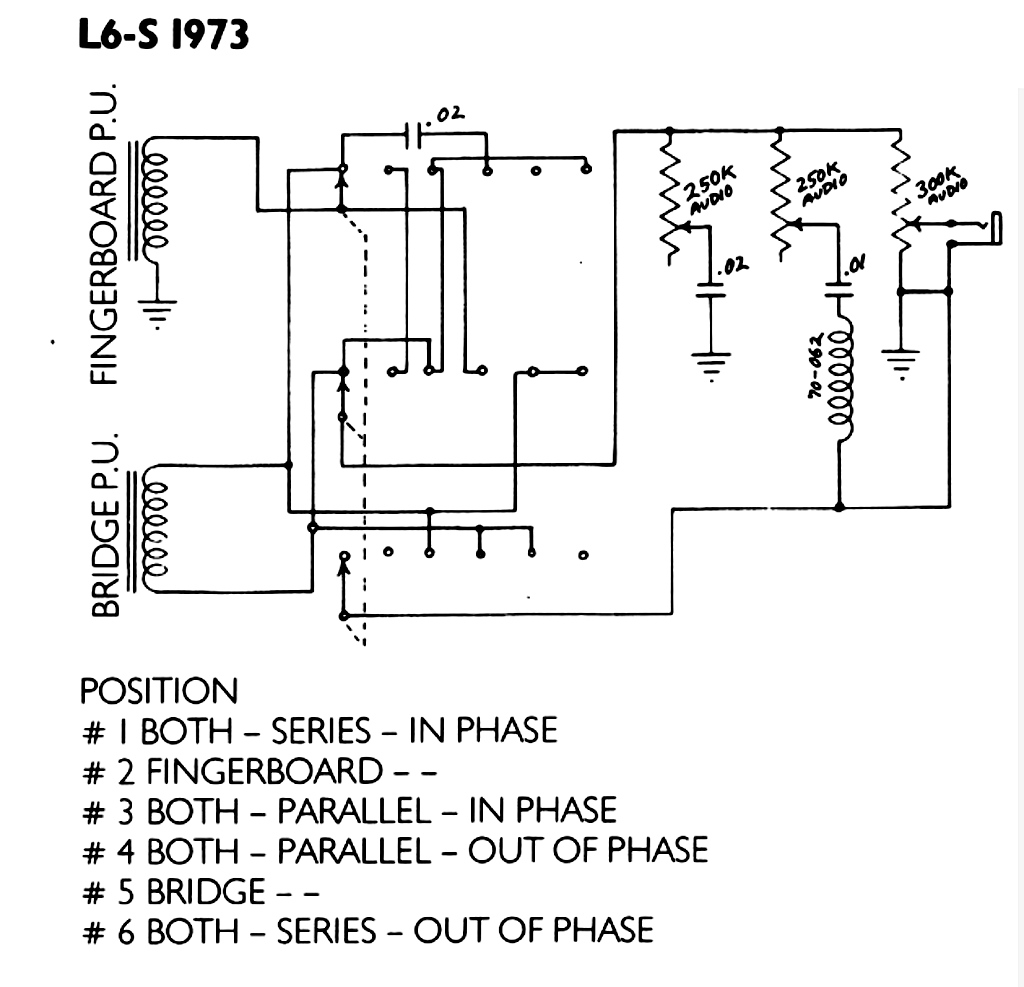

Hi Cyclecamper, Have you made progress with the Free-Way?
Following your post, I have spent some time thinking about these NSF switches. Neither my 75 Deluxe, nor my 77 Custom have been "original equipment" since their DiMarzios were fired up in 1979. Therefore, I see no reason not to add a Free-Way. My Custom will be the first to undergo a "2015 refresh experiment" because the factory 6-way rotary sw has always been a notable weak link with this instrument.
I have no doubt that if the Free-Way SW had existed in 1979, it would have replaced the factory 6-way knob at the same time the pickups were "upgraded." (Today, if asked "why would anyone have taken the original Gibson pickups out," my attitude tends to be "if you are asking the question, you won't understand my answer . . .")
It seems to make the most sense to purchase the Free-Way Ultra, the NSF sw variant that should allow both wiring options to be evaluated: 1) The setup that matches the 1977 factory rotary circuit; and 2) The Reissue circuit to compare desirability of sounds produced with Gibson's newer wiring that, as you documented, came from Gibson with your Reissue L6-S Custom.
My guess is neither setup is likely to be an obvious "loser," so an additional mini-toggle may be involved to create a Mode Selection between the 1977 and the Reissue 6-way sw circuits . . . ?

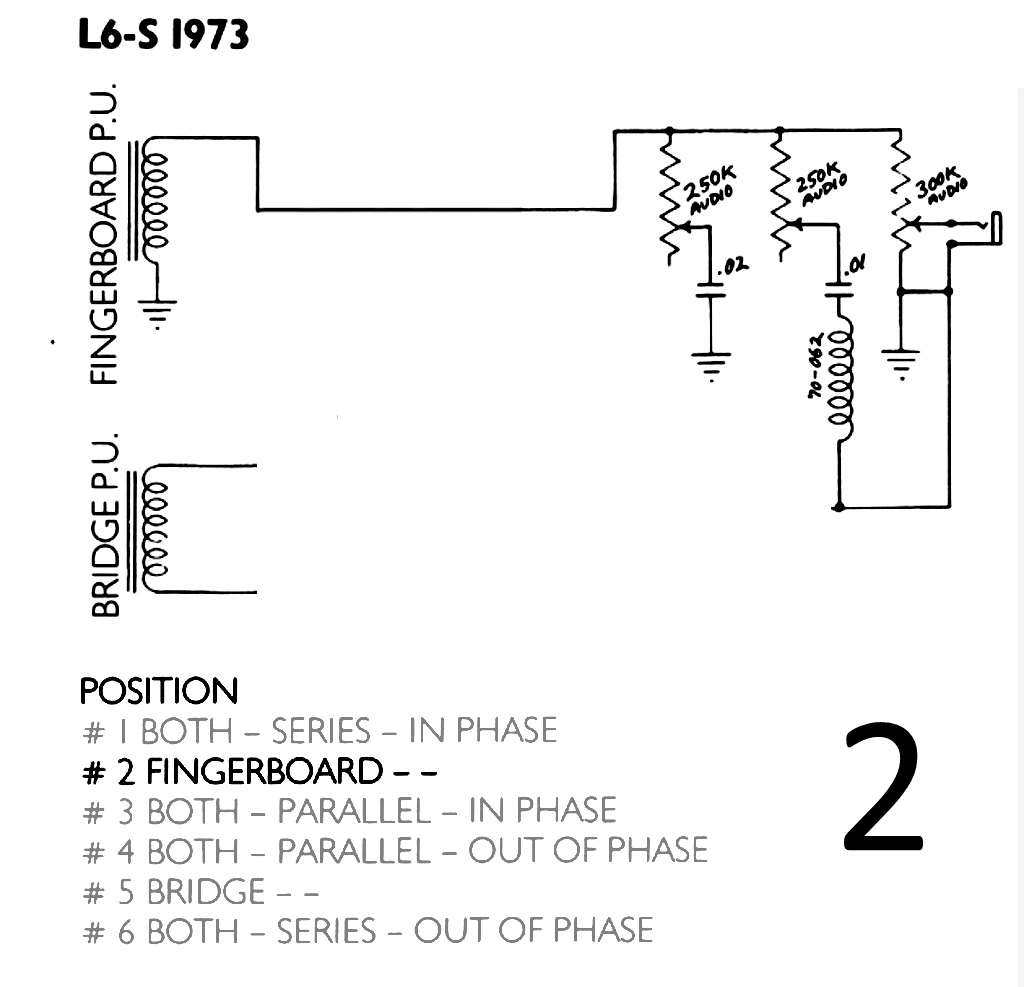

Can you confirm the attached circuit diagram is correct as what you understand was the "vintage?"
My original diagram drawn out in '79 is long lost. You also indicated the factory was not at all inclined to provide you with their reissue circuit, so I am wondering if you are inclined to share a copy of what you eventually received from them?
If successful as expected on the Custom, I plan to follow up on my Deluxe.

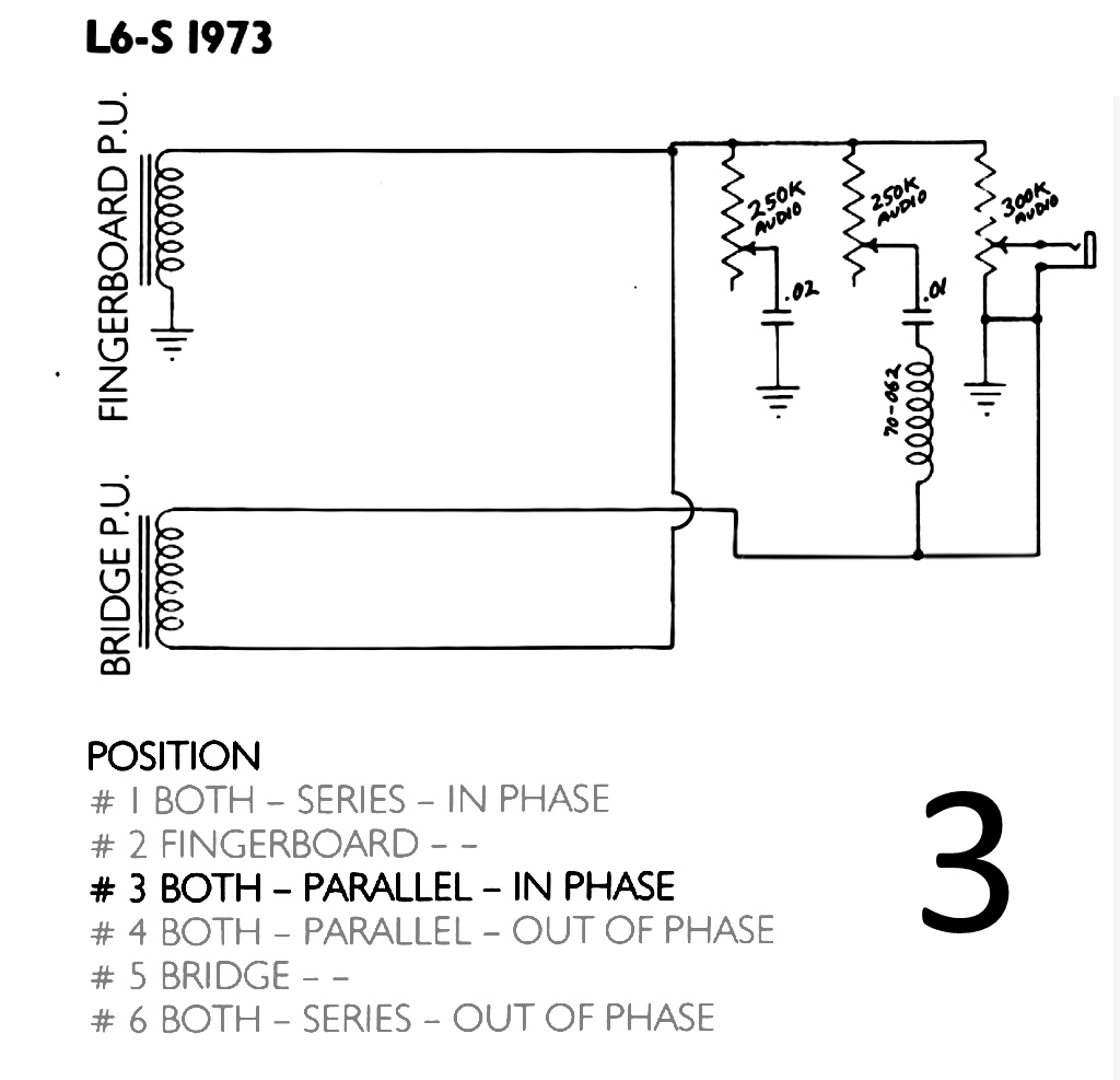

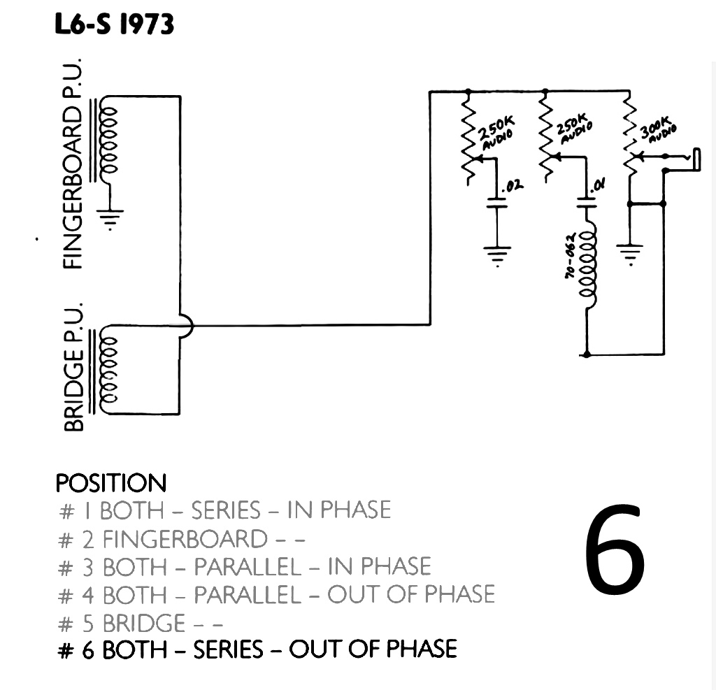

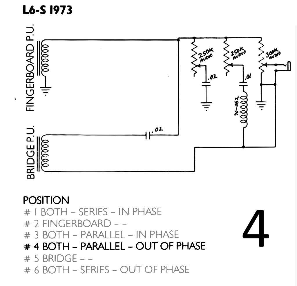

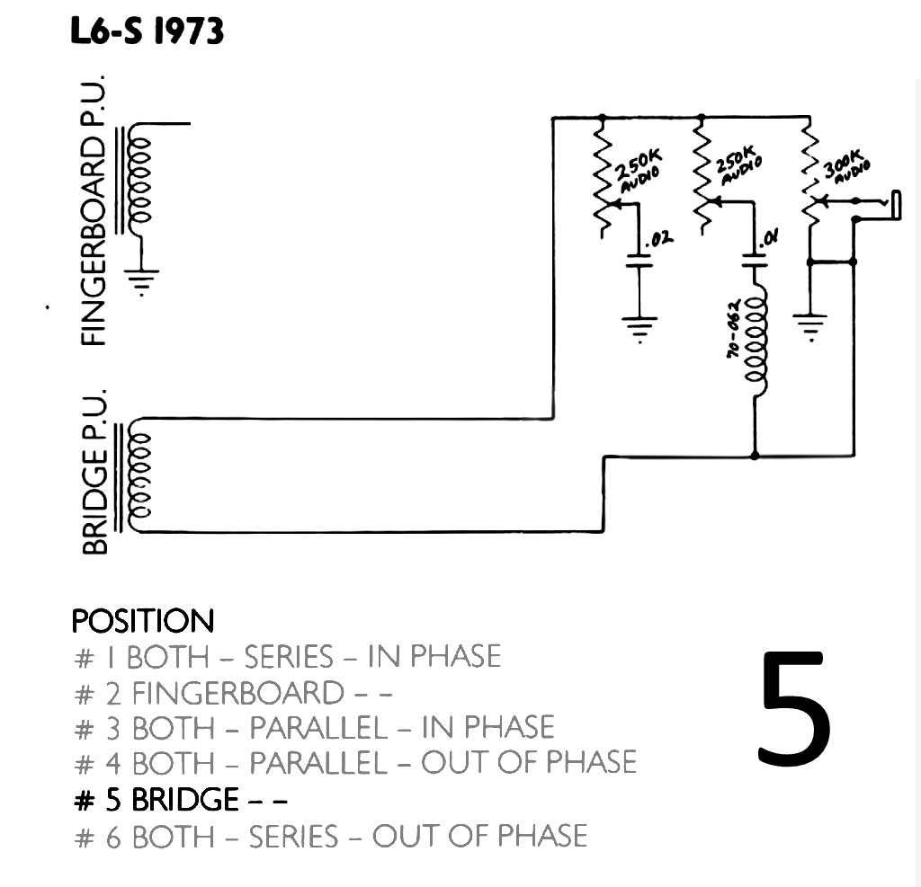

Hi Cyclecamper,
To prep for wiring my first Free-Way Ultra, the 6 attached "diagrams" have been "extracted" from the vintage 6-way switch wiring diagram - simplified to show just the 6 positional circuits.

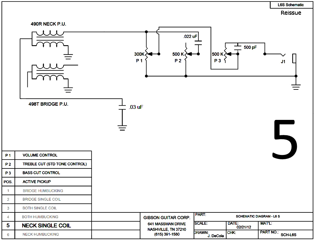

Hi Cyclecamper,
I found the other thread where you posted the Reissue PDF you received from Gibson with their permission. THANKS! Added here are extracted diagrams for each of the 6 positions of the reissue 6-way switch. I think I agree the most sensible way to have it all is wire the Free-Way Ultra to present the Vintage 6 wirings, and add micro switches for the single coil options to add the 3 new Reissue wirings covering all old and new.
