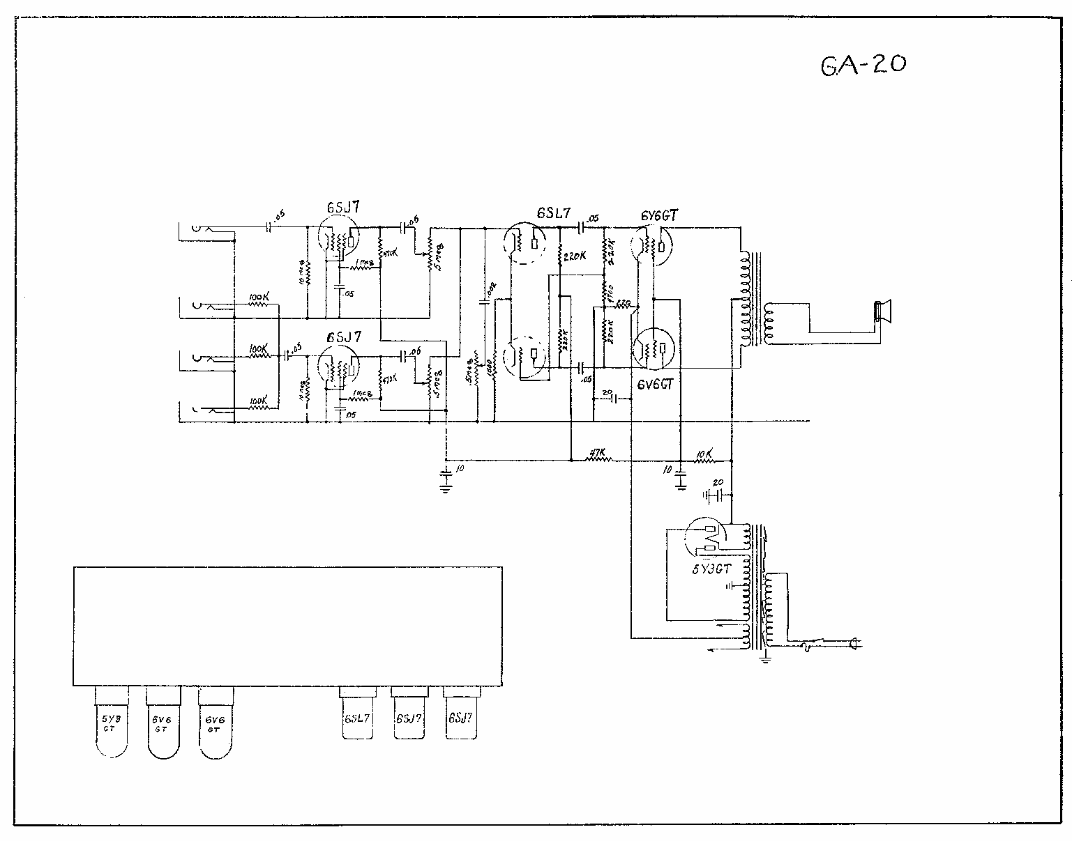

No, changing the resistance will change the bias on the tubes but does not get you more power. If you want louder get a louder speaker. Otherwise you probably need a bigger output transformer and power transformer. Even then the type of circuit may not give you what you want without pretty much gutting the amp and starting new. And it would be a shame to see a piece of history get trashed for not much gain. Again, the biggest gain you can make as far as making a louder amp is to change the speaker. Doubling the power of the amp only gives you an extra 3 dB, which is like running your stereo and then once channel stops. Not a huge difference.

i want to be louder because i can HEAR that the 6V6 tubes are NOT doing any real work as the amp is set up now - and i just really have a wish to hear how MY BABY sounds when pressed to the max. - i do NOT want to hear the distortion from the preamp and splitter.
i want to hear the overdrive from the power tubes only!!
i want these little 6V6 #uckers to do twice as much work as they are at the moment

And I will repeat again, how do you know the amp is doing what it should? Ar all the parts in spec? The tubes all good? I gave an example of what it could do in the Youtube vid. Can your amp doing what that amp did? If not you may need more signal into the amp. It should get the output tubes into clipping.
There is no magic swap of a part or two to get more gain out of the amp. The 6SL7 has a 220k resistor on the plate,no increasing that. The 6SJ7 has the gain pushed as much as it can, If you dime the volume you should get enough signal to the output tubes. Whether it is enough for you there does not look to be an easy way to get more given what you have. Without you (and us) knowing what is going on inside your amp health wise I do not think there is much more we can offer. Maybe make a chart of the tube pins and the voltages on them as well as the voltages of the power supply capacitors. Maybe we could see something that is amiss.

So the objective is less preamp distortion and more power stage saturation.
What about raising the voltage on the 6SL7 by paralleling the 47k in its power supply with another 47k or less, depending on the desired voltage? You may want to put a larger filter cap as well.
The driver will have some more headroom and output swing this way.

As others have noted, then you need to drive them harder. Crack that whip and hit the grids with at least 40VPP!
If I remember my gospel-according-to-Tubelab-George correctly, the 6V6 is limited by it's low cathode emission.
So you also probably want to increase the screen current (much easier than trying to increase B+) to get those bottles hitting Ip(max)
