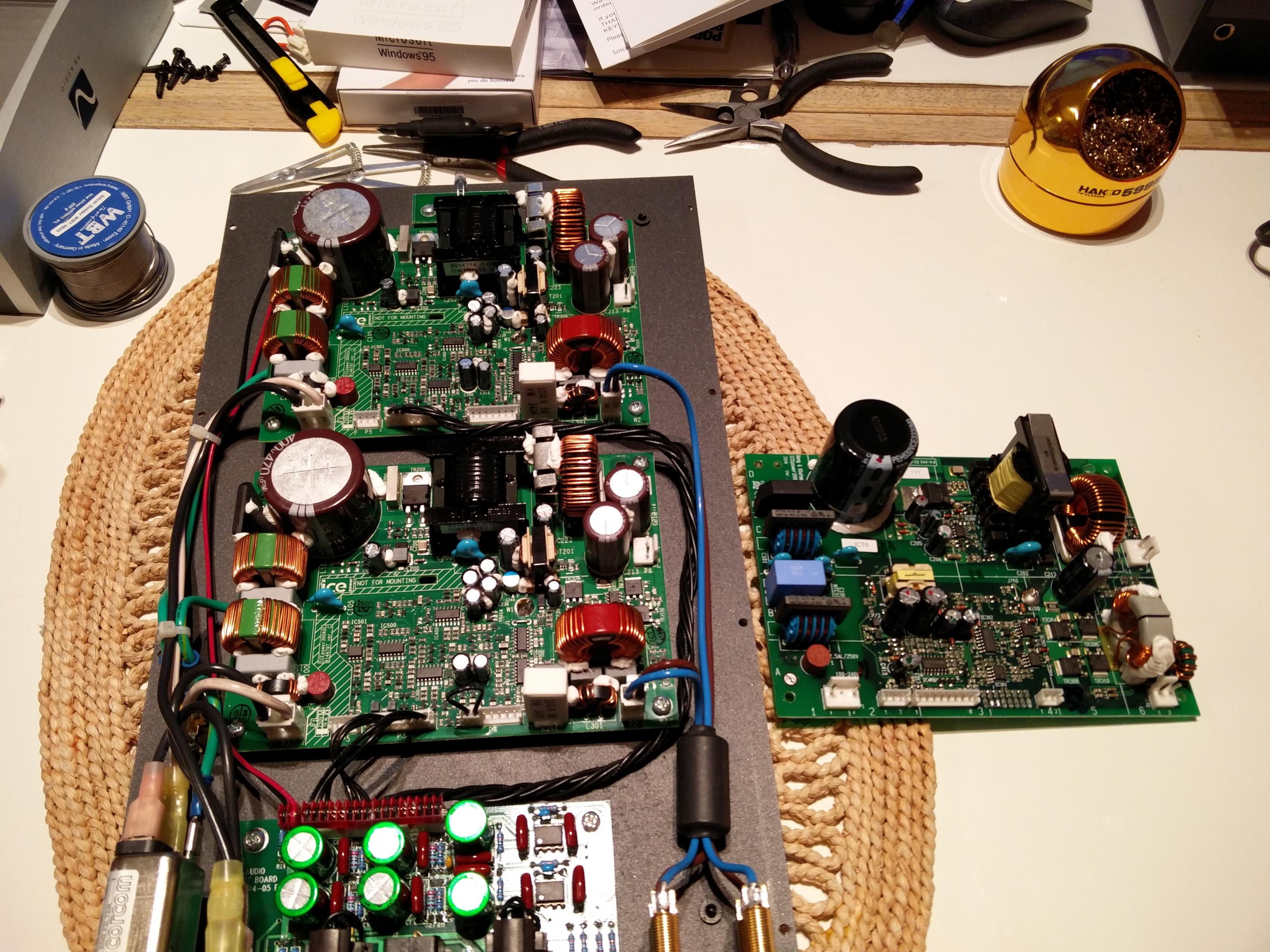

Today, I set about my other Icepower project which was to upgrade the 200asc modules in my PSAudio Trio-A100 amp to to newer and 50% more power 300asc modules. This was insanely easy and required exactly two de-solder/solder points for chassis ground wires in the middle of the Icepower modules. I've got them hooked up to my LS50s and they sound just as good as my Ghent Icepower project. I think this is a high value upgrade to my existing Trio A-100 amp.
The attached picture shows the upgrade amp on the left with one of the original 200asc modules on the right.
-CB

Somewhere I did read that the voltage gain on the ASP modules was a little higher. I think the standard is 28 dB but the ASP's do 30.
Best,
Erik
Read the datasheet All the ASP-modules have 27 dB nominal gain (which is fairly standard).
/U.
/U.
I think I was possibly referring to a review of a Jeff Rowland unit that used them. JR uses a custom input buffer of some sort so the gain is not stock. << shrug>>

Nice PSaudio A100 upgrade!
See this post:
http://www.diyaudio.com/forums/class-d/281583-cullen-modified-psaudio-trio-c-100-amplifier-overview-part1.html#post4701672
